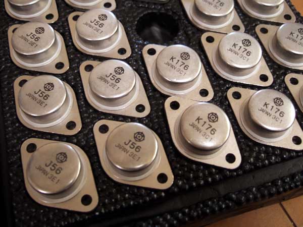

Got these 2SK176/2SJ56 transistors from a electronic store in China, I'm wondering if someone can comment whether they look real or fake.
From looking at the printing i think they look suspect.
Compare to more real looking devices:
Thanks, are they looking too new and shiny?
Your comments are important for me, as I'm actually considering stocking a few more pairs from the same source, after the measurements seem quite positive.

I thought the 6 on the two types doesnt look the same. But since these are regular old Lateral FETs, why not just get the modern equivalents? Either BUZ901/BUZ906, EC10N20/EC10P20 or what i used in my Fetzilla, Renesas SJ162/SK1058?
More easily bought from a trusted supplier and thus 100% guaranteed genuine.
You could always get a set of the Renesas and compare the sound versus your (presumably) Hitachi parts.
Good luck and please keep us posted with any further findings.
