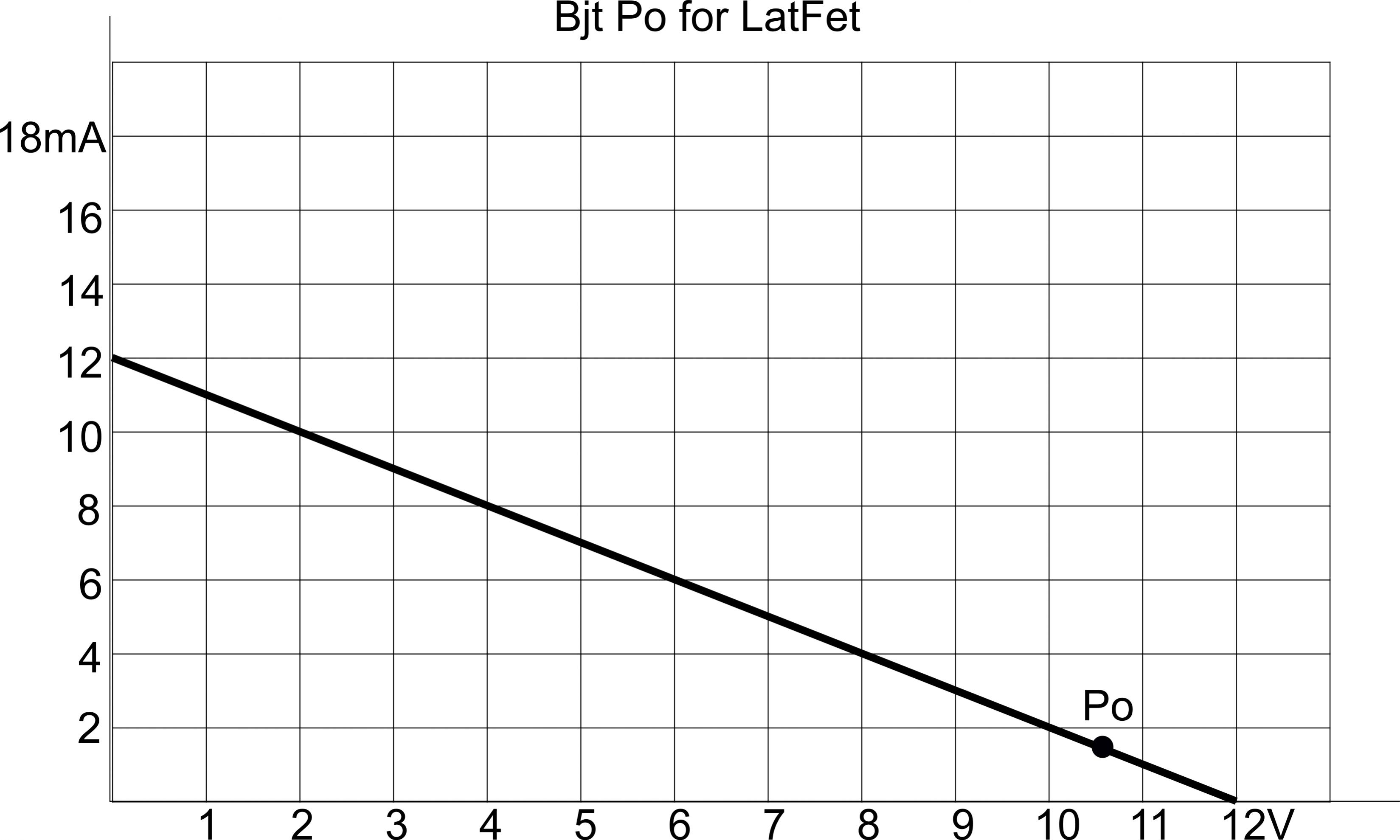

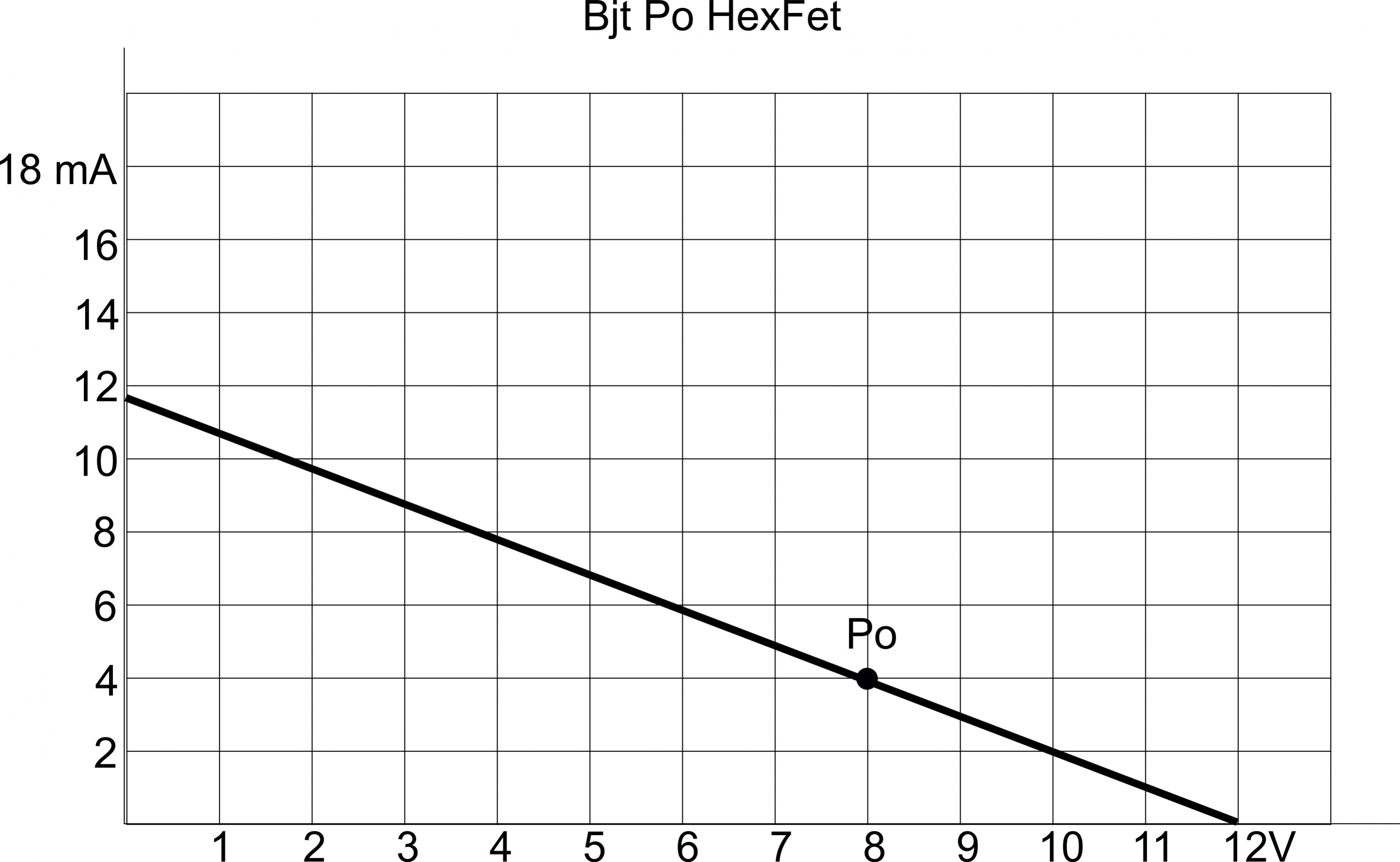

Probably like you Eric, I also prefer Lateral mosfets for output device. However here, in Pass section, vertical mosfet is the norm. We learned to use thermal compensation and source degeneration resistor for thermal stability. But Mos57 "controversial" circuit use none.
To me, this less traveled territory is interesting because it may open the door to a simpler mini F5 topology free of both thermal compensation and source degeneration. I was just trying to determine the boundary. Most likely is that your requirements of 24 V (or +12V and -12V) and 5-10 watts lie within the safe zone.
If a safe boundary condition is found, you can replace the laterals on Juma's circuit with IRFs with minor R3 and R5 adjustment for a different sonic experience.

I calculate Vgs on #8 to be about 1.1V and Id at less than 0.4A, for a latfet with with 0.15V Vgsth. Juma modified R3 & R5 to 1K to give 0.7A Id at #30. Any particular point you want to make? I am ordering parts to try your circuit. It truly is interesting, but I don't think I can use the 540N and 9540N that I have. It's all right if you are reluctant to repost. We went OT for too long allready.

Good choice
I'm sorry, I did not realize that it had been resubmitted in post 30.
In it appears that the Vgs voltage is 1.4 V.
Now, allow me to defend my "controversial" circuit .
In particular, I want to explain why I replaced the latfet with hexfet . As I mentioned, it was a necessary choice to improve the overall performance, in particular the spectrum of harmonic distortion .
The motivation is precisely due to the low value of the Vgs voltage for latfet.
This last is also the Po point work of the input transistors . So, in case of latfet , this point is almost at the edge of the load line of BJT , in an area just at the limit of linearity and class B.
With the employ of Hexfet that requires 4 or more volts for the same output current , the input transistors work in a more central area , so more linear and moreover, in class A.
In addition, in my opinion, it makes more sense that out stage work in class A when it is driven by another class A stage, but much less sense if it is instead driven by a class B or AB . I enclose the drawings of the load line and the working point in the two situations . Imagine superimpose them the output characteristics of the transistor and the result is under your eyes.
