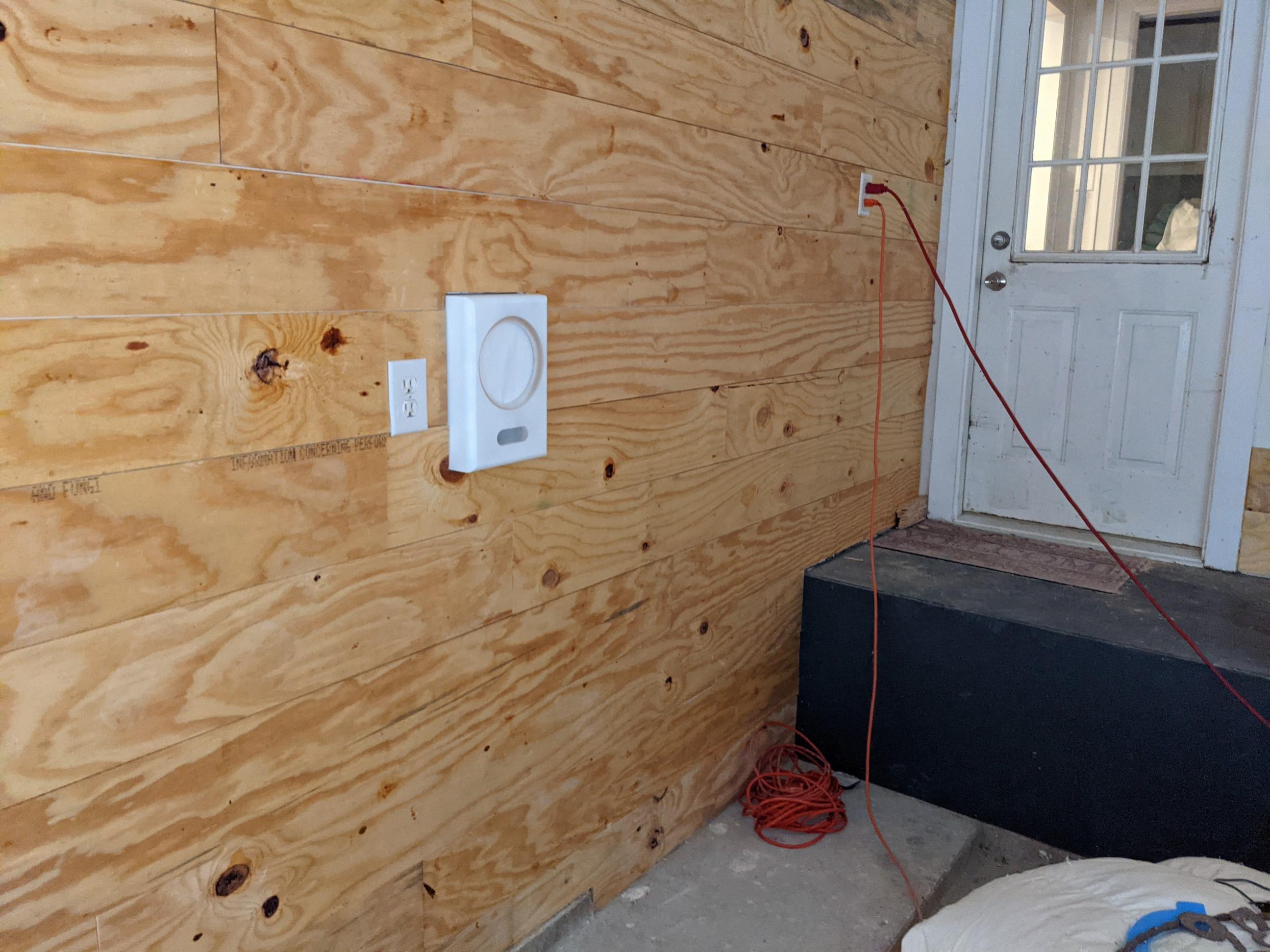

How have you got on with the crimping?
Crimping is on pause. I closed up the boxes to paint them. I am still building out my garage and have yet to get to the paint phase. I plan to paint them the same color as the walls (medium gray). I am going for a farmhouse style media room.
I do not want to open them up before the cabinets are finished because it may be hard to get them sealed up again. I sealed them from the inside before I attached the baffles.
I also need to have someone over to polish the concrete floor before I paint the walls. So probably a few weeks before I can get to it.
I may try some practice crimps this weekend.
