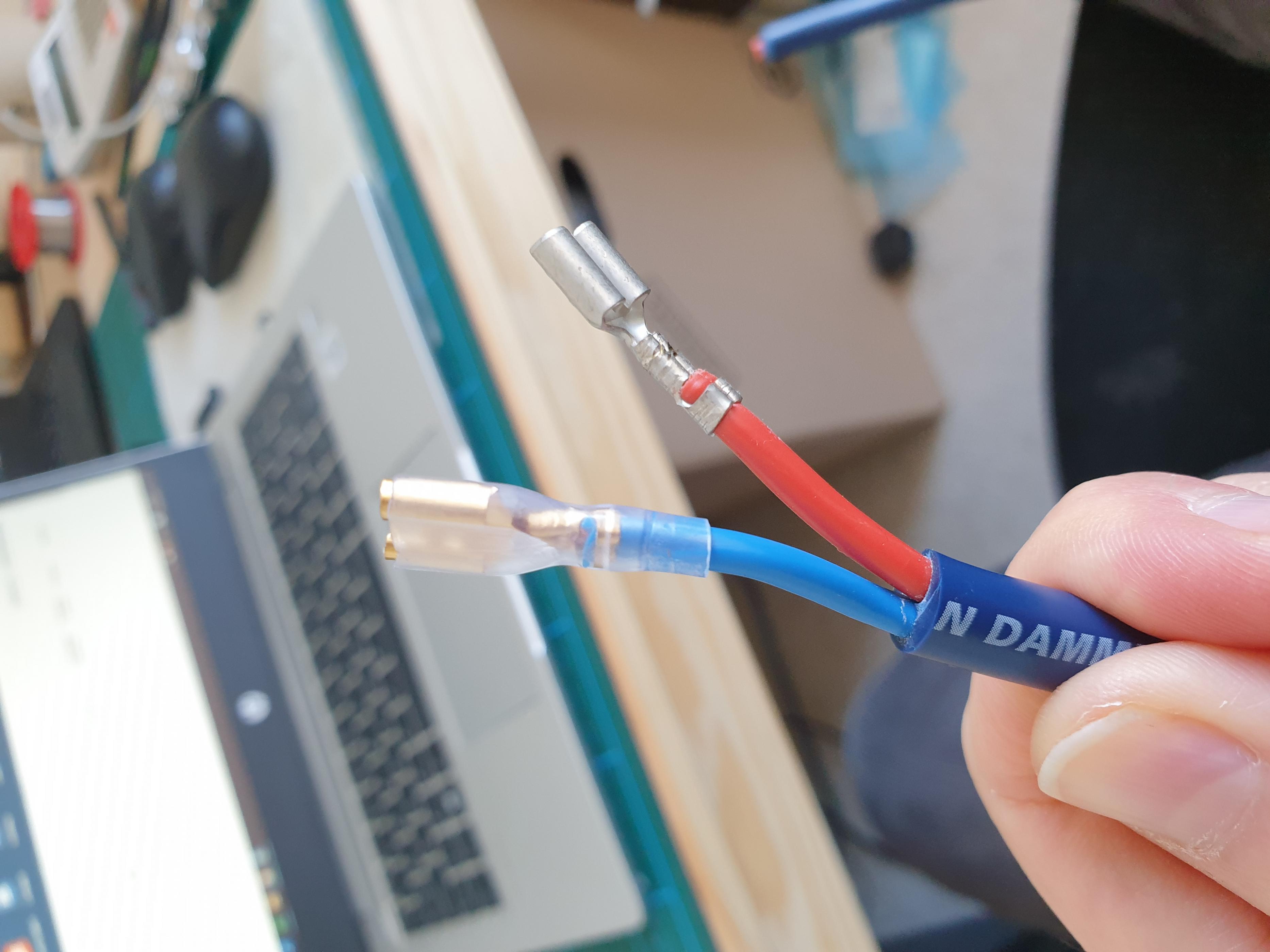

I think these were the first crimps I made with the Preciva I recommended. On the left (blue) is the cheap connector that come with the kit and on the right are branded JST connectors. In both cases the strain relief as crimped very well. Sorry I don't have a more detailed photo.
