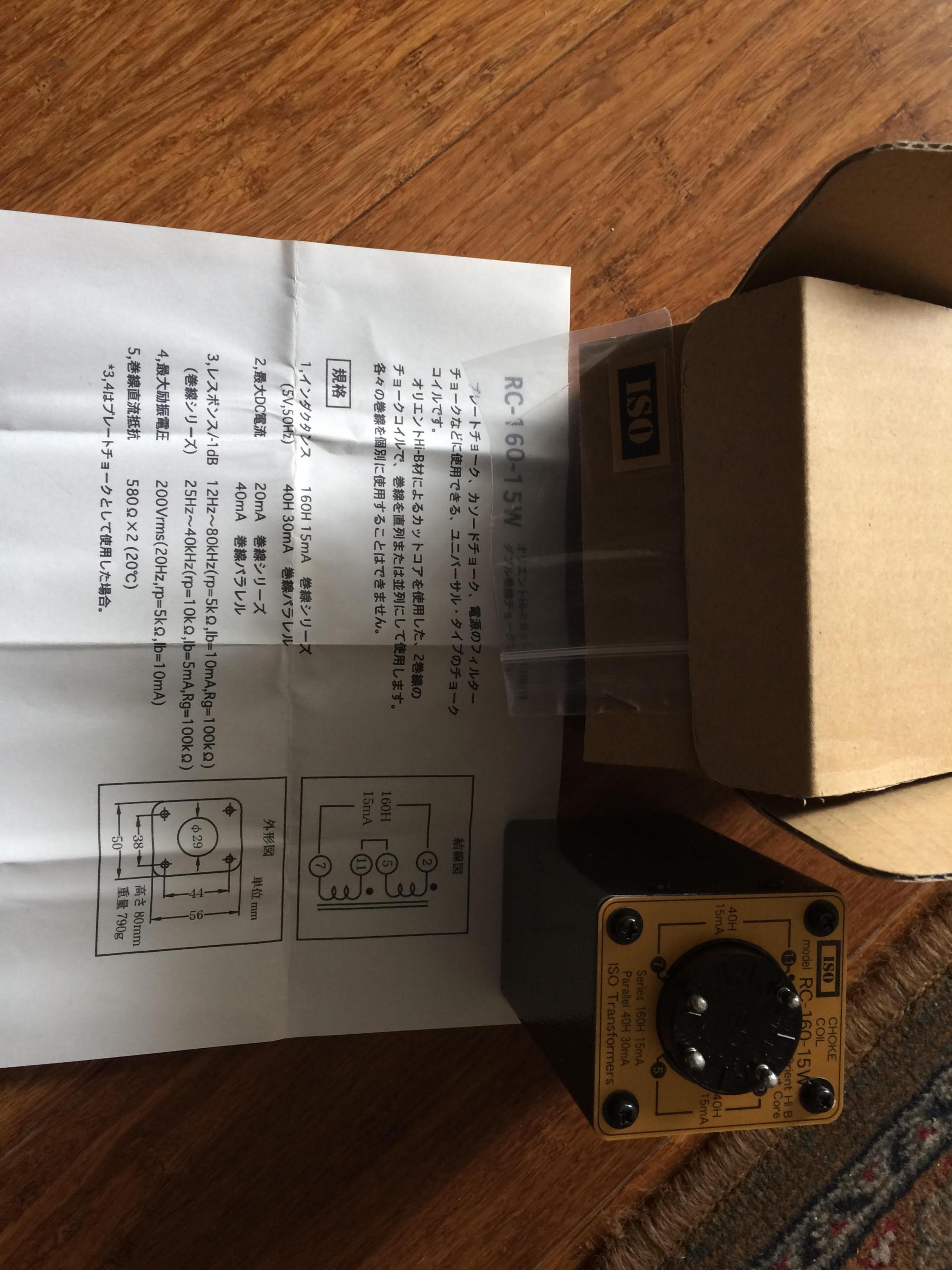

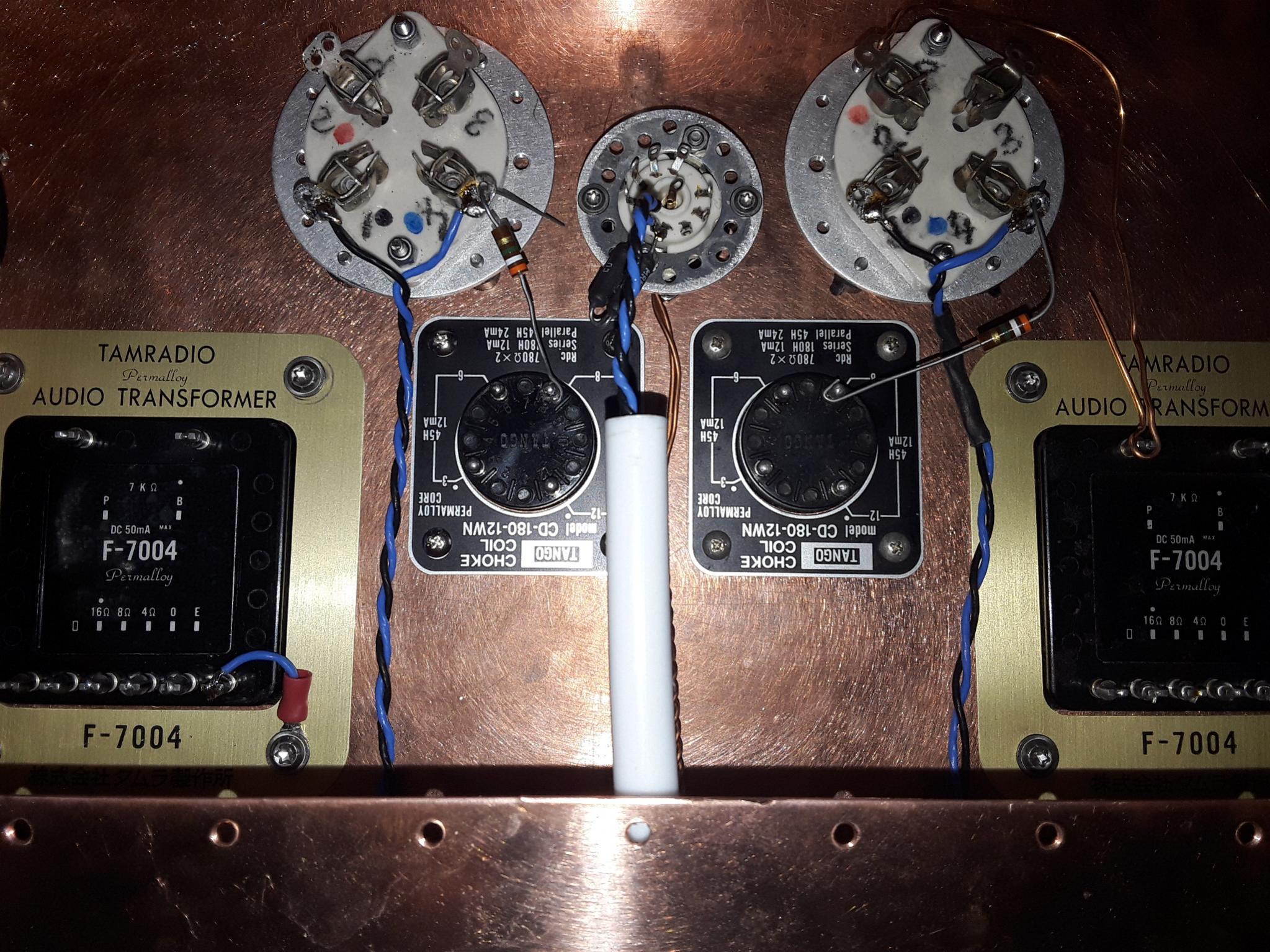

I am using Tango plate choke because i bought them long time ago when they were affordable in Japan. It is used for a direct couples e80cc/6085 plus VT25A power amp which will be used full range for some time and later it will be used with a passive 12db/600 hertz filter at its input. So now wired with the two windings in series later maybe in parallel if rewiring van be done without deconstructing to much.
If i would have to buy a choke at this moment i would go for the Vietnamese one that Andy is using. I know that the Vietnamese love to use Tango and Tamura if they can affiord it and they care about quality.
I think the better chokes also will allow you to position the choke closer to the tube so i would go for the covered ones. Lundahl chokes can be put close to the circuit because of their constructing. I did the well know test with an ac meter across the choke and placing the choke close to a power transformer. I am using Lundhal chokes in lot of my power supplies even some with 1A . I would load the supply with a big resistor and move a 100 henry 25 mA Lundahl plate choke close to the input choke which are famous for their disturbing behaviour. The more the Henry the more it will pick up. No problem at all. Mounted closely to the transformer and in all angles readings would very low. One reading was a little better but forgot which one. I can imagine for a plate choke this tecnique can give an improvement. Usually the better the choke the less the less the differences will be. Also did check with a normal EI choke 100H 30 mA. There the best orientation would be 3 times worse than the worst orientation with the Lundahl.
