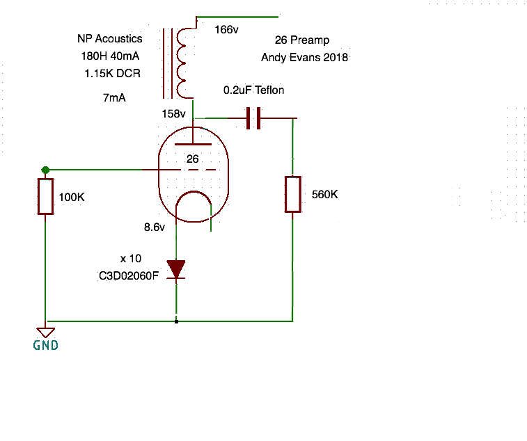

It's interesting to see where my plate choke experiments with the 26 started 8 years go. I'm now using NP Acoustics amorphous plate chokes which are the best I've tried so far. There are two available -
- 180H, 40mA, 1.15K DCR these are quite large, around 70x70x60mm
- 136H, 15mA, 2.1K DCR which are 50x50x40mm
The smaller one works well and is a slightly sweeter sound, the larger one is more detailed and would be my choice, though it's close. From the website it looks like they are both $120 each which is good value for amorphous cores. Shipping from Vietnam on top. The winder, Phuong Nguyen, is a very nice man and good to deal with, though he doesn't speak English. I think he uses an online translator for questions and communication, but that seems to work and I've had no problem getting the parts shipped. The specifications on the website seem different from the ones he gave me in messages, listed above.

Here's what I'm using now - I like the SIC diode bias. Running the 26 at 7mA seems to be OK for me, though I wouldn't go beyond that.

Good question! If my memory is correct over 8 years, the following. All were used with FT-2 teflon coupling caps
- 2 x 156C in series. These were OK but not much more, and were prone to hum. Need to be shielded in some way really.
- Primary of LL1660. This was again OK, and with a teflon cap as good as using it as an interstage in 1:1
- No-name Asian plate choke, 50H and probably 30mA. This was better than the above and pretty good in fact. It suited the 4P1L nicely.
- 2 x 126C in series. These were really good, giving high inductance and 15mA current. Much better than a single one and also better than using the 126C as an interstage. A real contender
- Small NP Acoustics choke. This is amorphous and better than all the above, though 2 x 126C were close.
- Large NP Acoustics choke. This was marginally better than the smaller one and the best sound overall.
The last four options I would consider to be good solutions and better than the LL1660 in 1:1 as an interstage.
