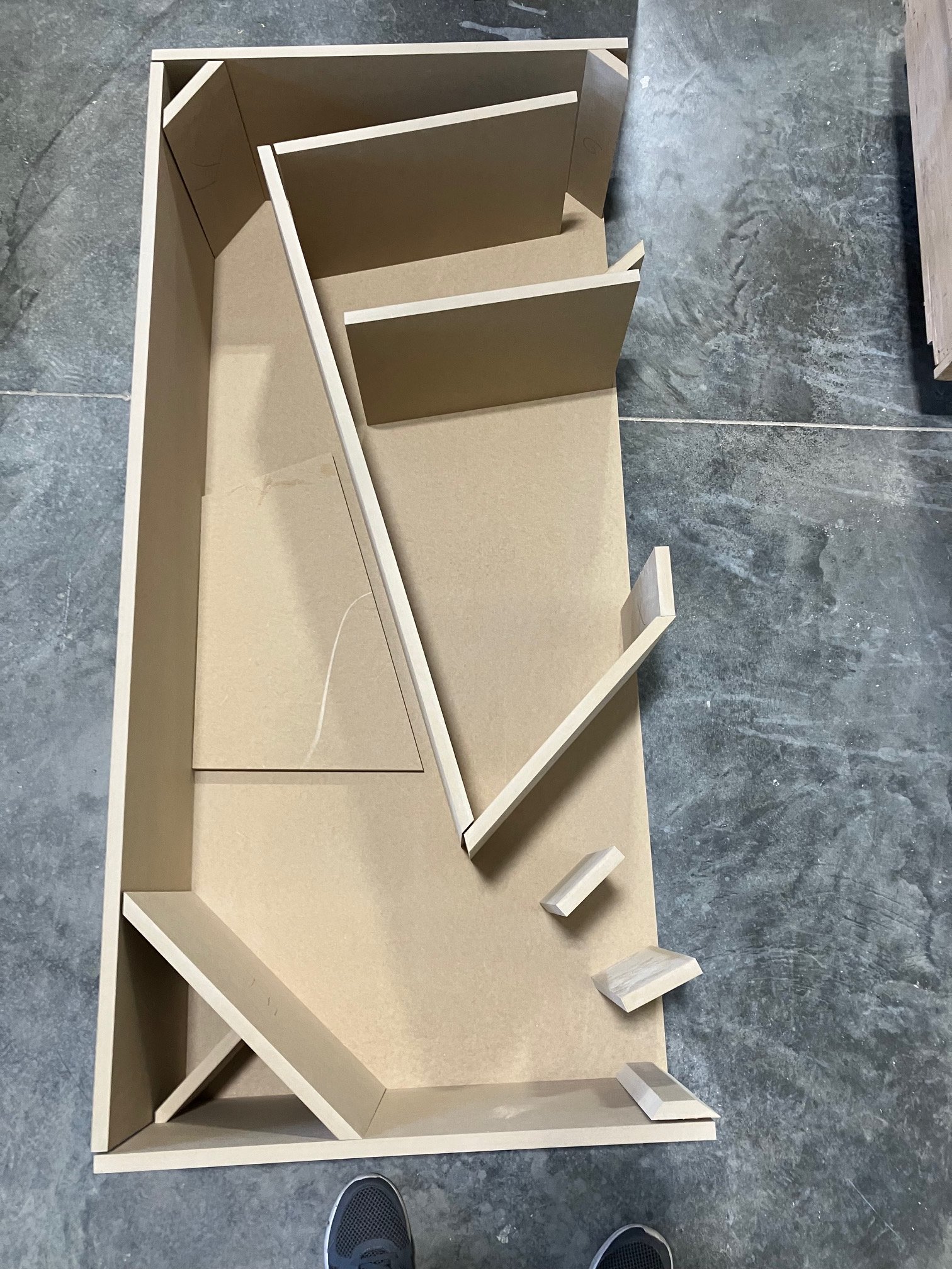

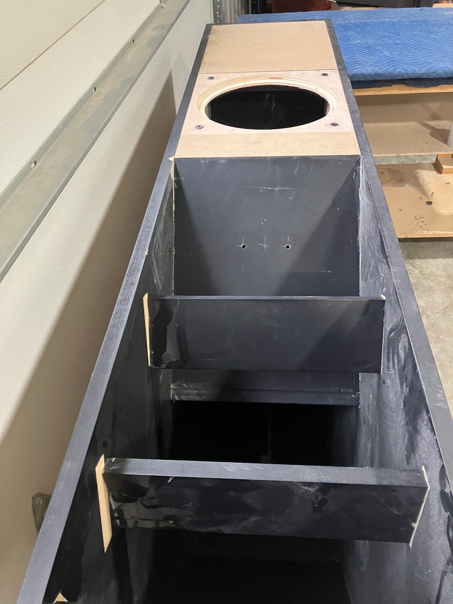

We use a nailer with set pins and Woodglue II. You cannot see the pins once the box is finished.

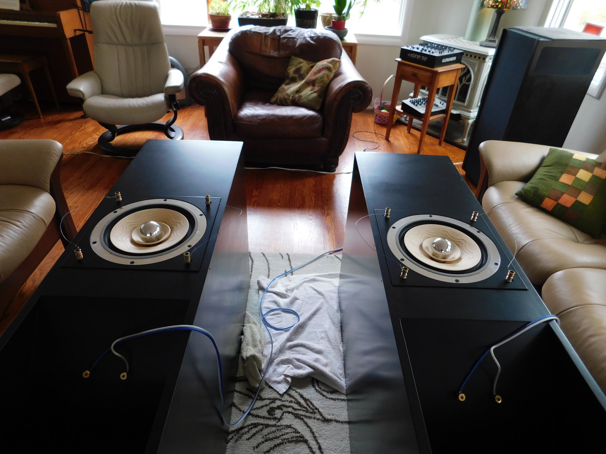

Still using my M3TL transmission lines that I built in the late 1990's
It's far from optimized (a bit boomy in my small room), but still sounds fine to me. But now I'm using active crossovers (minidsp 2x4HD) and 2 Rotel stereo amps and a Rotel preamp.
