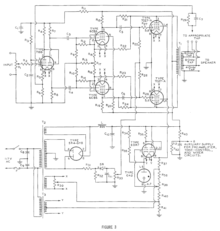

Regarding the RCA paper from #3: This is an amazing document, thanks for it! It makes me scratching my head, tjough: How could RCA claim those quite sophisticated performance data without even specifying the output transformers as the amplifiers' cores?

To the best of my understanding, close enough to swap 'em -- IF you take care of differences in their pinouts.So, is RCA's 7027A the same tube as the GE 7581A?
There are slight differences in pinouts to look out for.
The basing for 6L6GC:
The basing for 7581A is 7AC and looks identical to 6L6GC:
The basing for 7027A has pin 1 internally connected to G2, the screen grid. It also has pin 6 internally connected to G1, the control grid. Those are differences you will need to account for.
Thanks, I missed that !Actually each output transformers is specified on the page following each schematic, it’s in the BOM. Pic attached is for the 30W

Are there any datasheets for the recommended OT's?

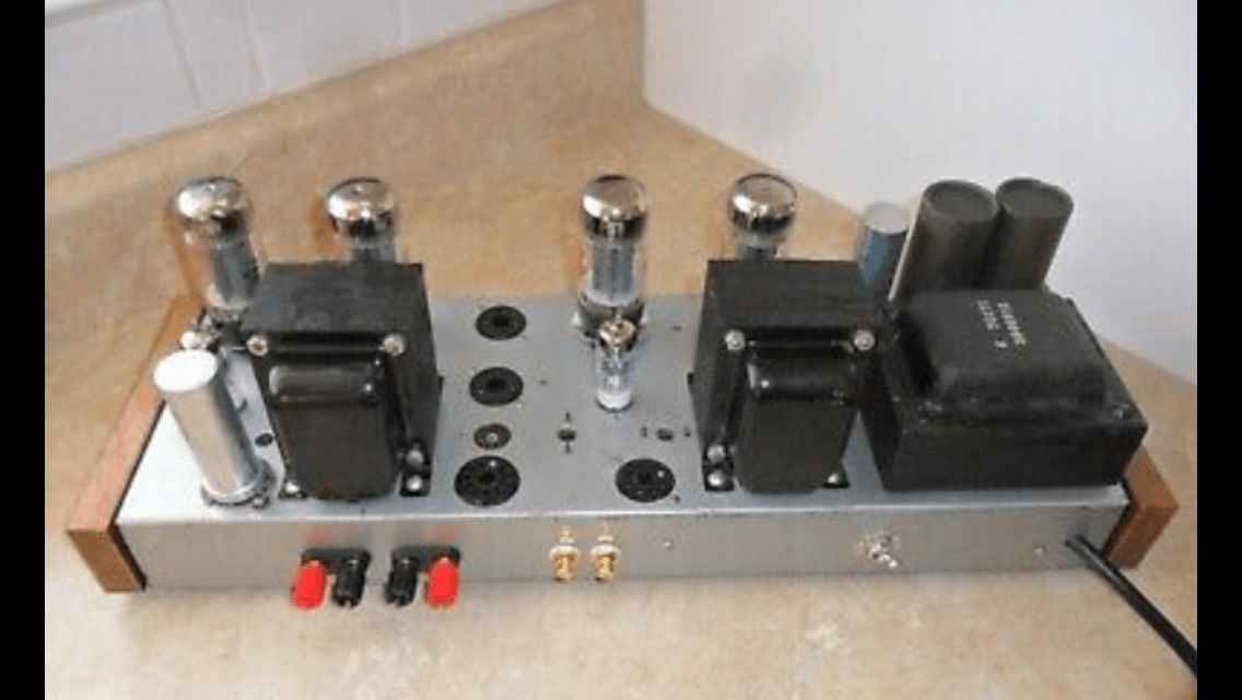

Well, I got a nice surprise this morning, while looking for something in the garage I found a KT88 quad I had purchased a few years back. Based on the spec sheet it looks like it will fit like a glove for my 30W per channel. See pic
So unless someone says it doesn’t make sense there will be my output tube.

KT88 should work nicely. However, when you look for the power transformer you'll need to take make sure it delivers enough current for both the heater and the plate supplies.
The KT88 heater requires 6.3V 1.5A per tube, so 6A of heater power is required just for the four output tubes. You'll need another 1A for the driver tubes, so the heater winding will need to deliver at least 7A. That might not be easy to find.
For comparison, 7027A heater uses 6.3V 0.9A. Four of them require 3.6A instead of 6A. That's a big difference.
Also, in most designs, KT88 will be used at higher plate currents than 7027A. The chart you posted earlier shows the KT88-triodes run with 76mA plate current per tube. with 349V plate-cathode. The quiescent plate current will be over 300mA for a stereo amp, and you'll want the power transformer to deliver more than that to deal with high power transients (like bass drum thwacks and music with a lot of low bass).
I'd say you'd be best off building mono-blocks, so each side can use a 200mA rated power transformer with a 4A (or better) heater winding. Incidentally, that's the current required for four EL84 tubes (for a stereo amp). KT88 is a good tube, but it's a power-hungry beast.
Thanks I’ll look into this. I had already thought of buying a separate 6.3V just to power the heaters. Hammond has plenty.
I had kept these KT88 for a more powerful amp (2 mono), something like 50W, I already have a huge PT and OPT for it but I figured I could use them now until I have the moula to buy a decent set of output tubes. I hadn’t bought output tubes for a while, I’ve been focusing lately on some SS Pass amps. I’ll probably buy a quad of KT77 instead of 6P3S-e. I’ve read many times that KT77 are great for classic rock (my cup of tea..)

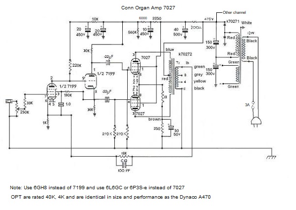

One thing to take note of is that the 30 watt amplifier in the RCA tube brochure uses fixed bias for the output tubes, and this bias is not adjustable in the circuit as published. The bias circuit is a bit unusual in that it is not derived from a separate transformer winding or a "bias tap" on the main secondary winding. The (negative) bias voltage is developed across R20 in the schematic, which is valued at 220 ohms (10 watts), and this resistor value will probably need to change if you change output tubes. I noticed that the RCA Receiving Tube Manual contains the same circuit but uses the 7868 output tube instead of the 7027, and its value for R20 is 120 ohms, rather than the 220 ohms used with the 7027. There are also some other component value differences but these don't affect the operation of the output stage. The power transformer specified is the same in both versions of the RCA 30 watt amplifier.
I won't try to guess at what an appropriate value would be for R20 using the KT88 output tube in your build because that value will depend not only on the particular output tube chosen but also the B+ voltage applied to the output stage, which in turn depends on the specifications of the power transformer you end up using. So be prepared to do some experimentation to set the output tube bias at an appropriate level for whatever output tube and power transformer combination you select.
Well-spotted. However this is not "fixed" bias. Voltage developed is according to current drain.The 30 watt amplifier in the RCA tube brochure uses fixed bias for the output tubes, and this bias is not adjustable in the circuit as published. The bias circuit is a bit unusual in that it is not derived from a separate transformer winding or a "bias tap" on the main secondary winding. The (negative) bias voltage is developed across R20
In a radio with a bunch of RF/IF tubes this was called "back bias". Variation of current in output, or tuner, were diluted by being summed with all the other current.
In this case the 7199 only draws maybe 8mA, while the 7027s suck 120mA, so it is 94% Cathode Bias.
Which is not a surprise. The 30W (design Max) 7027 can theoretically deliver 30W/pair in class A, and self-bias is very much more forgiving of tube and circuit tolerances.
FWIW, book value for 32W 400V 6600r is 200 Ohms. 220r may just be nearest standard value.
Use the datasheet number for that B+ and load. If "all" the current flows through, go down maybe 5% to cover preamp/driver current.guess at what an appropriate value would be for R20 using the KT88
Part of the "magic" of cathode bias is that largeish variation of cathode resistor makes a smaller variation in tube current.

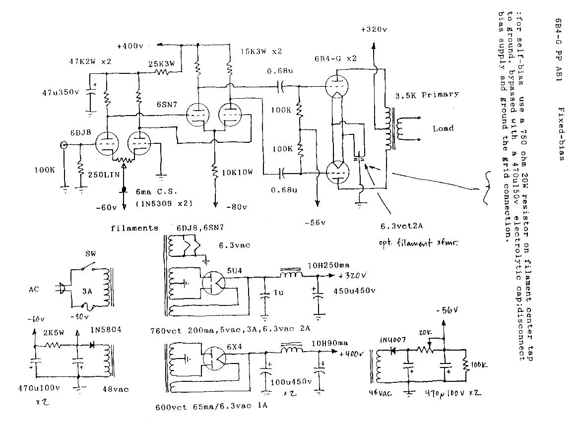

The attached schematic is the non-NFB PP amp that me and my buddy built. I changed the input stage to 6J5 with cathode resistor of 820 ohm. Power tube can be EL34 or KT66. With KT66, the output power is 23 watts at 5% in ultra linear mode. With EL34, it is better to run it in Triode mode for lower distortion.
