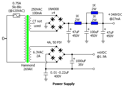

There's a good reason why the heaters in my headphone amp are powered by DC rather than AC, and that is explained in the original article I used as a build guide for my build, here's the link to the article again: https://headwizememorial.wordpress.com/2018/03/20/the-6n1p-otl-headphone-amplifier/
In the article, the writer, Bruce Bender states that "The first version of the power supply used A.C. straight out of the transformer to heat the filaments. The amp sounded fine, but had a very loud hum that didn’t go away until the filament circuit was rectified as shown in the schematic."
I have attached a pic of the full power supply schematic from the original article:
This is exactly how I built the power supply in my build, except that I used 1N4007 power diodes in the HT power supply, and 1N5404 diodes in the +DC heater supply, they seem to work fine.
I wouldn't worry about "overloading" the heater winding. At rated load, the heater winding dissipates about 1 watt, at 150%, it will be about 2 watts - spread around the outside winding on the transformer - no big deal. May be below 6.3V, but if the DC voltage is good, who cares? And B+ at 30 mA for the 2X MJ circuit is well below the transformer rating.
As I said before, I suspect the hum was due to improper elevation. No matter, you have 1.8A worth of tungsten to heat up, but your power transformer is not rated to provide that much rectified power. Don't be surprised if the transformer has a short lifespan.

You lose power when you convert AC to DC. If you were heating the tubes with AC your total draw would be 1.812A, but you are using a bridge rectifier to convert that AC to DC, and when you do that, you lose power. The heater supply draws more than 1.812A from the transformer to deliver that much DC power. I figure you're running at about 150% rated capacity.
Since the HV secondary is not heavily loaded, the transformer has power reserves for that second secondary to heat the tubes. If the wire is thick enough that it doesn't get too hot, it won't hurt. He should measure the AC voltage at full load (as it is) so if it is not below 6.3V then everything is fine. If it is less than 6.3VAC, the wire is not thick enough for the increased current.
That 1000uF capacitor is not enough to iron out the voltage, so the heating is some DC plus strong ripple current of 120Hz. I would try AC heating with a CT lifted from the ground to 1/4 HV. There are other methods to control hum with AC heating. AC should be better because the diode bridge creates a bunch of interference, and there is not enough capacity to iron it out. He need to check the voltages, because the heating secondary is probably not 6.3-0-6.3V (as written and drawn) but 6,3V CT (3,15-0-3,15). 6.3-0-6.3V would be 12.6V CT. Otherwise, according to attached schematic, the heating voltage is much higher than 6.3V.

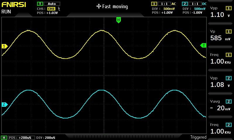

I'm just about to get things all set-up on my test bench so I can take screenshots of the output waveforms of the two left and right outputs of my OTL Tube Headphone amplifier build, I will be making a little stereo dummy load for the amp, which will consist of a standard 1/4 inch, or 6.5mm Tip/Ring/Sleeve plug and two 33 Ohm/1% Metal Film Resistors to roughly simulate a pair of 33 Ohm headphones, it may not be a totally accurate simulation but as I'm only going to be using a 1kHz Sinewave as a test signal, I think it'll be "close enough for government work".
I finally figured out how to create and export screenshots from my new FNIRSI 100MHz Digital Scope, so, once they're done, I'll post them here for you to check out....stay tuned!!!!
Here we go, I managed to get it all set up so I could show both the left and right channel outputs of the OTL Headphone amplifier, the yellow trace is the left-hand channel going into a 33 Ohm resistive load, the pink trace is the right-hand channel going into a 33 Ohm resistive load, I adjusted the volume control for the highest output level with the least amount of clipping, there is some soft-clipping on the bottom peak of the waveform though.
