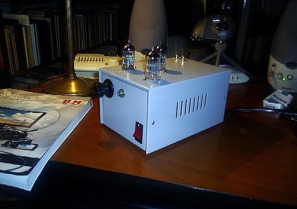

Recently built myself an OTL headphone amplifier using three Svetlana 6N1P tubes
The pinout of the 6N1P Tubes I used in my build is very similar to the pinout of, say a 12AX7/ECC83 except that the heaters are connected to only pins 4 and 5, pin 9 is internally connected to a shield which is placed in between the two triode sections, so I connected pin 9 of each of the 9-pin sockets to chassis ground.

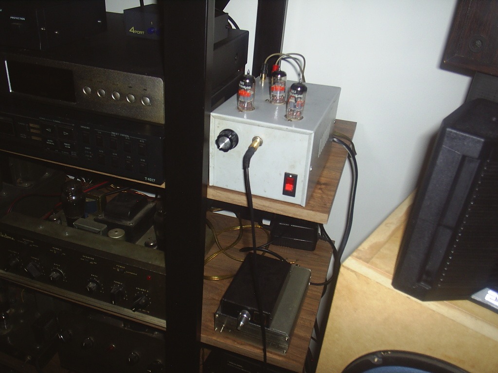

Thanks for sharing great work I made this amplifier several years ago and it continues to accompany me I use 6DJ8. I called it ugly duckling. Thanks

Looks cool, a 6DJ8 is similar to a 6N1P, the 6N1P has similar ratings but requires about twice the heater current than the 6DJ8, so both the 6DJ8 and the 6N1P should work in the circuit, I had never tried 6N1P tubes before so i thought it would be cool to give them a try, I like the "sound" they have.

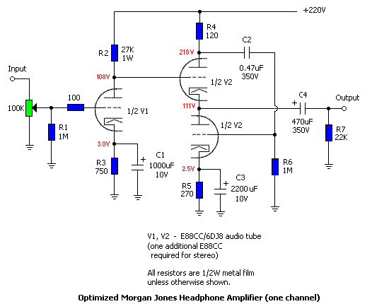

I bought the ones from the link above. Cheap and great sounding. Only now the values on the scheme must be changed, there is some work to be done. And the anode current will be about 20mA for each 6N6P, all together about 50mA. Can the power supply make this possible?
To my ears, the three Svetlana 6N1P tubes I used in my build do seem to sound really good, the amp is very pleasant to listen to for extended listening sessions, my ears don't seem to get fatigued much at all, there's more than enough volume being produced by the amp even at relatively low volume settings, you really don't need to turn the volume up full at all.

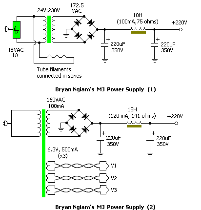

That transformer secondary is over the limit even with 3 x 6N1P. That is why it is hot.
Power Rating (VA) 40
Primary VAC 115
Primary Frequency 60
A.C. High Voltage Secondary RMS 250V C.T. @ 115ma.
Filament # 1 VAC 6.3V @ 2A
The data sheet of 269AX does not mention 6.3V CT for heating, and in your schematic it is drawn that way?
It's AC, and there is a diode bridge and a capacitor. In general, for DC you need more AC current (1.41xDC current). In principle, since the transformer has two secondaries, this one "borrows" from the second one, which is not heavily loaded. If 1.8A is required for DC heating, then the secondary should provide at least 2.5A. Additional problem is that when you have a diode bridge and a capacitor, the current is not sinusoidal, and you need to add more reserve to the secondary because it is dimensioned for sinusoidal current. If it is AC heating of the tubes, then the current is sinusoidal.
oh yea. @DrNomis44 you are overloading your transformer. You can heat 3 6N1P tubes with the 269AX with AC, but for DC you need at least 2.5A supply, and maybe >3A to account for inrush current. Looks like you should use 6DJ8/6N23P, back to the MJ design.
Also, I've never seen heater elevation done with a cap in that way. I would create a voltage divider off the HT supply and connect that to the center tap, or the (-) leg of the circuit if DC. Then you have a bleeder resistor for the HT as well.
For the 6N6P variant, I would use a PT with a slightly higher output voltage, and a much beefier heater supply winding. Over here we have an Antek that makes 280v@90mA and 6.3v@4A at a good price. CLC power supply.
I heat 2x6N6P with 12.6VDC and 750mA, heaters in serial connection. I am using LM340T TO220.
Heather elevation is 1/4HV, about 50VDC. AIKIDO Cathode Follower.
The transformer is 80VA, the excess does not cause headaches.
