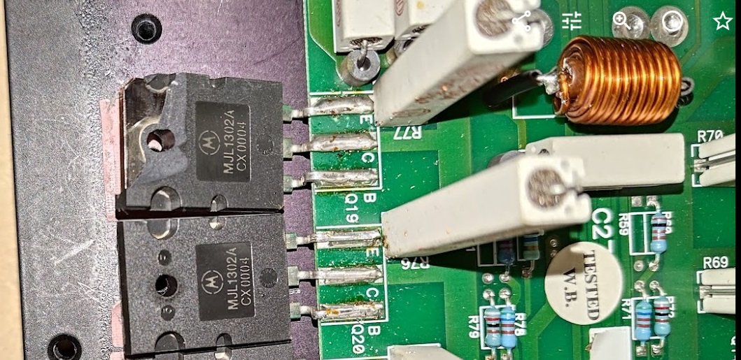

I decided to go for the second channel. Unfortunately, I broke one power transistor (Q19) while trying to remove it from the radiator (as explained above).
It is not a big deal to find some stocks of MJL1302A on eBay. However:
- Do you confirm that I absolutely must replace it?
- If so, can I replace this one (Q19) only ? Or should I pair it with Q15? And how can I pair those two?
The die on MJL1302 is not near the corner that broke off. I would leave it. Output transistors need to be matched for Vbe or gain, so all of the ones in parallel gets you a chance of a better match.

As a general rule don't even think of buying semiconductors off eBay, far far to many fakes and remarked parts around. Always buy parts from authorised dealers.t is not a big deal to find some stocks of MJL1302A on eBay0
Agreed although it looks like it not be able to be torqued down correctly as the face is uneven.The die on MJL1302 is not near the corner that broke off. I would leave it.
Q15? I see Q19 as its paralleled pair. They should ideally be at least from the same batch. The emitter resistors will do the rest as far as matching goes.If so, can I replace this one (Q19) only ? Or should I pair it with Q15? And how can I pair those two?
Thank you to both of you. I chose to keep the transistor as it was, since the broken piece could easily be put back and the transistor correctly torqued.Agreed although it looks like it not be able to be torqued down correctly as the face is uneven.The die on MJL1302 is not near the corner that broke off. I would leave it.
