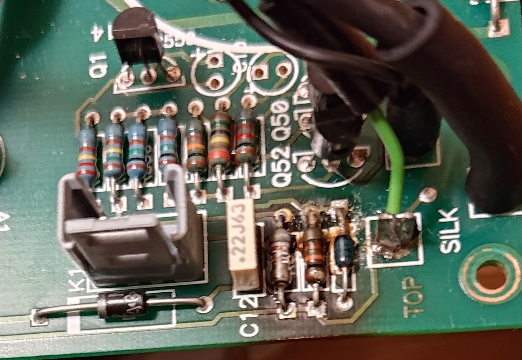

I am from France (please excuse any errors in my English). I recently joined diyAudio because I need advice regarding a Meridian 557 power amplifier.I have started recapping this amp, which I bought second-hand. I discovered that a part overheated and a resistor (R553) burned out (see picture) and must be replaced. On the attached schematic, I can see that the Zener diode (D50) is listed as 15V, while on my amp, it is an 18V Zener diode. My amp was built in 2001, whereas the schematic is from 1995.Here are my questions:
Thank you in advance for any advice you can provide.
Thierry
- What could have caused the damage to R553? I don't understand what "Short S.S. Cap" means, to be honest.
- In your opinion, which other components in this area might also be damaged?
- Would you suggest replacing the 18V Zener diode with a 15V diode?
Thierry

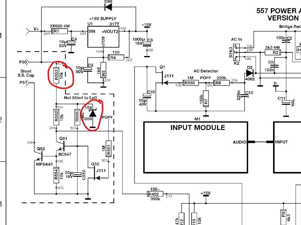

Op amp supplies are often + and - v. If you have a - 18 v supply, then certainly do not replace the zener with a 15 v one. The supplies have to be symmetric.
Zeners are high failure parts. I suggest you replace the resistor with one of equivalent or higher wattage, and then check the voltage across the zener with power on. Warning, do not use two hands to probe an amp with the power on. >24 v across your heart can stop it. No rings or metal on hands wrists or neck. Wear safety glasses, parts can explode.
If the zener does not measure nearly 18 v, replace it with one of same value.
Warning Vishay resistors now have a watt rating at 350 F. Also are tiny. The resistors can stand that temperature, but your board will burn. Buy resistors of at least the same length as the ones now installed.
Since freight from the distibutor is $10 and the zener is $.20, I would buy the zener now.

Hi Indianajo,
Thank you for the advice, including the suggestions related to safety. I will do as you say. We still have some shops in Paris where I can easily pick up resistors or Zener diodes. Capacitors are trickier to find, and I have already ordered them.
I will let you know if I am successful with this project.

Much of the circuitry is not shown on this diagram but R53 and the Zener are. It looks to be part of some standby/muting/power on/off detect type of circuit.
For the 10k to burn requires significant voltage and the the fact the 15 volt regulator above it is fed via two series 4 watt 680 ohms suggests a highish (DC) voltage is indeed present. So any 10k should be voltage rated as well as rated just in terms of power dissipation. It would be worth measuring the actual voltage present and calculate the dissipation in the resistor.
The Zener is just a cooking grade part and the wattage can be determined from the above calculation from which we can derive worst case dissipation.
I suspect the arrangement of all these power supplies mean this area runs very hot and all electrolytics will be highly suspect in that case.
