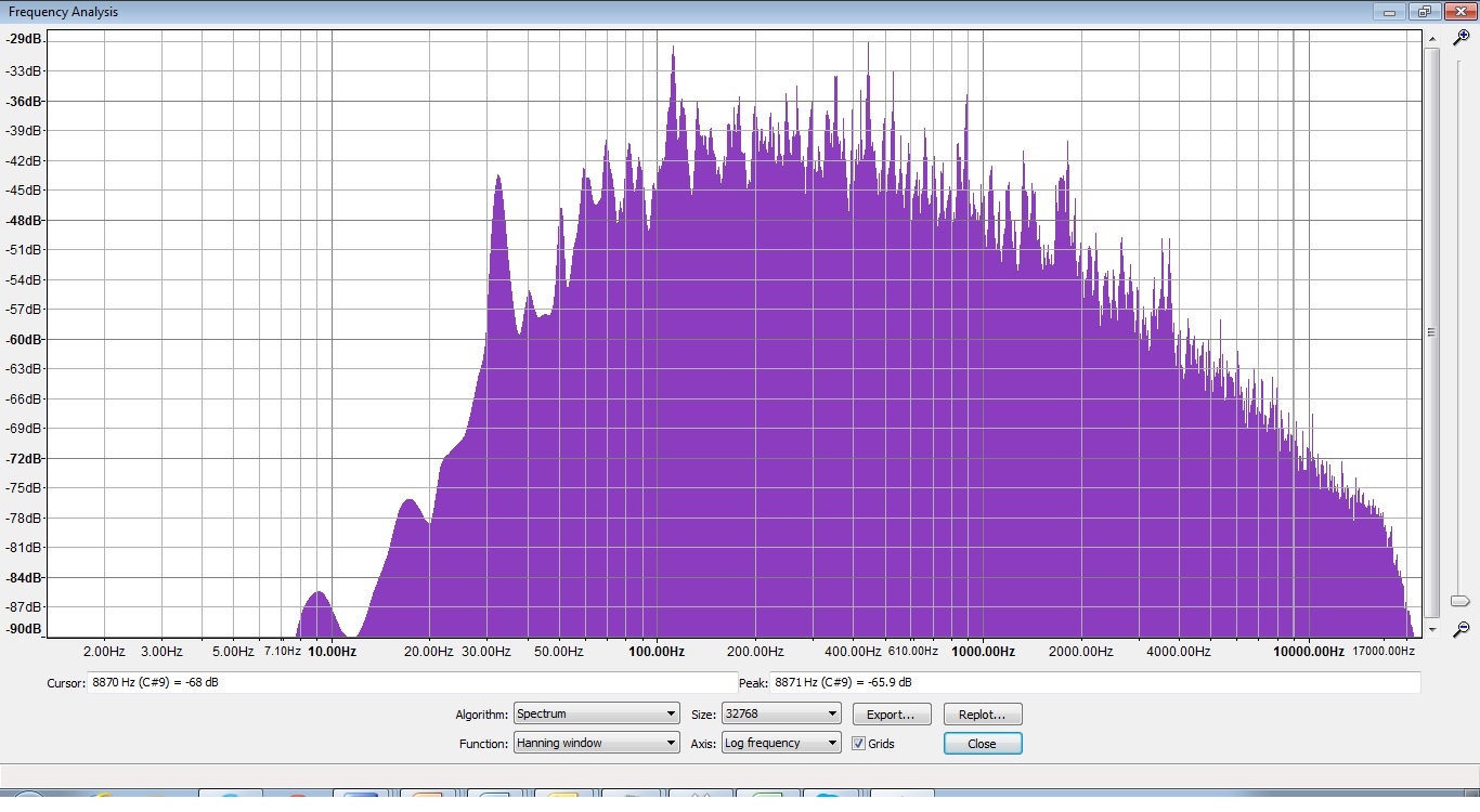

Halle orchestra mahler 9. Halle record their own stuff now and from some pictures I have seen of them in session its rather more miked than I might like, but it looks ok to my untrained eye.
I might load up some of my mercury living presence CDs for a peek a those. But so far looks as if I am either very lucky or have made some good choices in the labels I buy from. Suspect the former!

Actually, that looks like a prime example of loudness equalization - starting at about 200-300 Hz and continuing toward 40 Hz. Recommend a fairly large boost at 30-40 Hz, tapering down to no boost at 240 Hz and a little push down in the EQ curve at 400-1000 Hz (equal amounts).
Try ""Equalization..." under the Effects menu, and switch to "Draw Curves" radio button, then you will be presented with an EQ curve. Just anchor the endpoints at 20 and 20 kHz, then pull the line up or down as you need to.
If you make a point that you don't need, simply drag it off the plot an release the mouse button. You can go back and forth, adjusting the amount of EQ needed each time until the curve looks fairly flat and increasing as it goes toward 40 Hz.
"Undo" is ctrl-z. Run "Normalize" from the Effects menu to re-normalize the track amplitudes after you apply your EQ filter. Make sure that you're playing the track back at about 80-90 dB at your listening position in the peaks for orchestral music remastering when listening to the edited track.

I will try that sometime. I should note that my sub is currently awaiting comissioning so my system can't handle that much low end. I do however need to do some more research on that piece to sort an argument about the peak SPLs needed to do Mahler justice.

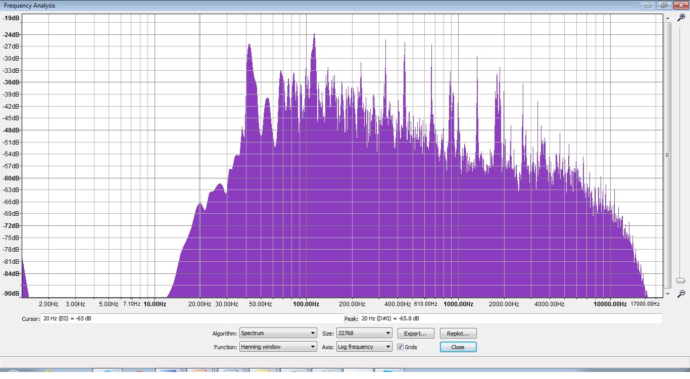

Couldn't resist this. Mussorgsky's night on bald mountain from one of the Mercury living presence box sets. Remastered for CD by Wilma Fine herself from the original 35mm 3 track tapes. State of the art in the mid 50s! Actually quite suprised at the amount of energy at 43Hz.
