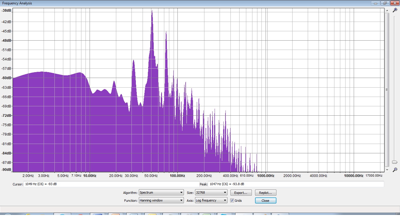

Anything in last 2-3 years on a label that puts quality first? Or pointers at what I could download for free to look at some of my CDs in comparison. Not sure I trust the spectral analysis on foobar.
BTW I thought Timpani were around 60Hz fundamental?

Most of the published spectrum charts for the different LF percussion instruments are wrong. You can see it on the spectrograms directly from the tracks themselves. Some timpani lines go lower than 50 Hz, and kick drum fundamentals go to about 30-35 Hz.

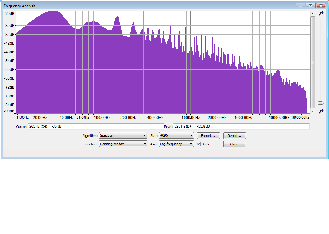

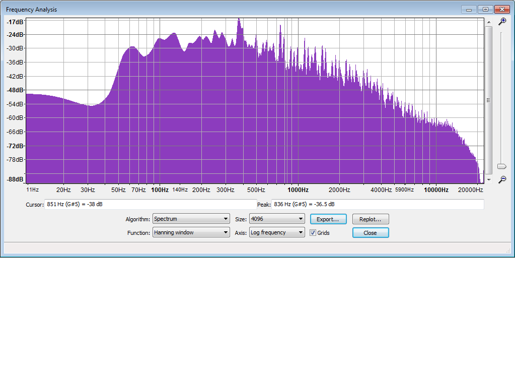

Well audacity is installed and limited myselft to a couple of examples in my lunch break
First one is from the end of the first movement of langgaard Symphony 1 on decapo. Second is from a recent Chandos release of fucik (sorry can't work out the accents) and is some triumphal winds combined with lots of timp and cymbals. So is there any obvious signs of tampering here?
@Chris: Open but cynical mind .

Sorry, I missed that particular post (the default pages are very short on this forum).
The second spectrum looks fairly good (as in not EQed to make it sound louder), the first - not so much.
Is the second recording a multichannel one? If so, there is a separate "LFE" channel (the fourth channel) that holds the LF information that is typically left intact by the mastering guys. All of my comments above apply only to 2-channel recordings without LFE. All my multichannel recordings look like that one.
I also recommend opening up the vertical scale a bit to see the issues, as the magnitude of the corrections always looks small when the vertical scale is compressed (like loudspeaker frequency response curves typically posted by manufacturers).
I've found that as you get very close to a target curve, very small corrections then lead to larger perceived differences. This is another clue.
Chris

The Fucik is indeed available as SACD, although this is from the redbook layer. I don't have 5.1 capability at home so tend to get the 16/44.1 downloads unless forced to do otherwise. The segment was also extremely lively.
I'll pull some more samples tonight. See what Mahler looks like.
This is interesting. Most PCM layers I've found to be "loudness EQed" on multichannel discs. In fact, I've found that is the main reason why people prefer the DSD/DSF layers instead - because up to about 2 years ago, native DSD was not editable using the DAW software available.
Some of my multichannel jazz SACDs are spectacular simply because the mastering guys couldn't edit the bass tracks to attenuate them. The 6-string jazz bass has an open around 32 Hz, and that is really nice to hear, for instance, the Yellowjackets multichannel SACDs. Highly recommended if you have the bass extension and SACD/DSD reading capability.
Chris
