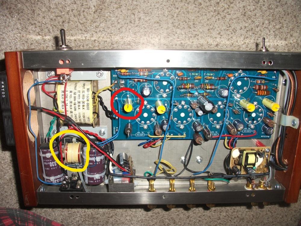

Since now same issue as OP- Hope its ok to now post findings from previous Q's regarding my same issue.
1. Chassis is non- ferrous

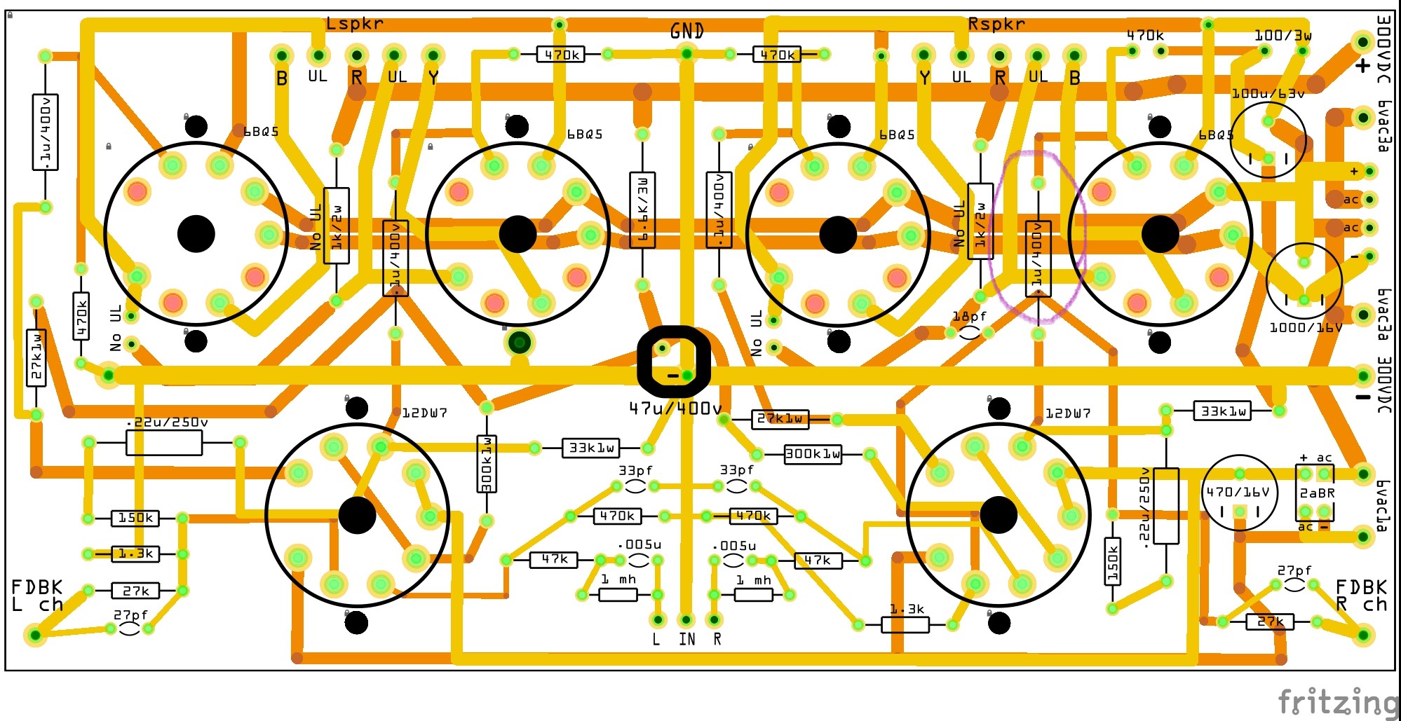

2. Choke remoted mounted, then relocated 90* phase shift from original position(Pic #1- yellow circle)
No difference in L ch hum either change above. Maybe hum induced from close proximity and orientation of PT to L ch signal coupling cap?(Pic #1 red circle)
Perhaps new PCB design (Pic #2 purple circle)which distances L signal coupling cap from PT will cure single channel hum- This is new dive into all triode design- away from pentode preamp stage
