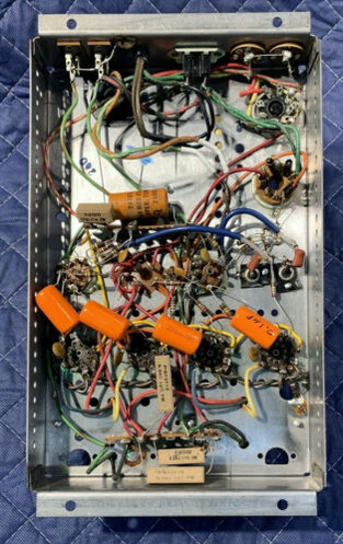

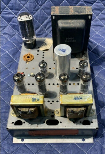

Since now same issue as OP- Hope its ok to now post findings from previous Q's regarding my same issue.He says he hears a hum difference between channels. I got the amp home and sure enough, one channel is at 0.5mV, the other at 1.1 (inputs shorted, 8 Ohm resistive load)
1. Chassis is non- ferrous
2. Choke remoted mounted, then relocated 90* phase shift from original position(Pic #1- yellow circle)
No difference in L ch hum either change above. Maybe hum induced from close proximity and orientation of PT to L ch signal coupling cap?(Pic #1 red circle)

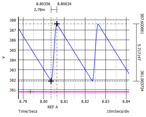

Perhaps new PCB design (Pic #2 purple circle)which distances L signal coupling cap from PT will cure single channel hum- This is new dive into all triode design- away from pentode preamp stage
To be continued-
Jim

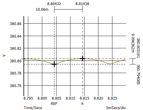

The B+ to the output tube screens, the input amp and phase splitter measure just 25mV rms on top of 316V, while the output tranny centertaps have 1V riding on 360.

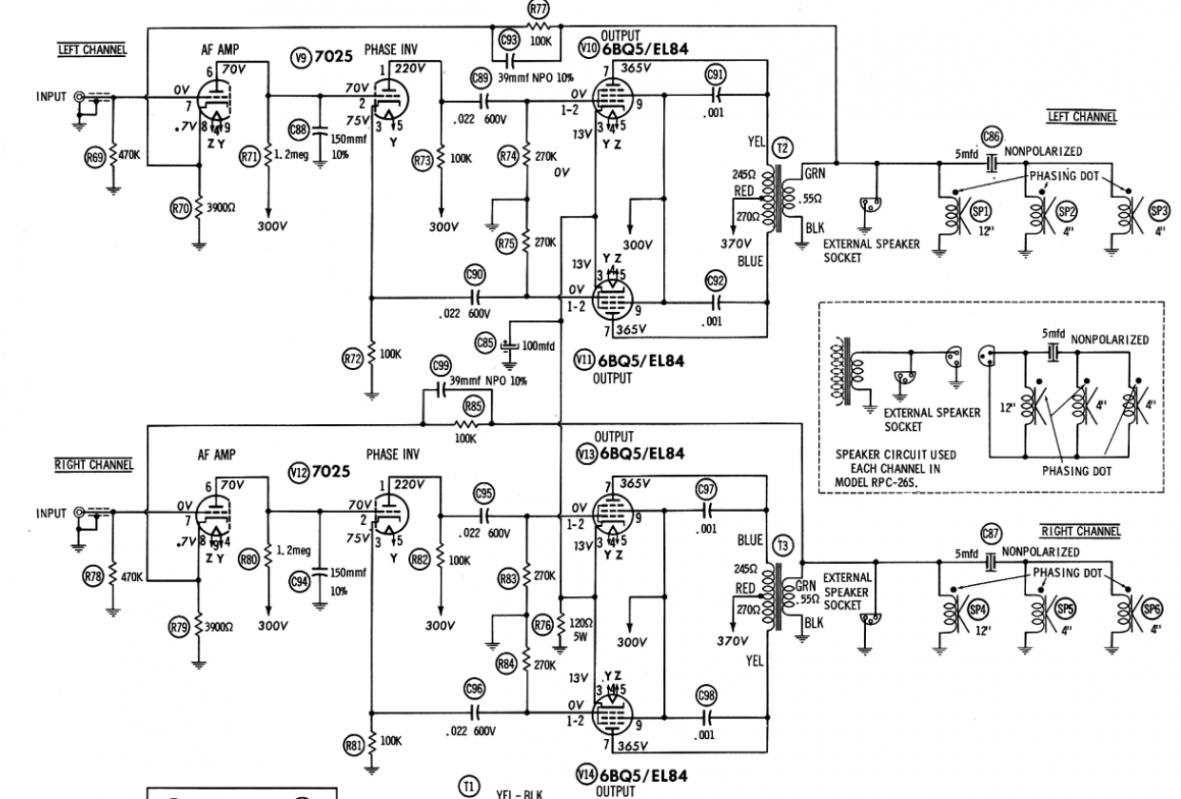

Two reasons I do not like the Concertina Phase Inverter:
The Filament to Cathode leakage resistance
The Filament to Cathode capacitance (small, but different hot versus cold).
The Cathode of the concertina is Not bypassed (can not be bypassed, it is not a common cathode circuit).
I have had amplifiers with concertina phase inverters that transferred more than 60Hz hum, they also transferred mid and high frequency Power Mains noise.
And, our ears are more sensitive to those mid frequencies (Ugh!).
Use a concertina, your mileage may vary.

The 6EU7 concertinas in MY amp doesn't cause any issues.
Dead silent output, only music comes through, no hums.
And concertina's are well liked for their performance by many.
Naturally balanced by design driving a pair of output tubes.
Read some technical articles, because about the only issue possible in a properly designed concertina amp is limited to being overdriven, and that is only under abuse.
