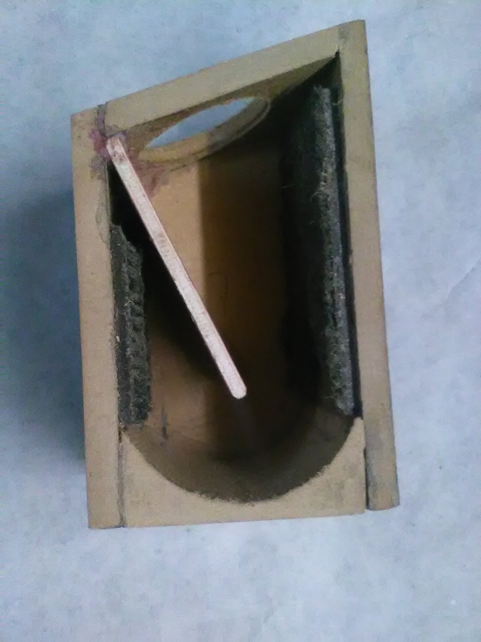

Hi, what is your current setup like? did you get rid of boxes, or how you have settled down with it?View attachment 1218366When I first started fiddling with speakers, one of the first things that I did was to isolate the mechanical vibration of the driver from the enclosure, however upon doing this, it made the "echo" from the inside far more obvious - diminishing one distortion just highlighted another. After this a I tried all sorts of ideas to diffuse/absorb the rear "wave", my favorite is the tapering wedge as pictured. But I'd consider that it only really matters with full range or cone tweeters; take the BBC Ls35a as an example, the rear of the enclosure is really close to the mid/bass driver, which has a high order crossover, this means there's going to be very little high frequency output in the range that would be effected by any reflected waves.
I'm currently using speakers that are about half way through construction; someone on diyaudio extolled the virtues of the Visaton VS-BG17 165mm full range driver, so I decided to try a pair, and the idea was to make a simple enclosure to see what they sound like, however it hasn't quite worked out like that. There didn't seem to be much point in trying them with enclosures that compromised their sound, so the 6 pieces of wood with a hole became about 22 pieces and a bit of cardboard tube. The intention was to slam them against the rear wall, and if they didn't have enough bass, make some subs for each to stand on, and it became apparent that subs were needed, so 2 QTX 902.536 6inch pa drivers were tried in some left over enclosures and that is what I am currently listening to. I have got two more qtx drivers and I am almost completed two sub enclosures that will have 2 of the qtx drivers (back to back) in each one. Then I will make a 4 channel amp, two channels for the stereo full rangers, and two channels for each sub. So much for the simple boxes to see what they sound like. I might post a few pics on the full range photo gallery once they're done; I'm not sure that they warrant a thread of their own. They (the full range enclosures) do use a folded tapered wedge.
