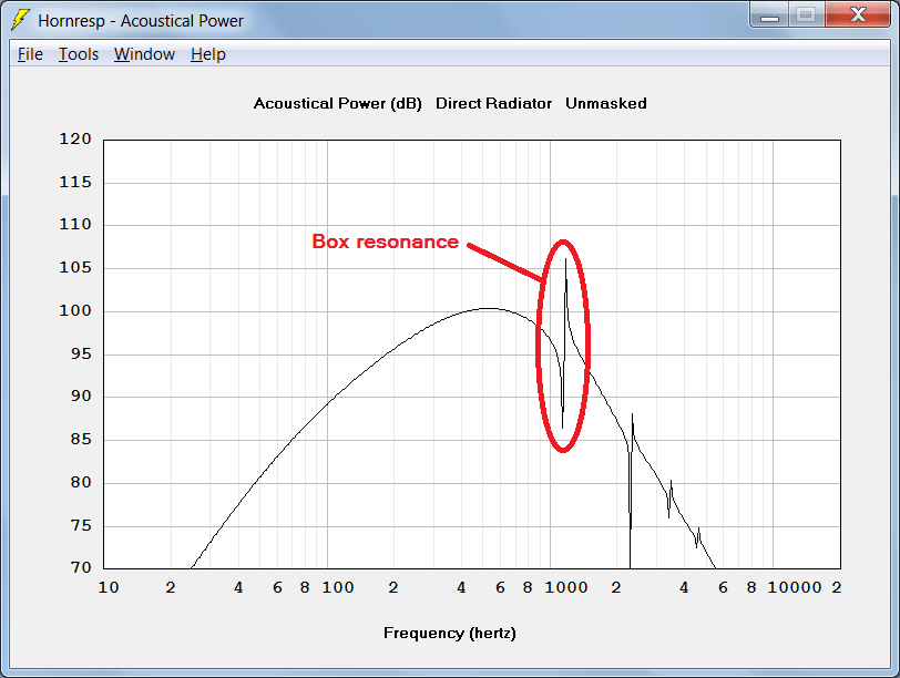

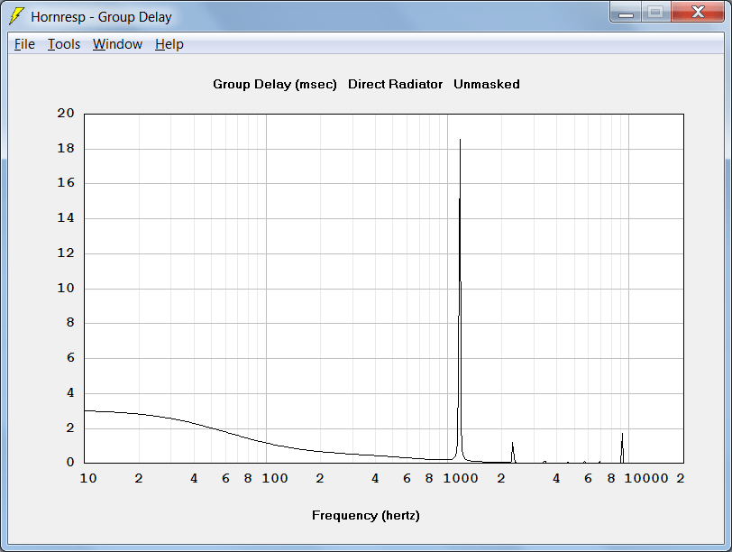

Models simplify reality. Sometimes too much. Such as here. You can’t use raytrace theory when wavelengths are relatively big compared to the ‘reflecting‘ plane. Also, you can’t use simple standing wave models for more or less cubic enclosure shapes that well. Acousticians found a way around this by defining three sets of room modes in a rectangular room, but this approach also is a simplification. So you could argue if the definition ‘standing wave’ is correct in threedimensional space. I hope picowallspeaker wants to point that out In his denial.
There always are solutions for the so called wave equation though, that show us resonances in enclosed spaces. Be it spheres, odd shapes or just the usual shoebox. These resonances appear at a set of frequencies determined by the internal shape and sizes and the enclosed medium.
What’s important is: do these internal resonances interfere with the sound reproduction we meant to achieve? Can you hear the disturbance? A lot has been written about that. But think of this: can you hear reverberation? Does it add something to the original sound? Do you want that? If you do, feel free. If you don’t: take care of it.
