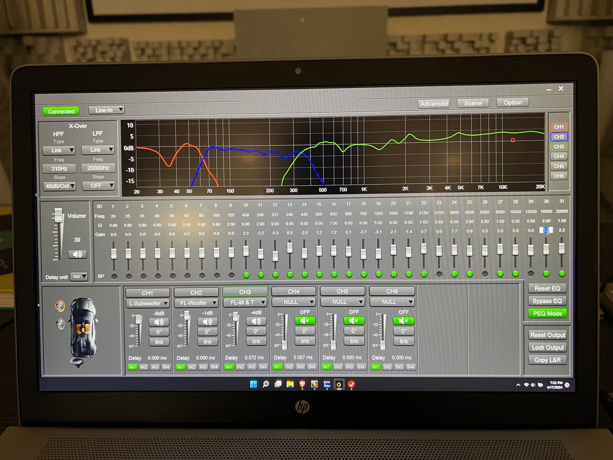

I used House Curve with the new Dayton USC C measurement mic. House Curve is an app that will generate the Parametric EQ filters or FIR. Then you have to input the PEQ points manually. I have a 6 channel unit that I got from China that has a 31 band PEQ with a very nice software that I am playing with and it sounds much better OOTB than the PRV. It is much harder to mod but the general layout is better and setup was much easier to get going as it is real time from a control PC.

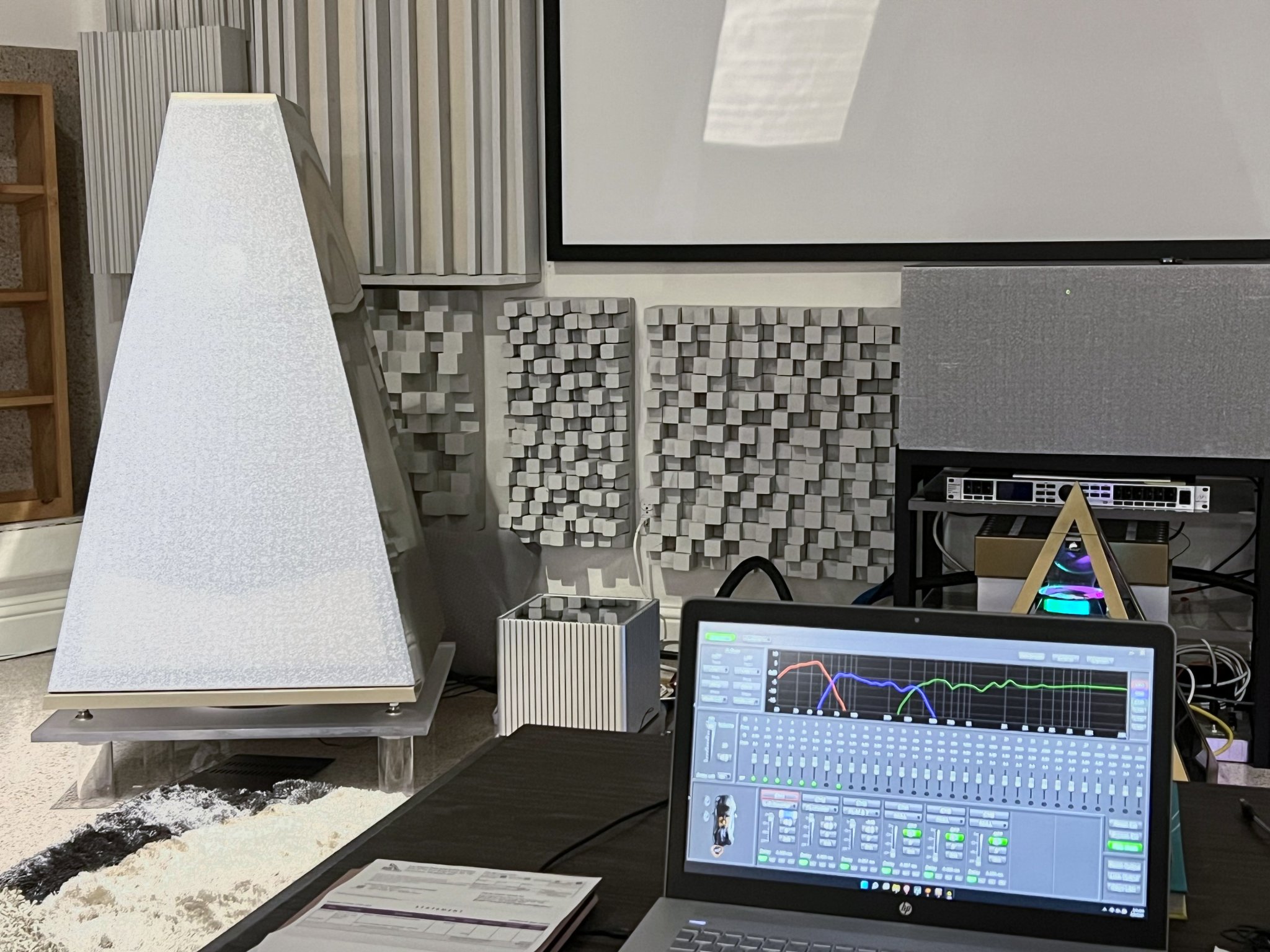

Currently doing a 4 way fully active setup with 2 of the China sourced boards. Pics show the interface as I was adding channels to the build.

The one that I bought several of has been replaced by this unit. I have not tried this new er unit however the one I have was easy to work on and the only mod that made much improvement was the op-amps. There is very good local bypassing and the unit I used is very quiet and had no PS issues with faster op amps.
Much easier to use than the Mini DSP or the PRV ! I used 1 per channel so I had to setup the first one, store the settings on the software and apply them once I hooked up the second channel. I am extremely pleased.
