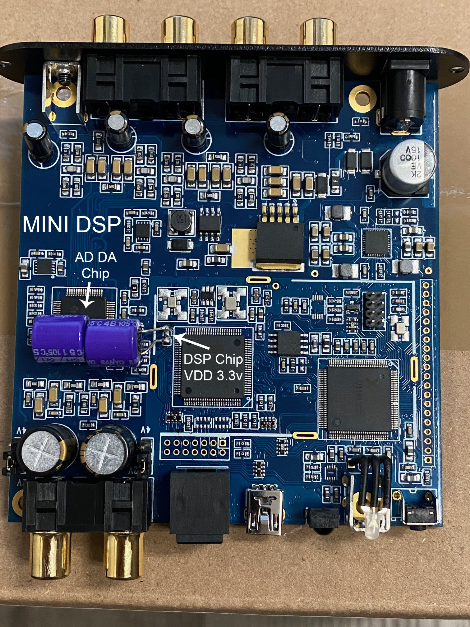

I have been sick 2x this fall which set me back massively of free time but hope to resurrect this thread as I really am super pleased with where I have been heading on this venture. I have also started down a parallel rabbit hole with car audio based DSP's and there is a whole plethora of products there since it seems to be massively more popular in those installs. A local audiophile friend Noel Lee ( the Noel Lee who started and owns Monster Cable) introduced me to the car based units after I mentioned the PRV. We are getting samples from China soon.
On to what I did/ discovered:
The first thing one needs to do, even before mods is get the input levels right. You can set the levels in the interface however if you are not using a tape loop type of setup that sends full signal level ( pre out to power amp) then it can suffer a lot and I suggest setting your pre amp to a higher volume level and compensate in the interface. This is even more important for the car audio based stuff where line level is 4 to 9v!

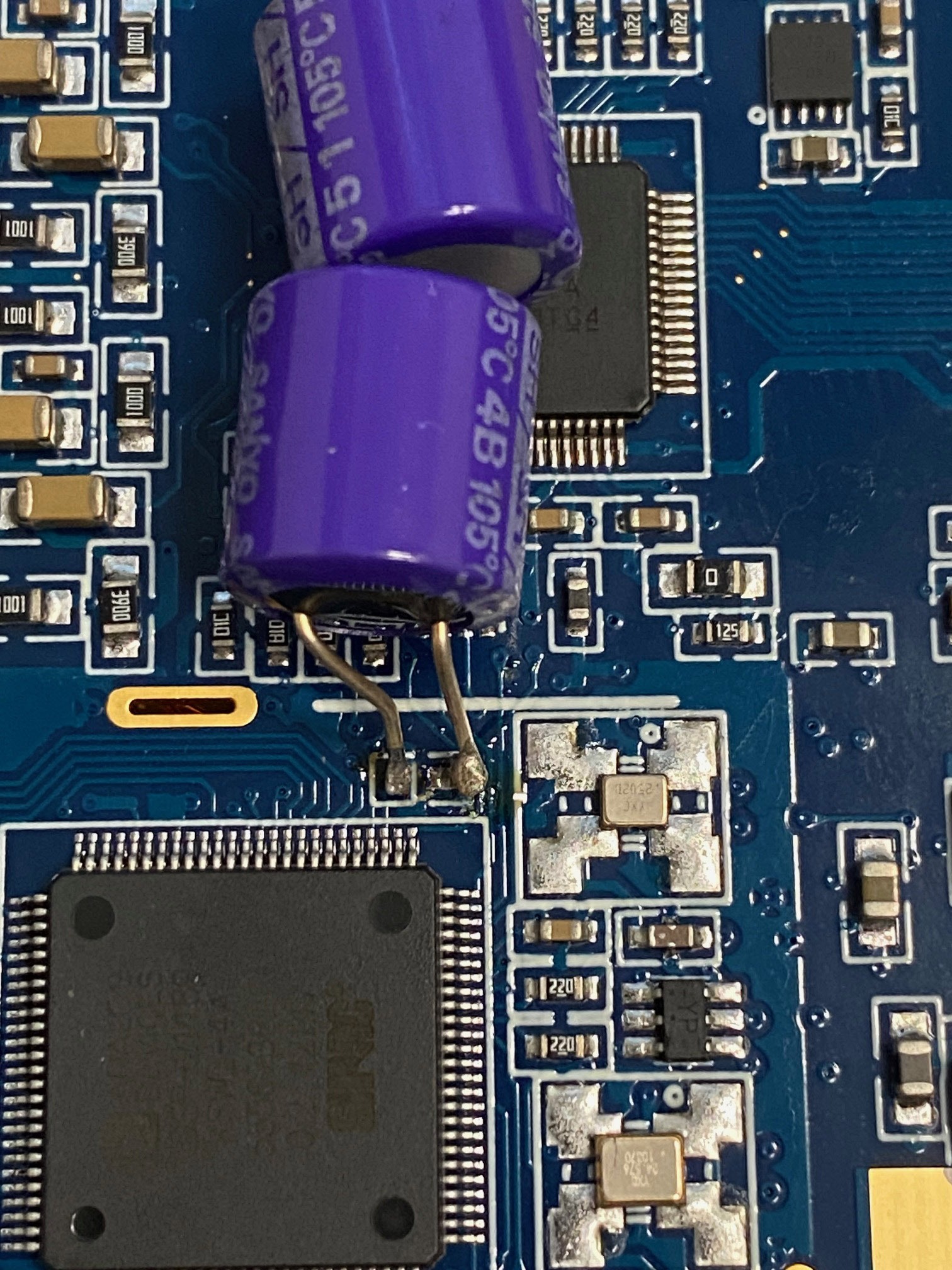

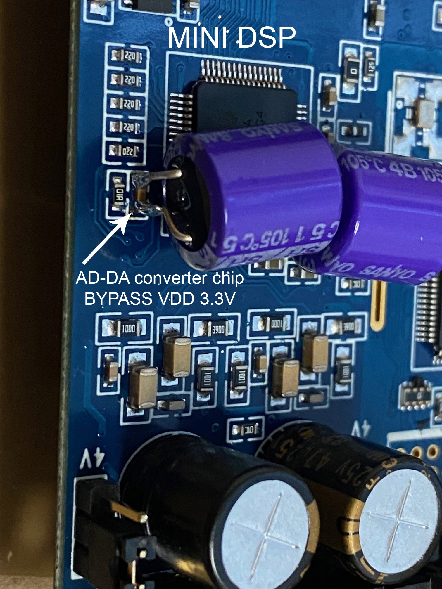

Mini DSP 2x4HD Bypassing. I also suggest a linear PS. I have several from AliExpress that sound excellent. The AD chip and DSP chip are well bypassed locally underneath to the ground plane and I am surprised that the big Oscon had the effect it did but it was a large improvement. I used 330uf 6v units. Looking at the overall circuit there is not any large capacitance after the regulators, only local bypass so that may be part of the reason for improvement.

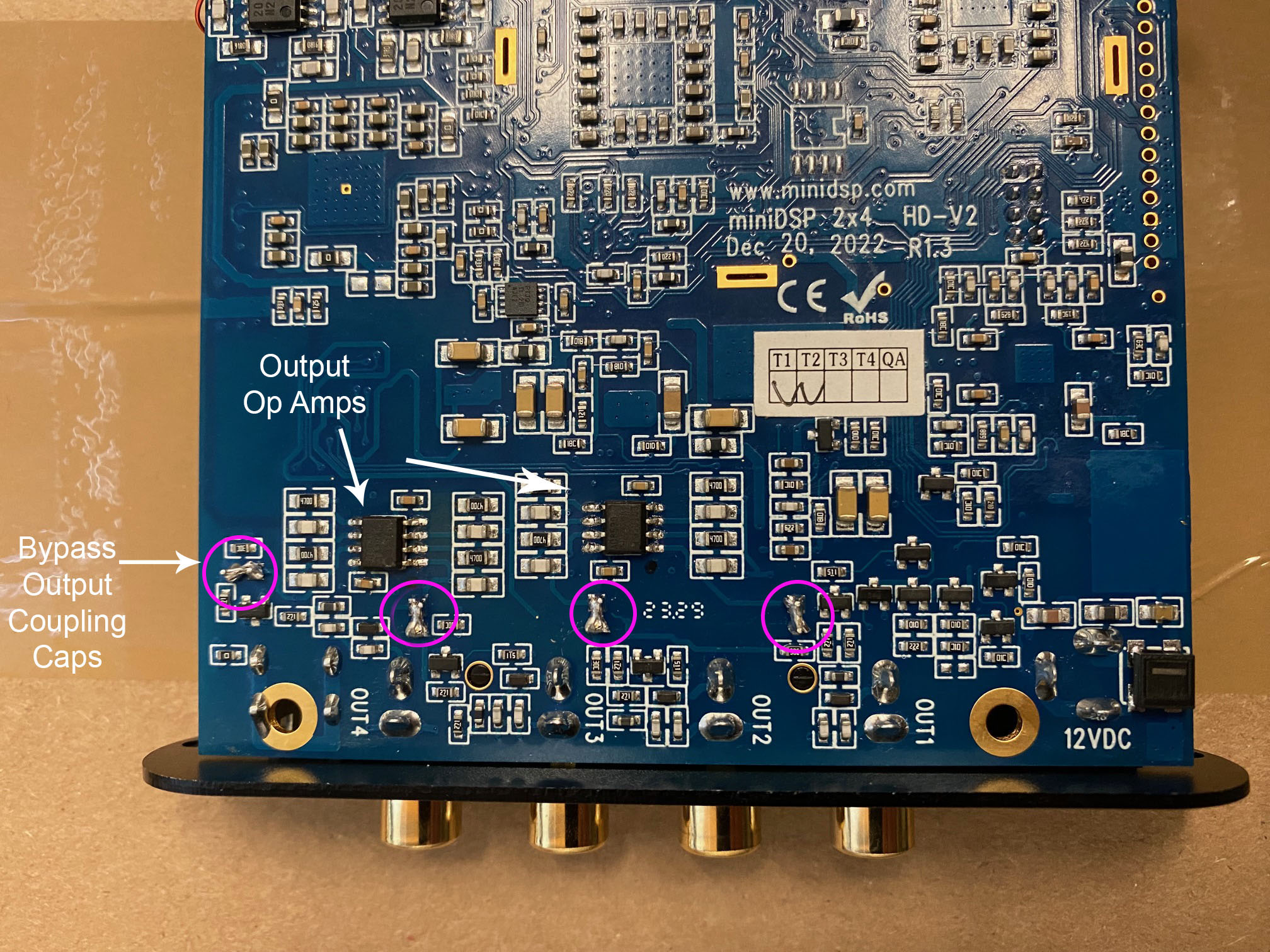

I have cap coupled power amps so I decided to check for DC offset and see if I could bypass the ceramic output caps. I got .001vdc on the active side of the ceramic output coupling caps which is close enough to 0 for me with amps that are already cap coupled. Make sure any tiny DC offset is not going to be an issue with your amps before bypassing the ceramic output caps. I just removed them, put a bare wire across the pads and soldered it in place. You can also see the opamps on the underside. I did adapters to DIP8 sockets on the PRV and its just not possible to do the adapters to change out opamps on the Mini so it's live with them or use a hot air station and change them out. I personally like the AD8599, AD8066ARM and LME49860 however the LME is optimized for higher supply voltages and that is what I am using in the PRV.

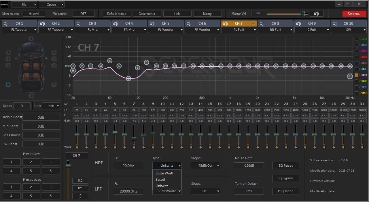

As a teaser here is the interface for the car audio based DSP's. The units with Ti DSP chip as well as the Cirrus DSP chips both share this 31 band PEQ interface with time delay and XO's for each channel, all XO slopes up to 48db are available as well as all 3 of the common alignments. They also support auto correction via mic! Noel Lee is using the Audio Dynamics setup ( same software interface) however they all seem to be made in China by a few manufacturers that I found on Alibaba. Several have amplifiers integrated using the TDA3116D2 class D chips and some are chip amps. I will post the PRV mods over the weekend.

My bad. Going on my notes from this project which said replaced the ceramic caps, but that was for the PRV. Which are c55 and c58

FYI, the Nichcon output (electrolytic) capacitors have really good distortion performance. In this application they're perfectly fine and needn't be removed.
You most likely have much worse offenders in your signal chain regards series capacitors. 🙂
An upgrade might be something in the Panasonic bipolar selection. (But even that would marginal.)

Dave,
it has been my experience that electrolytic capacitors don’t sound that great when used without a bias voltage. In this application, there is such a tiny amount of bias voltage that it’s clear that they just put these here as protection, in case, something fails versus having to block DC offset in the circuit.
Nevertheless, there is a clear boost in sonics when they are removed from the circuit. With that said, the input cap has a bias voltage and should not be removed. I bypassed the input caps with styrene caps which opened up the hf a touch. Unfortunately, there’s just not much space inside these to do high-end or exotic parts/capacitors, etc..

@dht 4 me Which software are you using here and what all did you have to do to interface directly with the car audio based board (e.g. serial / UART, BT)?
I assume from the earlier posts about PRV audio stuff that is what you are working with. I noticed a lot of these brands like PRV as you pointed out are resold under a dozen names. I actually ordered one of the "Expert" brand 8.2 which looks to be a re-layout of the PRV / Stemson 2.8, but I it was a little cheaper on Amazon and reviews of the BT smartphone software looked positive.
At the end of the day I am looking to have one or two 2-channel input DSPs to do active crossover testing, EQ, and possibly full FIR speaker / room correction and then I would hope to find a box based on these platforms that has at least 6 channels in and 8 out, though 8/12 would be truly optimal for my HT setup which has some active crossover front speakers (center is currently on a MiniDSP 2x4 HD and has a customer FIR filter from the driver manufacturer -- want to replicate this on L/R and subs) and the subs I am building really want very steep FIR based LP & HP (tapped horns that I want to get as close to a 25Hz brickwall filter and if used >80Hz will need high Q PEQ at a couple frequencies). I know car audio stuff is usually higher noise and meant for 4V, but I doubt anything competently made is noisier than the 2x4HD, though I have heard Dayton's rebranded Sure DSPs challenge that.
