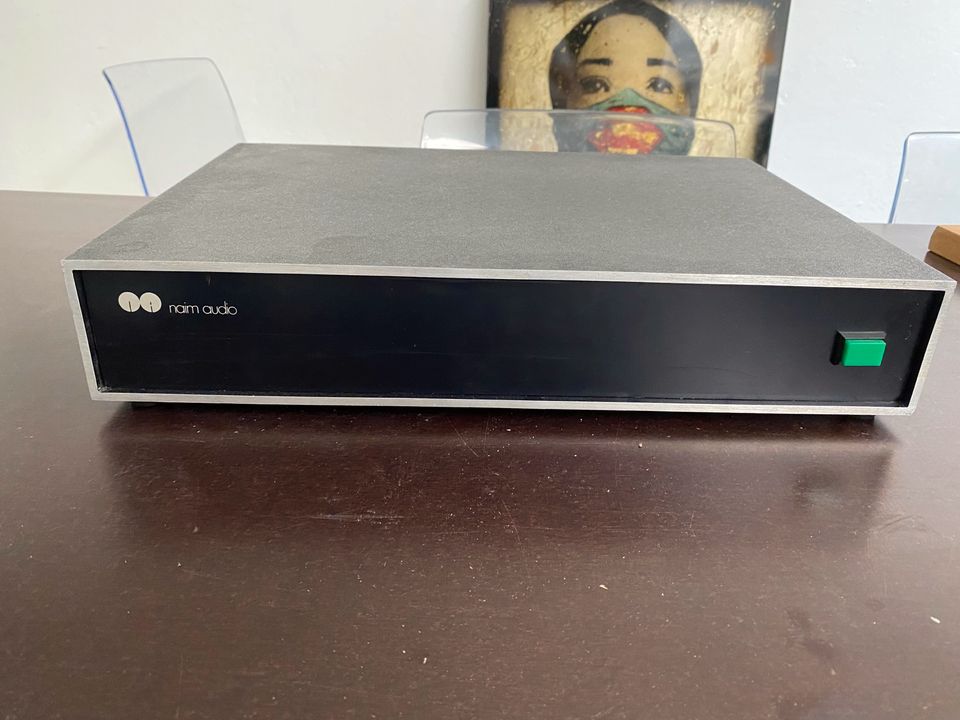

Good day
Dear gents
This experience is very interesting
I make the nap250 power reg without power transistors for headphone amp
And sound change 🙂
Also I trying connecting the lm317/337 to headphone amp but sound is not good.
Another side is nac preamp
Better sound with lm317 and not bad sound with nap250 power reg 🙂)
I think need try connecting the HI-CAP DR module for nac preamp..
In attachment 250 power reg in compact design for headphone amp

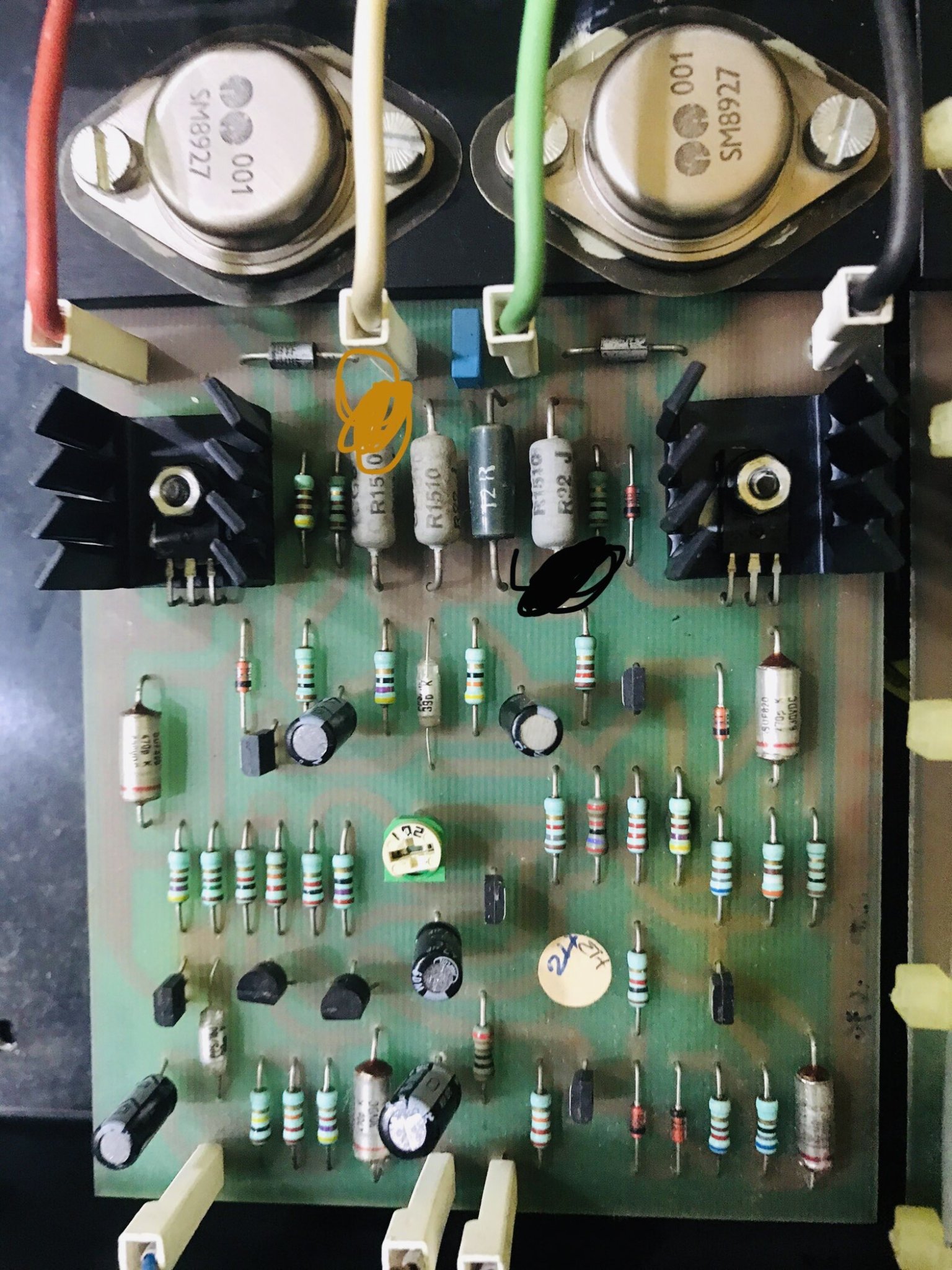

My prototype of Headphone amp in wood case with small NAP250 power reg module

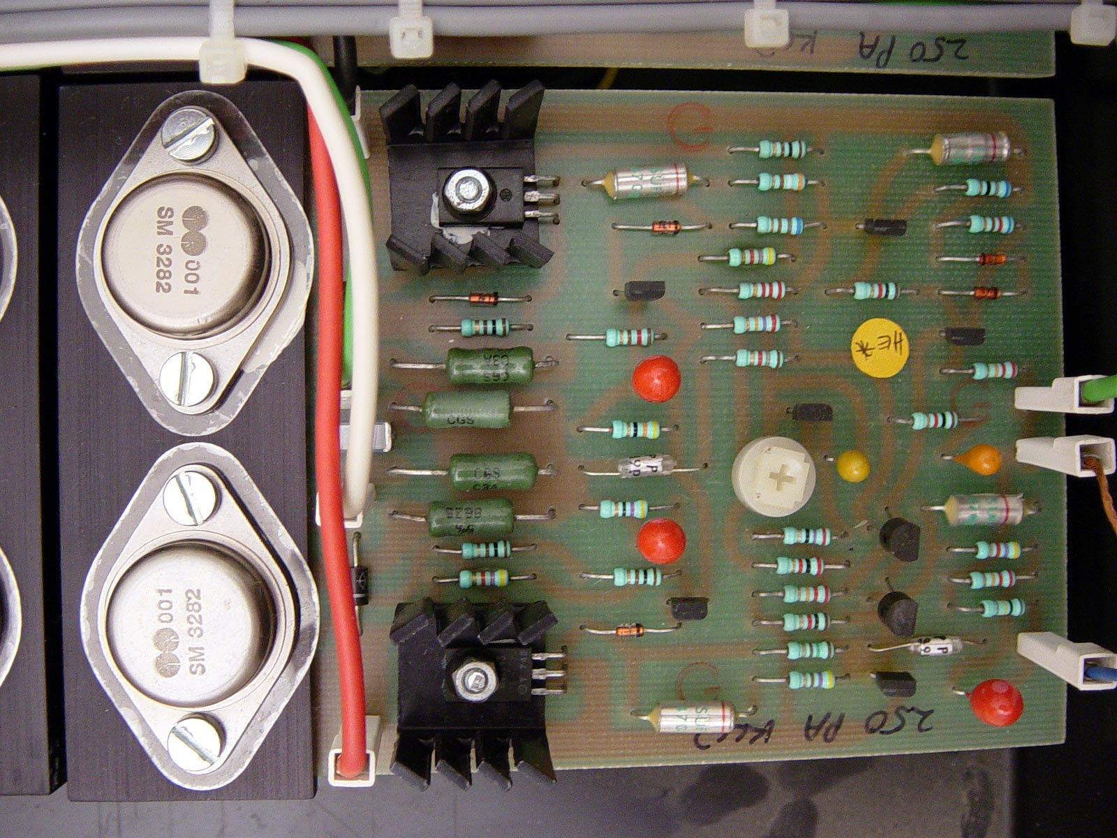

The NAP250.2 original board
I not turn on this because the board not have one transistor NA00
This new naim design is not have a protection circuit some like old NAP250
Also I check another NAP300 and NAPDR his not have protection circuit too
I think new engineers have very scary watching to old naim technologies

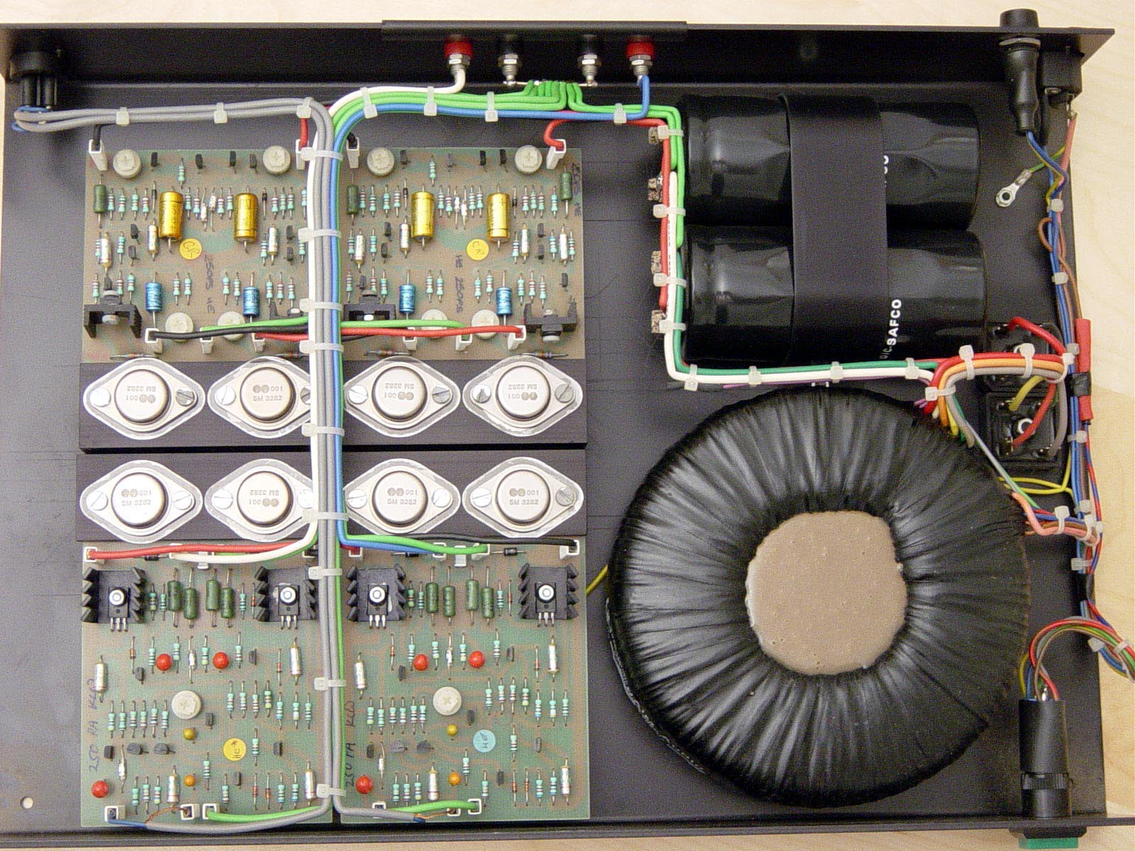

Answering the original question of this thread: yes I compared with and without regulation, see my postings in various NAP clone threads on this, and I also commented on Mundorf vs. Kemet smoothers in the PSU. I made new regulator boards recently and will post about them as soon as I completed some more tests...
Although capacitance is essence of what capacitor is, single most important property of any PS capacitor is impedance across the whole audio band. It should be very low......
Though, one property is not enough to determine if capacitor is best fit for an intended duty.
.........not only independent of the frequency (datasheet unfortunately mentioned the values mostly for two frequencies - 100Hz and 10KHz) but also independent of the peak currents (surge currents) that occur.
Most mid-range electrolytic capacitors are probably already superior to a voltage series regulator especially high-quality versions with screw terminals like those from SicSafco.
I can still remember a listening test, where the same types of capacitors with the same values were connected externally in parallel mode to the present small caps to the output of the voltage regulator on the NAP250 as already present at the input of the voltage regulator (interesting experiment - unfortunately not without risk of damage).
The inherent sound of the voltage regulator disappeared completely and the sound character changed in such a way that both the resolution and the holographic representation were significantly improved (same observations I had make on Linn's LK280 and Klout - both power amp devices operates with serial voltage regulators with small caps on the outputs).
Unfortunately this is very very laborious, because there are some additional steps necessary to avoid the destroy of the voltage regulator parts.
In series to the additional big caps in the voltage rails I introduce 1K resistors. After switch-on and waiting until charge of this caps was done, first listening test was carried out.
Second step before start second listening test was disconnect the speaker cables and shorting the 1K resistors in serial to the added caps and connect speakers again after several seconds (without switch-off and switch-on again !!!).
Before switch-off the power amp after this second listening test speaker cables must disconnect additional the additional capacitors (important, because otherwise the discharge of the additional big capacitors destroy the voltage regulator.
Now the question: what additional steps are necessary around the serial voltage regulator, so that capacitors with high capacity can be connected behind it without getting transients due charging current peaks and unwanted discharge currents during switching on and switching off ???
P.S.: the showed caps in the images are one of the best sounded I know (together with those from Mundorf's Mlytic HC and FTcap).
I agree on that because most voltage regulator designs took care only of ripple and were very lacking in transient response. Bad transient response is the source of specific “sound of voltage regulator”, while voltage regulator should be absolutely neutral. Large output capacitors can help there, but they can burn main regulating semiconductor with large initial charging current, if regulator was not designed to tolerate that.
Good voltage regulator should keep output changes in the sub single mV level during most extreme fast load demands from the amplifier. Such design would allow amplifier to present its maximum in reproduction details and soundstage. Results can be simply unbelievable.
It would be a very simple circuit with one power resistor connecting additional capacitor, bypassed by relay with desired RC time constant to bypass resistors after several seconds, or even by simple manual switch for quick testing.
