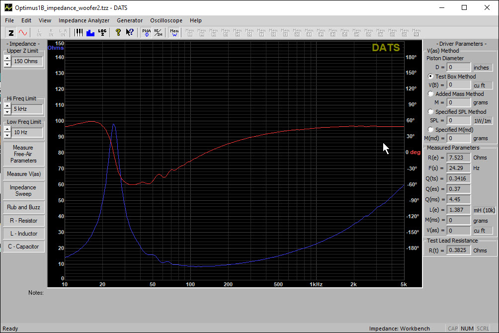

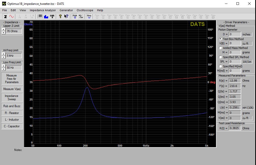

Sorry - missed that because I thought it was perhaps the modded one. Ok the woofer runs full range. Good way to save on costs for a large inductor but needs the woofer to mechanically. Is the XO circa 3k5?
Optimus 1B woofer and tweeter impedance, TS params

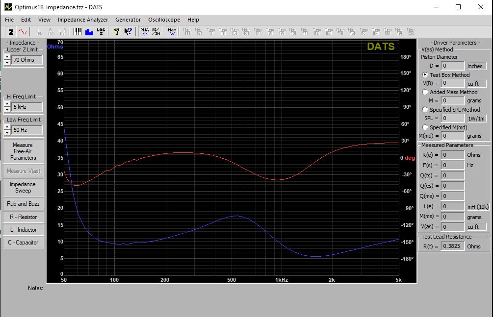

Forgot I used DATS V3 to measure impedance of woofer and tweeter and the overall impedance an amplifier would see.
Tweeter Fs = 210.6 Hz
The speaker impedance seems to be tube friendly.
New to using DATS so welcome any corrections.

Optimus 1B woofer impedance and response curve
Found second woofer in box and ran DATS to show curve down to 20Hz.
Also, ran frequency response curve with Omnimic with mic at 1 meter distance from speaker and at height of lower tweeter and tweeter level switch on speaker set to Normal. Speaker on stand 25 inches off floor.
Like I said, I am not a speaker designer and a little knowledge can be dangerous. So I'm not sure if I have this set up correctly for testing.

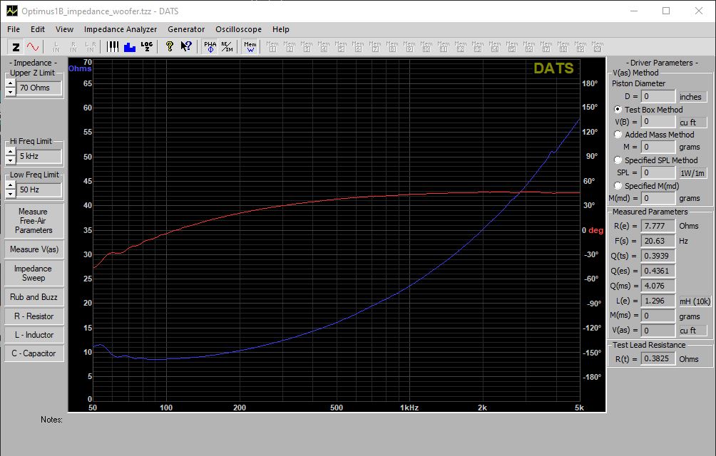

The woofer I found looks like the ones in the two speakers and has
Woofer 2510Aa Japan , written on the magnet so I assume its for an Optimus 1B although the parameters are not an exact match to the ones from the previous woofer I measured.

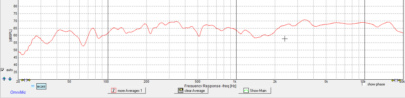

But from the response curve if the crossover is close to 1.4Khz should the woofer polarity be switched since its a 2nd order crossover on the tweeter?
