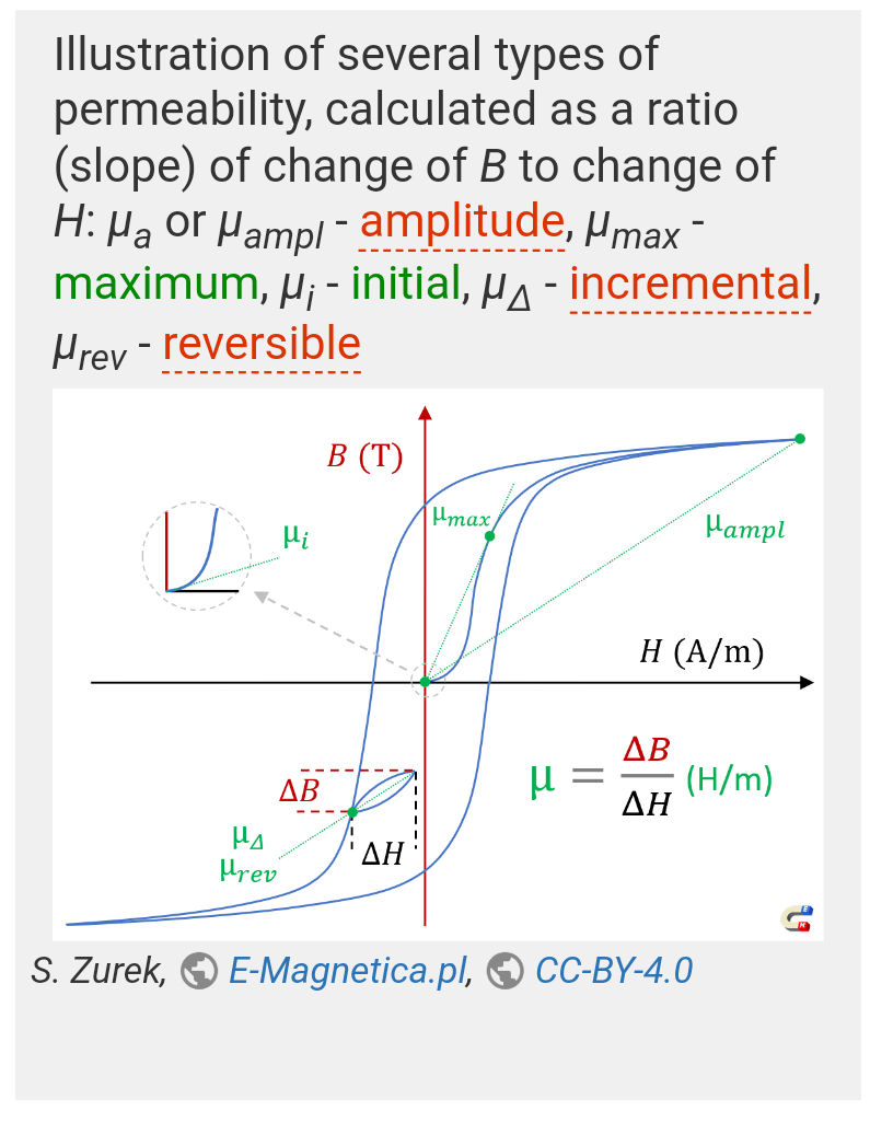

From a textbook:
Magnetic permeability
, μ (also written as mu) - a property of a given material or medium, quantifying its magnetic response of flux density B when subjected to magnetic field strength H.1)2) Magnetic permeability is proportional to the ratio of B and H changes: μ = ΔB/ΔH. Several different kinds of permeability can be defined, depending on the character of changes in B and H.
mu=dB/dH is the slope of the green curve in the following picture.
Small near demagnetized: initial mu.
Rising with magnetic field strength H.
Until max mu.
Falling again towards saturation.

In my DS it says 900H.
But what I don't understand is why the inductance varies with the measurement voltage.
I would think that inductance depends on the number of turns and the core parameters.
Do the core parameters vary with signal level and frequency?
As long as you stay within the reasonable linear part of the B/H curve, which you would, no?
Jan
I guess my assumptioni was a bit wrong 😉
What "linear" part of the BH curve you thinck you could use with the hugly varying levels in amplitude and frequencies of the audiosignal ?
Offcourse a magnetic core, and therefore the inductance, is extremly voltage and frequency dependend, especially if ungapped..
You must put an airgap in serial with the magnetic path to linearize.
But even in SE, with an airgap and dc-premagnetisation, you have to accept at least some 25-30% of signal dependend inductance variation if you want to have any reasonably inductance remaining.

From a textbook:
Until max mu.
That's a nice picture. I know that curve of course, but had always assumed that an audio xformer would operate in the linear part of it.
With changes in permeability of a factor 10 depending on level and frequency, that must be seriously nonlinear.
Why do people still build amplifiers with output transformers?? For sentimental reasons?
You are right: the sentimental factor is very strong, especially nowadays. But the nonlinearity can reduce by relatively low driver impedance and the "state of the art" core materials. The core magnetizing causes additional current component, parallel the main current. If the core permeability is enough great, the additional current component will small. The small component's nonlinearity can't generate big distortion. Better situation is the huge permeability AND linear B-H curve (for example nanocrystalline material). Similar situation can see at the low generator impedance: the distortion's EMF will shunted by driver. In the end, the distortion will be smaller than one would expect from the B-H curves at first glance.
