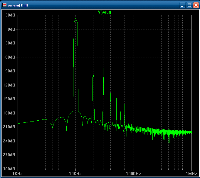

In the FFT's below -
#1 - is the mighty class A genesis FFT.

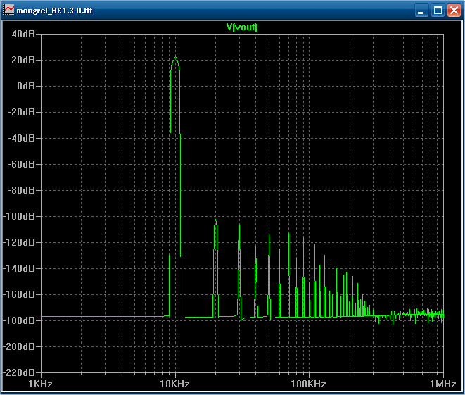

#2 - BX / "blameES" FFT with cascode/low noise inputs (was just born ,am listening WOW!! )

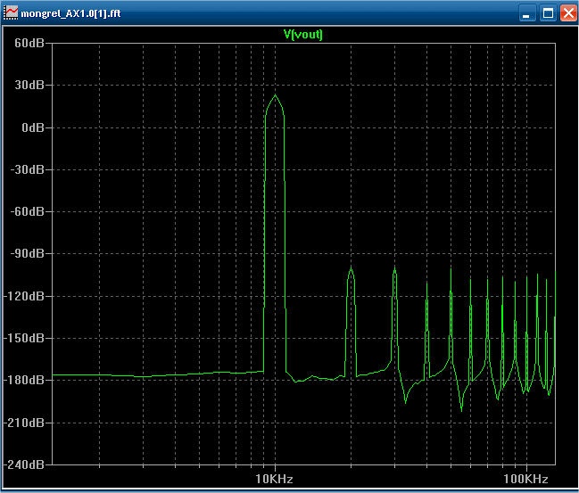

#3 - AX / "blameless" FFT - making this just to have a 2'nd pair of amps.

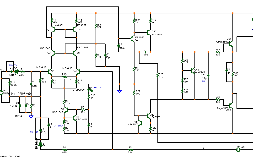

#4 - AX schematic - a baseline design for TMC.
The simulations were not "rigged" . I use fairchild models and NO ideal sources except Voltage. So you see all the nasty interactions of the real simulated CCS's , Vbe , cascodes , etc. With ideal sources i would most likely be down to PPB! 40v p-p/ 10khz is standard with AB outputs biased to 80ma.
The Class A FFT is interesting as it has NO harmonics after H7 (sweet) , it was the best I have seen even as it has a dominant 3'rd. A single ended (as opposed to a push pull (genesis) would most likely have a dominant 2'nd. Still , One damn pure OPS .... I have heard it - even pushing 200W. 😱
Just look at #2 , I still haven't gotten used to it. A ghost sound will come out of the cracks in the wall and scare you half to death. It (bX/blame-es) , for some reason beats the current sourced "blameless" , that FFT is way below a part per million , billion. I do think to quality of the bootstrap is crucial here , I use a panasonic EE series ... which is as close to ideal as can be found economically.
#3 and 4 , I am going to see why TMC on a current source can not match the performance mentioned above. What you would hear on 3/4 looks very similar to the genesis FFT wise (harmonics are similar).
These beat any Class A design by a major margin .... #2 at .5ppm at 10khz- 50w , even if the sim is off by a factor of a hundred .. way better than most. Differential noise is more of a concern than any of this.
