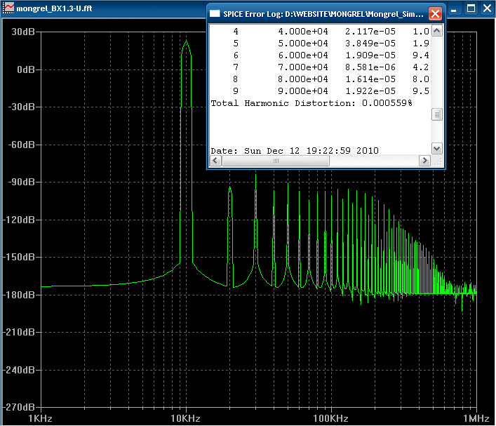

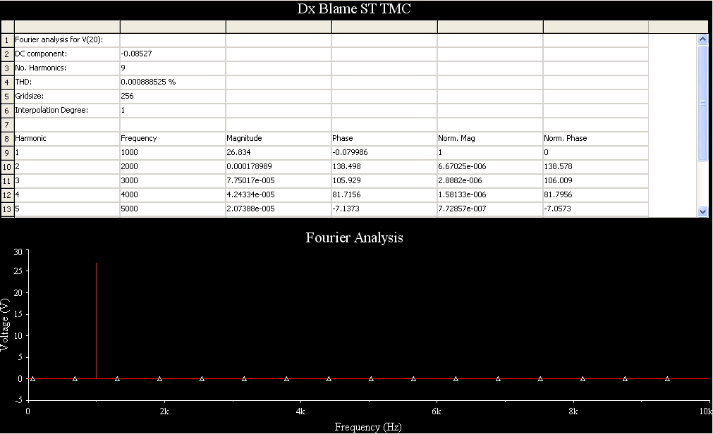

Real "no brainer" , add the 2 caps and 1 resistor, have 1/10 the total THD , much less at HF. An added bonus of really cutting out the odd harmonics , regardless of topology. I think this is the result of negating the output stage Xover distortion (H3/5/7/9).
A TMC applied AB amp has the output spectra of some of the larger Class A output stages I have worked on / simulated / repaired ... (genesis stealth). Output FFT also matches the Vout FFT of the class A standard EF2 driver stage ... so you are essentially listening to a faithful representation of your VAS. 😎
Quite any easy decision to add 1 more cap / resistor to achieve a tenfold improvement. PIX 1 = no tmc # 2= TMC 100pF/270pF - 470 R network.

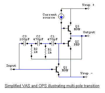

:2c: Seems to me that TMC can be improved by using a multi-pole transition.
I'm not sure it's worth the extra R and C, but in another thread I noticed a lot of scorn being heaped on a TMC implementation with equal value capacitors, so I figured anyone who get's that upset about losing 4 or 5 dB loop gain may be interested in gaining an extra 20 or so...

Hi Godfrey,
I suppose you are referring to me as the one who got 'upset' by that stupidity. Not only the distortion is two times higher with equal caps, but also the slew rate is degraded to half of its original value. Totally unacceptable, in particular from someone who should should have known better.
Anyhow, I'm sorry to say so, but your suggestion doesn't work, at least not in the that way. Nevertheless there is still room for improvement:
