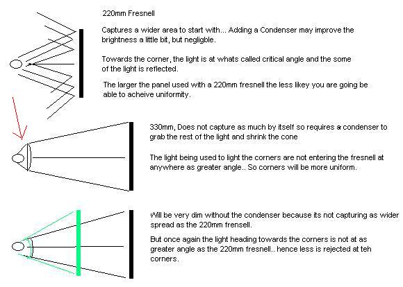

ELiTeHaYDeN, reflection is only part of the problem. All that happens when you use a longer FL fresnel or smaller LCD and a pre-condenser is move the problem to a different location. The same angles and ratios are now moved to the pre-condenser.

the arc will come from the same point for the fresnell (focal point) but the lamp will be virtually larger.
A pre-condenser lens will do 2 things to the arc:
1) make it virtually larger
2) make it look farther.
i can xpalin it to you in terms of math if you want.

yes, we have to do it that way (mean conbining the focal lenght on the pre-condenser lens and the placemt so the virtual light is at fresnells focal point exactly. I agree with it. But look that the virtual arc is larger than the real arc, (that is not a good thing at all)

Dazzzla said:
Rox ray trace that virtual arc through the fresnel to the objective lens and compare its size to the arc coming from the rear fresnel’s FL.
DJ
Sorry i don´t follow you.
Do you mean to compare the arc size on the objetive lens of the setup with the pre-condenser lens and the setup without the precondenser lens?
setup 1) arc 220/330
setup 2) arc pre-cond 330/330
so i can compare the two arcs on the lens ,is this what you mean?
A bit more info for what I’m suggesting for a modified pre-condenser, An normal aspheric condenser has been modified to make the rays coming from the outer edges of the lens to focus further than a un-modified lens, if we could get a lens modified so that the outer rays focus closer than it’s FL then when used as a pre-condenser the resulting light should be more concentrated at the outer edges of the rear fresnel. I think this would be a much better solution than wasting the light from the centre by blocking it.
