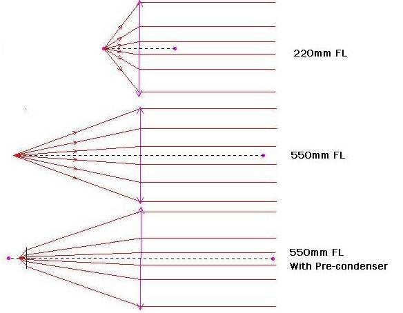

I use-to think the same thing. I think the key to getting uniform lighting is all in the pre-condenser, not the actual size of the LCD. There was a thread on diybuildergroup recently where Guy suggested using a 550mm FL rear fresnel to improve dim corners. If it were used with out a pre-condenser then it would improve the dim corners at the expense of light output. Basically using a 550mmFLfresnel on a 15” LCD is just a scaled up version of a 7” LCD with a 330mm FL fresnel. When I did a rough raytrace of this dim corners were not improved.
Here is a copy of my post at diybuildergroup.
I've done some rough ray traces with a 220mmFL fresnel, a 550mm fresnel and a 550mm FL fresnel with a pre-condenser. When the pre-condenser is added the light distribution changes back to the same as a plain 220mm FL fresnel. So it appears as though there is no advantage in using a set up like this. The only thing that I suspect could improve dim corners is the spherical aberration introduced by the pre-condenser. So we'll have to wait until Guy finds some time to do a test or perhaps if I get my projector up and running and make a simple LDR meter, to find out if it improves.

My Point is that dim corners that are a result of the inverse square law will affect ALL LCD sizes the same. An example would be to take a 7” LCD and matching a fresnel with the lamp at 1 meter away. The resulting image light uniformity would be very good but it would be dim. Now if we place a plain spherical pre-condenser close to the lamp, so that more light can be collected and it was ABERRATION FREE, then it would be no better in terms of dim corners than a 17”lcd with the lamp at 220mm. The key to better light uniformity is in the pre-condenser’s aberration or in the reflector’s aberrations. If we could get an anti-aspherically corrected pre-condenser, if these existed, then they should improve dim corners.
I’ve heard Trev talk about using an all parallel light engine but I’m unsure how he is intending to implement it or whether it will be effected in the same way, hint hint.

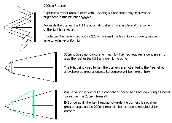

As i understood it, the main reason one cannot acheive a uniform lit LCD(15") with a 220mm was because as the light reaches the corners it is approaching critical angle/ the angle of which light is reflected... So alot of the light is being reflected by the fresnell, if you replace the 220mm with a 330mm fresnell and matching longer focal condensor this will be alot better at the exspense of a little bit of brightness(this is reduced if you use the right condensor)
Reducing the LCD size has the same effect as using a longer focal fresnell.
So.. i think the best solution is to find some way of lighting the lcd without the fresnell, eg, a eliptical reflector, but once again, the angle of the light hitting the corners is going to be the same as it was hitting the fresnell.. and perhaps even dimmer because the LCD is more reflective...
If this is the case then theres only one way to get a uniform image! - smaller LCD.
Example.
Example.

But remenber that introducing a pre-condensor lens, will virtually icrease the arc lenght on the bulb and this is also negative. Could be that the arc lengh is so big that the light is not entering the projection lens, also the light will be more difficult to manage. So let´s study every case slowly before doing anything.
