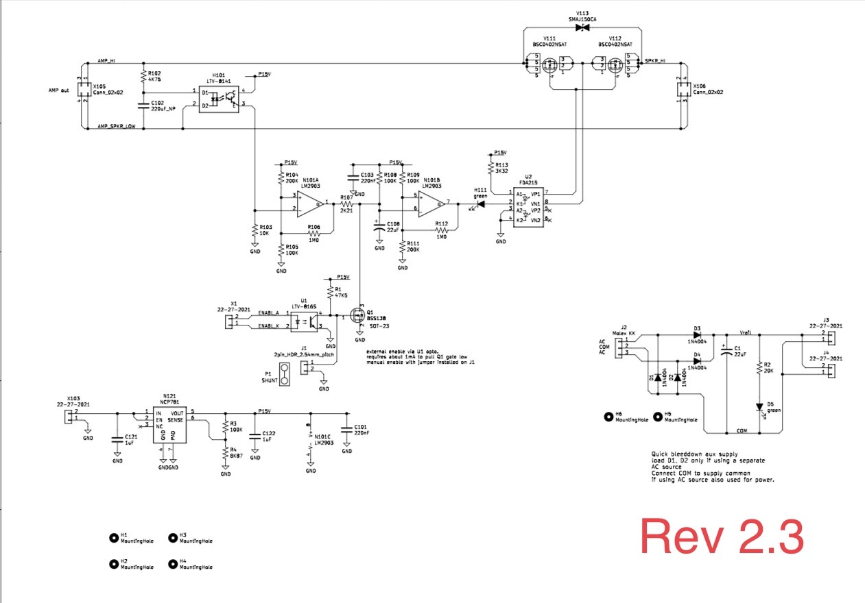

Hi
please confirm
For fast switch of i read in post 822,894,939 that it is needed that the extra pcb has to be soldered just D1, D2 a 22µF cap and a LED with resistor and connect J2 to the secondary of the transformer
J3 to one channel at the connector X1 SSR
J4 to the other channel at the connector X1 SSR
in post 947 is written that the COM at a secondary without center tap has not to be connected
kr
chris
please confirm
kr
chris
See note next to small PSU. If using same secondary as main power amp do not load D1 and D2. Connect to X103 for DC input. X1 is used for external logic control. For standalone operation use jumper on X1. Pin 2 on J2 of PSU board goes to GND of amp PSU.
THX XRK
oh...now i am confused. ....sorry
because i see your video and i thought that is that PCB.
this quick shut down PCB is not included in the kit? right?
i need this circuit which i can shut down in between 100ms, as described in your video and in 894
If you have access to your main trafo secondary (AC input to your SLB), use that to power the simple low capacitance PSU board that comes with the RTR SSR. It needs 2 1n400x diodes, a 22uF cap, an optional LED and current limiting resistor for LED to get 2mA. This simple PSU will cut power to SSR in 100ms after power off and it disconnects speakers immediately to prevent turn off thump. It will act like a wire when on so no more noise emitted than a speaker wire. So what ever precautions you keep your cinemag trafo quiet is good but I don’t think it’s inherently noisy
kr
chris
kr
chris
is use the X103 at the SSR board via cap bank as source and power source.
it is possible to use the AC/DC converter from mean well (1W) to power up 2 SSR pcb.
AC/DC converter 42mA -24V (1W)
digikey :
1866-2994-ND
digikey :
1866-2994-ND
that is your video...at this pcb 2 additionally transistors are on board.
your video for the fast shut down
so i want to shut down as quick as in the video 😉
