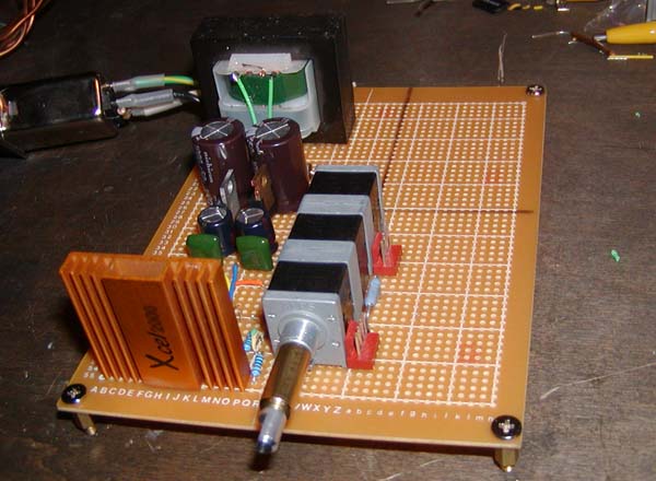

I have a question about the output resistor as well.
I have built an ad815 headphone/preamp based on carlos circuit but with 2.2k/1k feedback resistors (a bit more gain and resistors i had at hand)
when used as a preamp it is for my powered monitors (event 20/20 modified with 3886/3875 GC amplifiers) it is to replace a horrible digital mixer (tascam tmd 1000) which is now between the source (EMU 0404 modified) and the monitors.
right now i am just using it with headphones to test it (wow!) but i was wondering if i should
a: leave out the resistor when using with phones (senheiser HD25)
b: modify the input of the amplifiers to a lower impedance or put a resistor in the interconnects at the amp end.
it does go plenty loud with the resistor in the circuit but the phones are 70 ohm anyways it should might not be neccesary
affects damping more than the benifit of less distortion with higher output impedance?

I doubt that you can hear any difference, when using the AD815 as a line pre.
But if you are driving headphones yes, you will hear the difference.
jaudio said:I tested 33 to 14ohm and you can clearly hear the differents.
Neutron,
The output resistors are fine for a line preamp.
You can use anything between 10R~50R.
But for driving headphones is a different story, if you must use a resistor (I would) then use a small value, like 1R.
