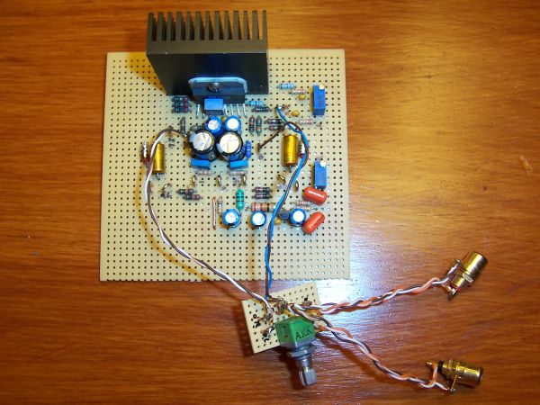

33 ohms on this one

I asked this because your 815 operates as a buffer and there is a different in loudness bewteen a 22ohm and 33ohms
This is my third board. I have used 47 ohms, 80 ohms, and now 33. Since this resistor is outside the feedback loop, I only thought it was setting the output impedance.
My amp is 100k, was not concerned. Got some 16 ohm, will they make it a little louder?

I am not too worried about using the resistor as a damper, so about any value should be okay.
Were there any sound quality changes? I only used the 80 ohm becuase it was the lowest value I had with me the night I built the first buffer board. I did not like it as much as the one with gain initially. Might have been this higher value output resistor. I thought it was the ceramic caps used on the snubbers.
I have some 16 ohm, these might be better than the 33 or 22. Mine does not really need any more volume. The highest it has been turned up is maybe a hair past half rotation. This was about live music levels, 95 - 100 dB. This is why I wanted a buffer and not one with gain. The version I built with gain would never have gone to half open.
I think volume pots sound better when cranked open a bit, less series resistance.
