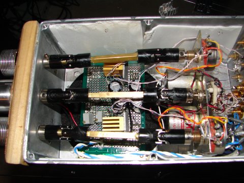

This thread has been dormant too long. Installed the dual chip circuit board in the chassis earlier this week. After a couple of days running and several power up and down cycles it is working really well.
Several items on the new board. Only using one chip side in each. The unused side is has a feedback resistor and 1K resisitor from NI input to ground. The offset nulling circuit is not connected to the unused side.
The power supply is in another box, there is a pair of 6800 ufd FM caps, with snubbers, then a pair of 1000 ufd ZL on each chip with snubbers. Finally 100 ufd ZA caps soldered straight to the power pins of the AD815's.

I may be dreaming, but it sounds even smoother and the one before that used one AD815. A couple of other things were changed, so it may not just be my imagination.
I have heard several 5,000.00 - 10,000.00 commercial linestages at my house. This simple circuit beats them. It is fleshier sounding, with deeper taunt bass. The highs are very extended. There seems to be more wrinkles in the soundstage. The low level artifacts and minute details are exposed more clearly.
Love this thing.
George

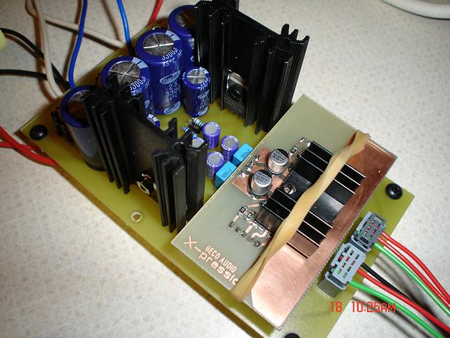

I finally managed to get the AD815 up and running yesterday, Rudi kindly sent me the pcb files so I could get it etched.
Its the version using the servo for the nulling
I'll have another go at Carlos original nulling circuit, my first attempt it gave me a few problems but I'll have a look at it later, it would be nice to compare them just to see if the servo does have an influence on the sound
I've tried the the AD815 with three of my amps
My-RefC
UCD180
AvondaleNCC200
It works well with them all but seemed to work extremely well with the AvondaleNCC200, the sound is very impressive, the bass was explosve with some tracks:devilr:
The sound is also very clear and detailed🙂 I'm going to spend some more time listening to it today, it could also do with a few more hours running in but so far I'd say these are very good pre-amps, I've also got a highly modded super regged Air-Guitar pre to use as a reference, this is based on the Naim pre-amps.
A big thank you to Carlos and Rudi😎
