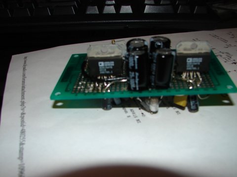

Dual AD815 Circuit
I loved my buffer after dialing it in a little. So never to leave it alone, I built this one using two AD815's. The unused channel in each has a 562 ohm feedback resistor and a 1K resistor tying non-inverting input to ground.
George
George
Just needs some heatsinks.
To fit on my modular board, the power supply had to go in the middle. This helped a little.
The heatsink used in the stereo version playing fit not fit here. Going to hacksaw up a couple to allow checking.
Even if it does not sound any better than the stereo version, this was six hours well spent. This in my mind is close to optimized for my system, I can move on to another component in the chain.

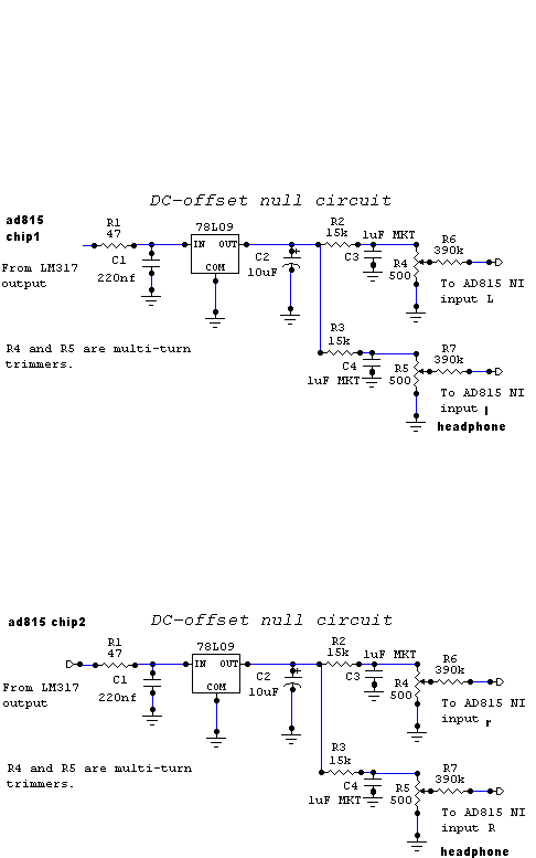

Concept Question
I built this voltage nulling circuit to help control input and output offset. It also alows this circuit to work wonderffully in my system.
Looking at it, there is a voltage divider between the 15K resistor and the 500 ohm pot. This will result in a maximum voltage on the 390K resistor of 0.33 volts above ground reference.
This 390K resistor is functioning as a buffer to prevent AC under it from modulating back into the power supply. This is the function also of a drain resistor or plate resistor in a voltage amp circuit.
With a maximum voltage across this resistor so low, how does this not modulate when say a 2 volt signal is applied at the bottom of the 390K resistor?
I got to say, if it is modulating and screwing with the sonics I cannot hear it. Maybe I have not turned up the input level near high enough.
Carlos, you as the designer, what is the reasoning here for why it operates so well? I must be missing something on how this nulling circuit interacts with the AD815.

jaudio said:Carlos
This is what I have
Then you have independent dc null circuits, after all.
It just hit me that efectively it will not work at all, even this way.
Because you are joining both NI (per channel) inputs on the volume pot.
So, you are indeed affecting both channels.
I would suggest you to use a small input coupling cap for the headamp seccions. You must have 100k resistor to ground on each chip channel (not one for both halfs of the chip). Before this resistor, on the headamp halfs, put a 470nF MKP cap.

Panelhead said:Carlos, you as the designer...
Yes, Sir!
Panelhead said:...what is the reasoning here for why it operates so well? I must be missing something on how this nulling circuit interacts with the AD815.
I've chosen a high value resistor (hundreds of k) so that it didn't increase crosstalk between channels.
That's all.

carlosfm said:
No, don't cascade them.
The pot feeds the two halfs of the AD815 (one channel), and use ~200k instead of 100k for R3.
Don't forget to adjust DC-offset on the headphone amp with the same load as your headphones.
Excuse the earlier post,I was typing it while you posted you response
Ok change the 200k resistor to 100k?
Put a small cap at headphone input instead of at output?
If I use the small cap at input will i still be able to use the null circuit?
jaudio said:Ok change the 200k resistor to 100k?
Where do you have 200k resistor?
I mean, look at my schematic.
You need R3 (100k) one each amplifier stage, don't mix this with the two halfs of the chip.
So, you need 4x 100k resistors.
jaudio said:Put a small cap at headphone input instead of at output?
Yes. At the input you will use a small, good quality cap.
At the output, for the headphone seccion, you would need a big electrolythic.
jaudio said:If I use the small cap at input will i still be able to use the null circuit?
Use an input cap on the headphone amp seccions and adjust dc offset on the output with the dc null circuit.
With the input cap, these headphone amp seccions will be 'isolated' from the line preamp seccions, this way you will be able to adjust dc offset independently on the 4 channels.
Cool, no?

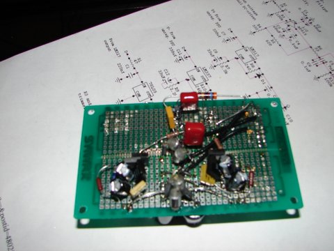

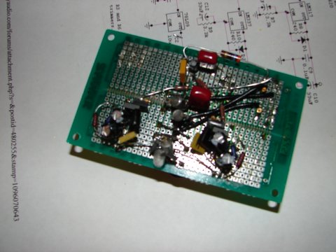

I just found some .27uf caps. (bewteen the wires and the pink and yellow caps)
Now,I will have to leave them standing upright and unsecured or put them on the board with the optional output caps(two outputs one with caps and one without)the green caps will be removed. Will there be a problem running input and output so close.
The layout is giving me h*ll
jaudio said:Will there be a problem running input and output so close.
The problem is all those unshielded wires running so close to each others.
