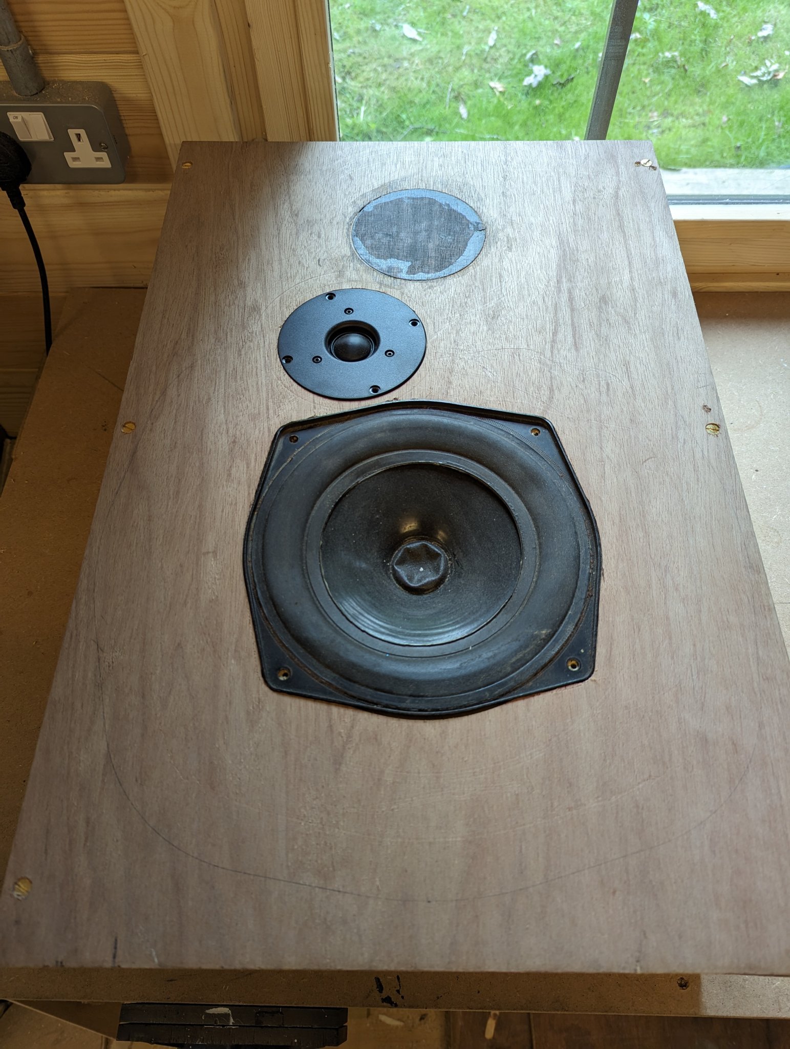

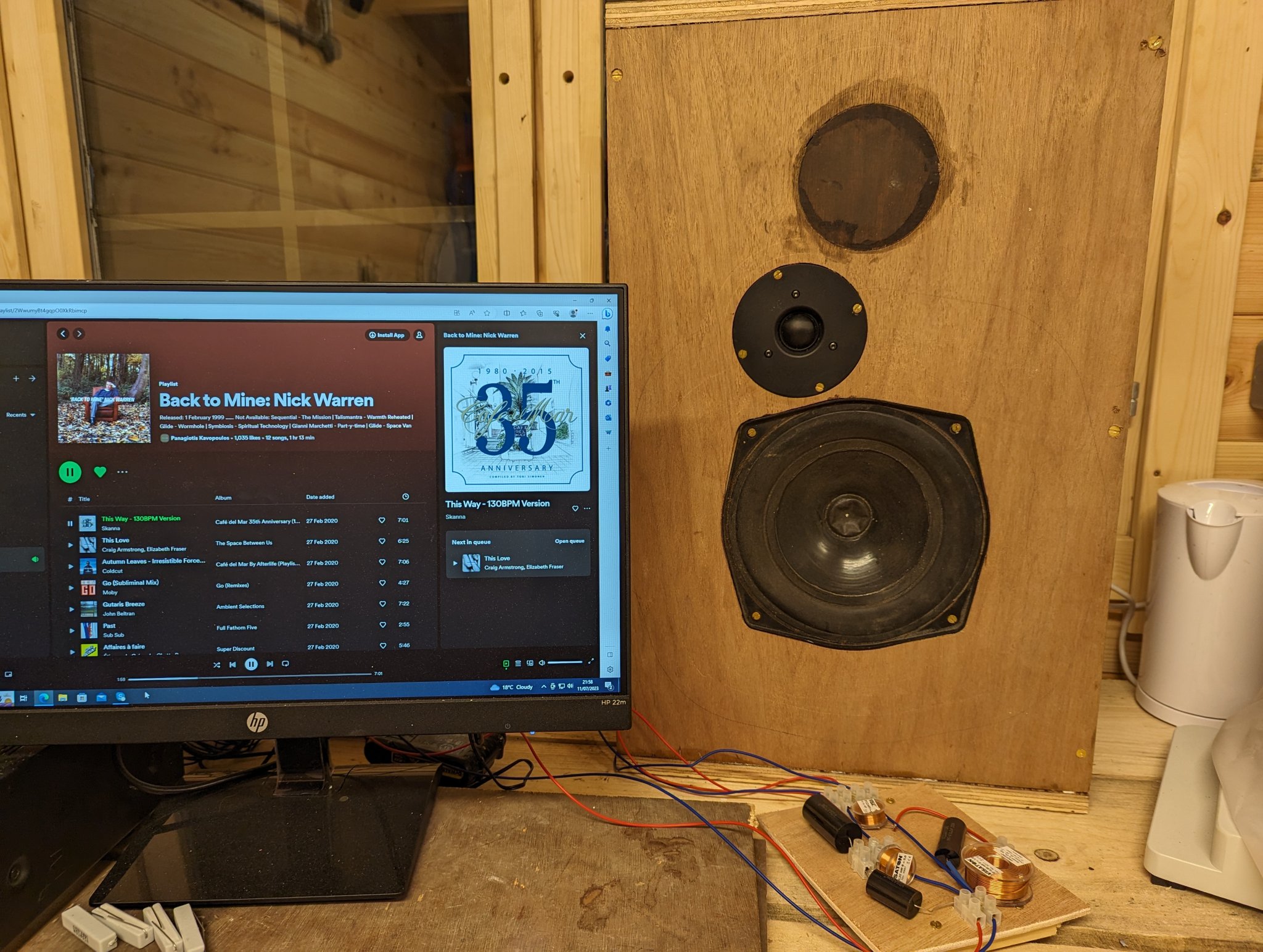

Much better.
Really hard to do, but i would try to fix the dust cap a bit, or remove and add a phase plug.
These are not easy to do and it will not be pretty (but likely better than now). This will require a sharp needle and some ModPodge (Or almost any PVA given how little is needed).
