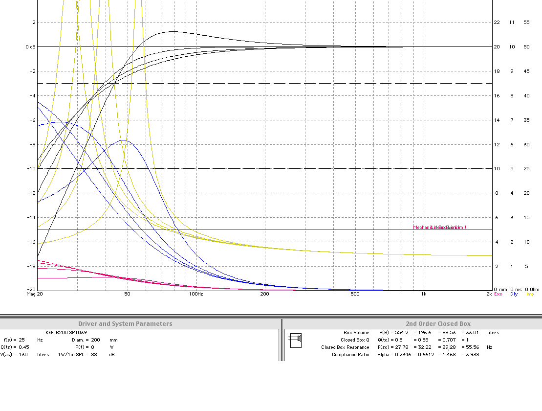

I was going to ask for suggestions for a tweeter to accompany the SP1039, but my first stumbling block is the enclosure. The data sheet for the SP1039 indicates typical enclosure volumes of 20-25 litres for a closed box, and 30-40 litres for a reflex cabinet. However, playing with online calculators suggests a need for larger volumes. I presume I am making a basic error, but I can't fathom it, so any pointers would be appreciated.
I used this site https://www.diyaudioandvideo.com/Calculator/SpeakerBoxEnclosure/
If I enter the data sheet values (Vas 130 litres, Fs 25 Hz, Qtotal 0.45) and a system Q of 0.707, I get given a volume of 88.5 litres for a sealed box.
If I enter the effective diameter of the driver (about 16cm) and calculate a ported box, the suggestion is 186 litres.
Clearly these are way off what the data sheet suggest. So, please someone put me out of my misery, where am I going wrong?

For a vented enclosure using D B. Keele's ammendments* for typical losses, I calculate that 123 litres of internal volume suits the published T & S parameters supplied by KEF. * Vb = Vas/1.06

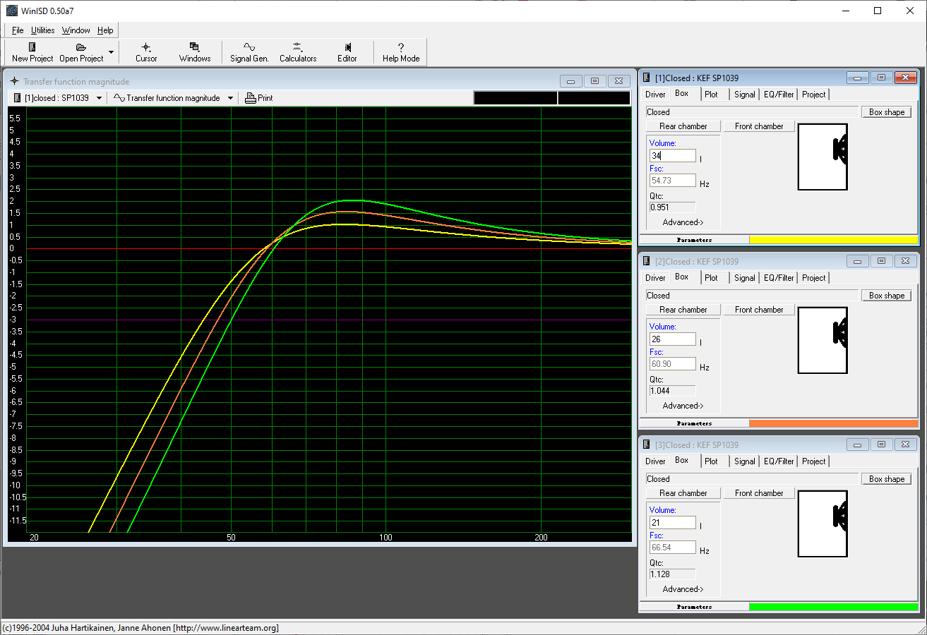

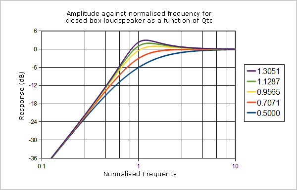

Go for a higher Qtc of 1.1 and you'll get a sealed box volume of 26 litres.
You can engineer for a Qtc that is beween 0.7 and about 1.0 or slightly greater.
A Qtc of 1.1 will give you slightly accentuated bass - good if you like rock music!

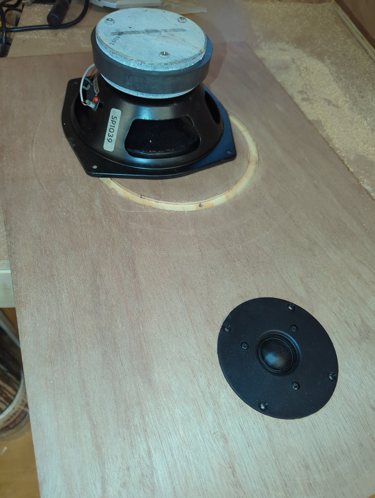

Cabinet cut from leftover 18mm marine ply, partly put together with glue and pocket screws. I've routed a rebate for the tweeter (Scanspeak 92200) using a simple jig to do circles and it fits nicely. i've done the same for the SP1039 woofer but it's a funny shape so need to add the 'corners' for it. Any simple way of achieving a good match to these corners? I don't have and can't find locally a top bearing router bit, which might have helped. Is it a case of doing this by eye?

Galu, thank you. I have routed a circular rebate, but the baffle is still otherwise intact, no hole yet. Yes, just looking to extend the rebate into those corner extensions neatly using my handheld plunge router. I think the proper way would involve a router bit with a top bearing and use of a template, but I haven't been able to get one that fits my router. Just wondering if there is some trick / jig I might be missing.

33 litres. My ply offcut was 38cm wide, so I went with that for the baffle width, and half that for the depth. 0.6 m high was as big as I could go with what I had. Qtc=1 at this volume so it worked out well.

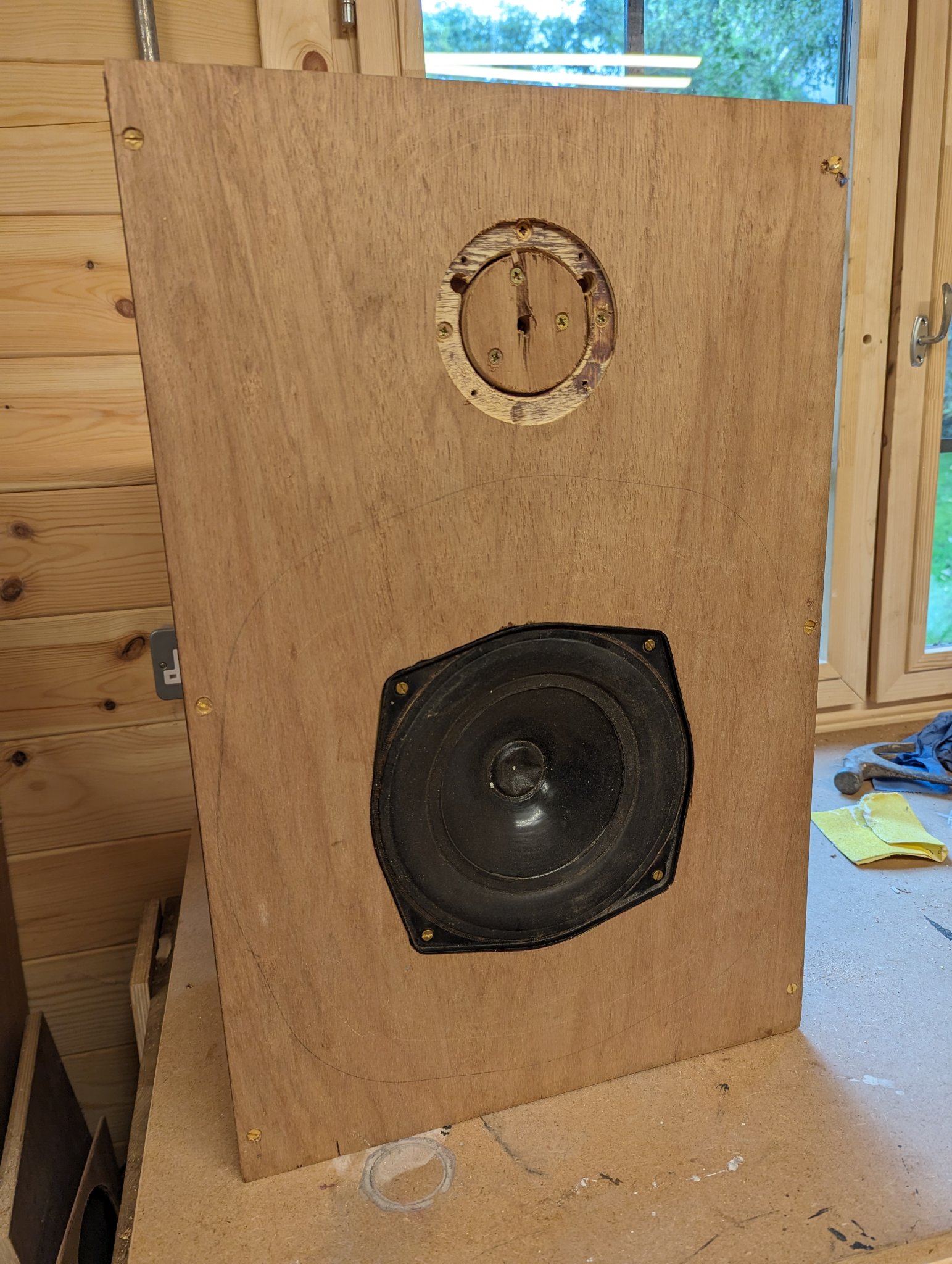

Damn it! I core drilled out the hole for the tweeter, so I could re plug it, bit of wood filler, perhaps glue an oversize piece internally for some bracing, and a nice paint job to cover up the mess! 😂. If so do, is it worth also moving to the 11 o'clock position, as I read somewhere could be of some benefit?
