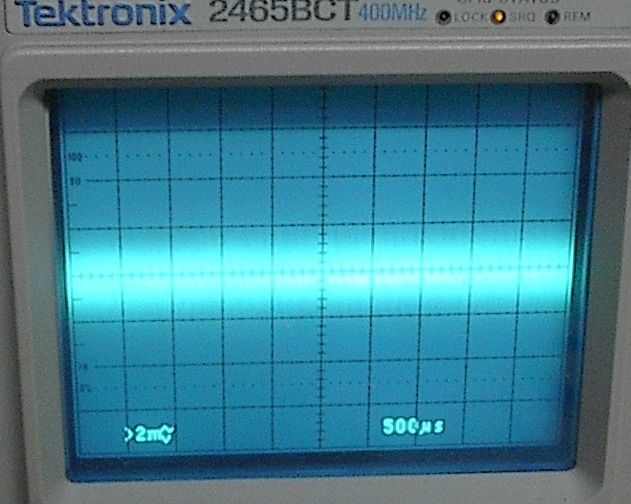

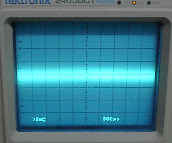

Noise. Here's how much noise there is in the operating jig. This is with the mic preamp connected to the LM3886 which is connected to my shop speaker. No mic connected.
Hi John,
The 'scope will not tell you very much at all. Connect the HP to it and look for real answers. Oscilloscopes are not known to be terribly sensitive instruments. Also, you can't pick anything out of the noise there.
I'm not saying you will find noise, I'm just suggesting a better instrument for the job.
With any luck, I might be getting a working HP 3585A some day soon. I did pick up an HP 3580A (early) that doesn't work well. Can't use it. The 3562A is the other instrument I really, really want to pick up. Some day.
-Chris
Hi Chris,
The scope is the only thing I have, other than my ears. Usually, when my ears hear no noise, I don't bother to connect the scope. It's hard to quantify what I hear though (they are MY ears, after all 🙂 )
The scope will show the magnitude of any noise that's being produced. In this case, about 2mV peak.
All things considered, thats pretty good.

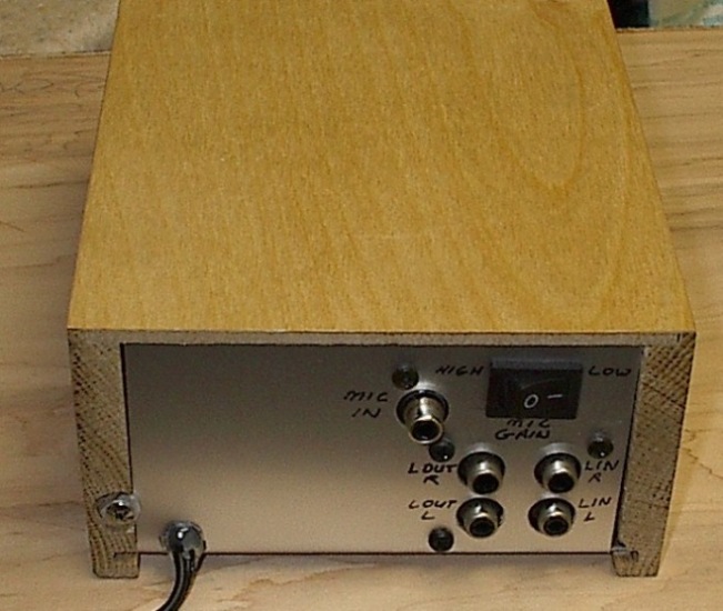

This post needs a pic 🙂
Here's the back of the completed unit. Labeled the jacks and switch by hand with a sharpie.

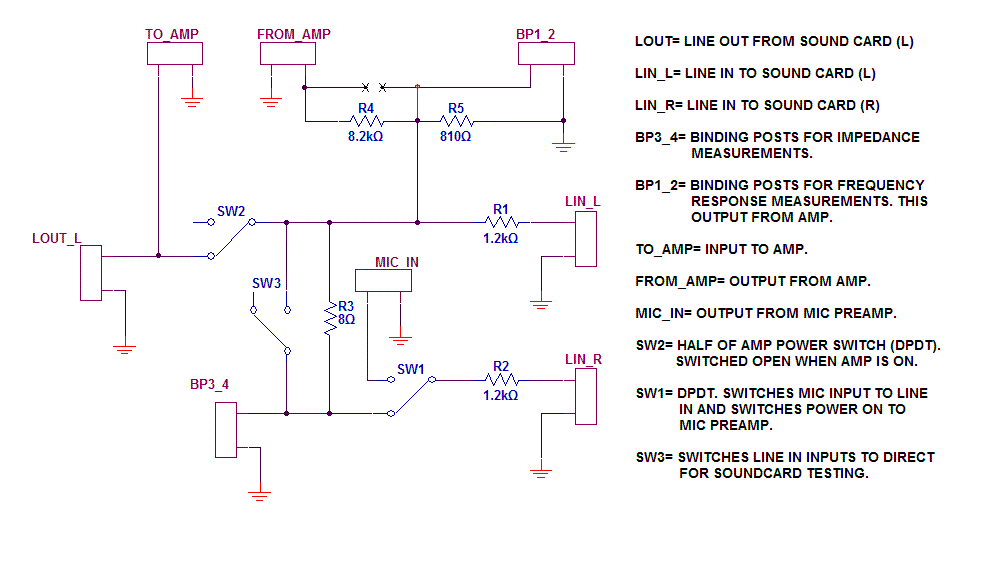

I wish I could claim genius on my part but it's really simple! Look at the schematic I posted on the first page: the top switch position of SW2A connects the soundcard output to the active crossover input via J4 (and back to the S/C reference input) and the soundcard measurement input connects to the XO output via J5. In SpeakerWorkshop, create a new driver and simply do a nearfield frequency response measurement. I've only used SW for this but the same trick will almost certainly work with ARTA. The attached pic shows three unsmoothed filter responses for my sub XO: 20Hz high pass filter, a Linkwitz transform and the result of both circuits in series.

Don't mean to offend, but there is a section of the original schematic that doesn't quite make sense to me, so I revised it.
Please confirm that the attached drawing is correct.
If I am wrong the please ignore this drawing. But at the same time, do explain the purpose of this section of the circuit and the R4/R5 voltage divider that seems to do nothing.
Again, if I'm way off base, then just ignore this.

Hi Steve,
Voltage divider R4 and R5 form the "voltage probe" for input to the left channel during frequency response testing. It samples the full signal that goes from the amp to the speaker (BP1_2).
The changes made would route the amps output through R4 to the speaker - not good.
