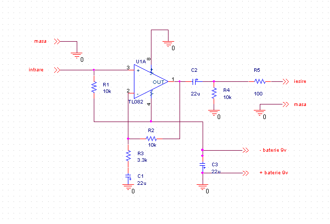

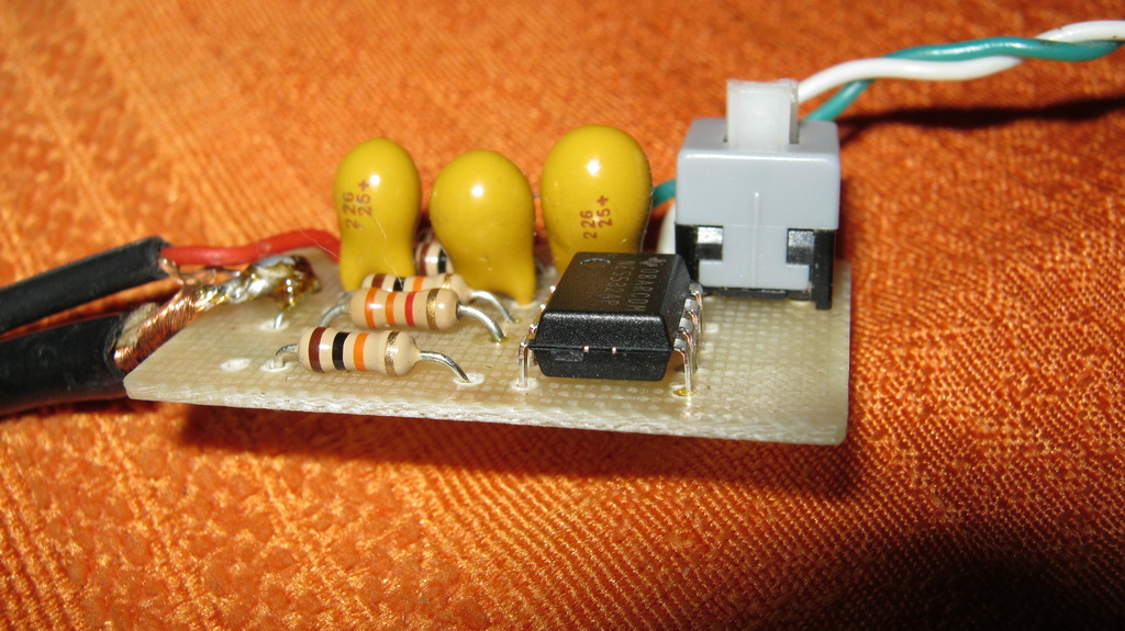

I want to achieve calibrated SPL measurements with ARTA, ampedance and T/S parameters with LIMP.
With Linkwitz mod http://www.linkwitzlab.com/images/graphics/microph1.gif and schematic System Test, i have made one simplified schematic, based on direct coupling and one 9v battery, because voltage on 10k input res is 4-4.5v, half of supply. Main advantages: simplified, one battery, peak output voltage not dangerous for sound cards.
