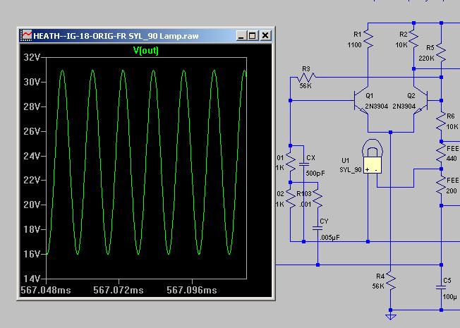

In the absence of a lamp model anywhere on the net that I could find I made one.
The lamp models the VI behavior of the SYL-90 lamp used in the Heath IG-18 models.
The model emulates the lamp converting the VI curve to resistance.
A resistors behavior is modified to follow the resistance curve of the SLY-90 as a function of the voltage across the resistor, AKA lamp.
Dick provided the VI data from his IG-18 lamp.
Unzip the file and install the .sub and .sym files in the LT spice library sub and sym file folders.
Open the .sub file in LT spice to view the sub circuit.
If anyone is interested in how this was done then I will document the procedure.
  • HEATH--IG-18-ORIG-FR SYL_90 Lamp.zip

It seems that the lamp requires DC bias in order to provide a stable operating point. Heath provided this through the DC offset via R5. Removing R5 in the simulation above with the lamp shows the issue. Wondering if there is a better lamp, probably better to just move to FET control as in the 239A.
I have found that various improvements often result in either HF oscillation, or squegging (motorboating) and it seems that the DC bias on the lamp helps to avoid the LF issue. I don't have a lot of experience using lamps in oscillator circuits but it seems that there are conflicting requirements. First, the lamp is required to maintain a gain of one around the loop in order to support oscillation. A short thermal time constant is required in order for it to reach thermal equilibrium in a reasonable amount of time. However, at LF it is possible for the thermal time constant to be so small that the temp varies between the peaks and zero crossings of the waveform leading to increased distortion. The resistance should very slowly adjust to maintain the gain of one as the amp gain changes due to variations in temp and Vcc over time but not (or minimally) over a single period of oscillation. This is why 4 bulbs are used for low distortion at LF as can be seen in Figure 40 of LT's AN43 and one bulb for mid and HF:
www.linear.com/docs/4134
I've not seen a detailed analysis of how the bulb should be biased for proper control in a low distortion oscillator. One reference suggested that it should just dimly glow. This makes sense since if the bulb runs hot then, with the large temperature differential to ambient, it will tend to cool much more at LF during the zero crossings.
I'd like to see a detailed analysis of the lamp biasing. It is non-linear and therefore not easy to solve.

Thanks to a little prodding from a non-working GR 1562-A SLM calibrator, I needed to think about lamp characteristics more concretely. David did a nice job on the curve plotting for the 90MB, and I was led to think about renormalizing the curves.
My little page on lamps generalizes to basically every incandescent lamp and will help (I hope) folks to understand where in it's VI curve a lamp should best be used in an oscillator -- and it is not at the point where it is glowing, dimly or not. See here:
Lamps for stabilizing oscillators
