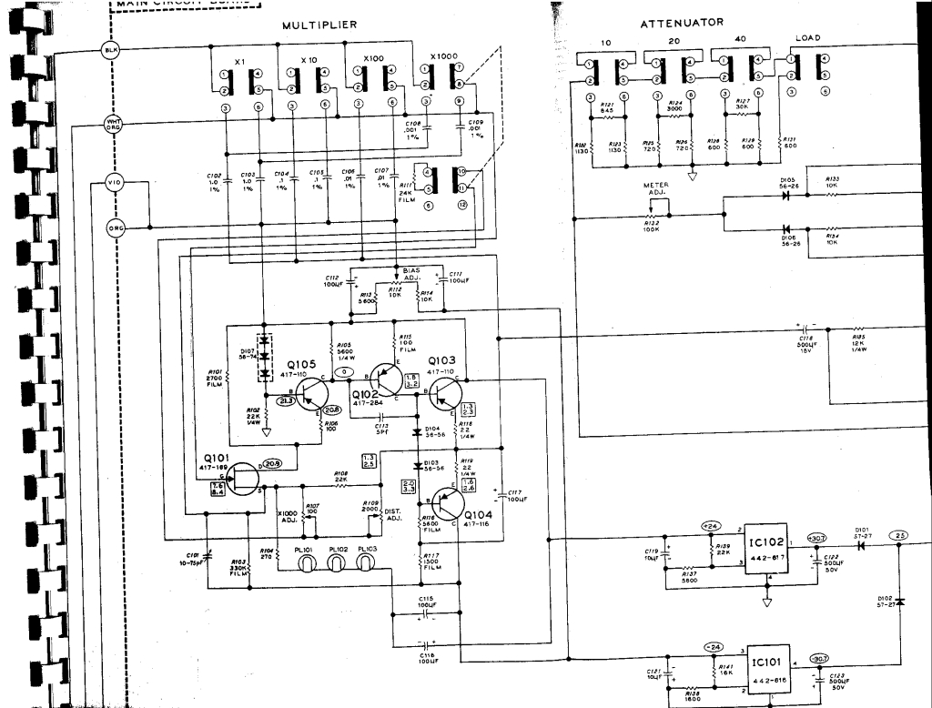

Here's a partial of the IG-1272's schematic, showing the important bits:
Q101: MPF105
Q102= SM62186
Q103, Q105= S2090
Q104= S2091
Q101: MPF105
Q102= SM62186
Q103, Q105= S2090
Q104= S2091
I see one possible modification to the IG-1272: the output level is also the power switch, meaning the AC line is very close to the signal line with possible noise and 60 Hz pickup.
@ Damon Hill -- without seeing the bridge configuration -- I'm guessing here on much of the detail -- I think that, given the equal capacitor values in the multiplier switches, this is a Wien Bridge, in which case the resistors of the bridge arms in the frequency switches have equal values as well. The JFET is the input transistor and is in cascode with Q105 for higher gain and high input Z. The Wien bridge config needs a very high input Z at the amp input due to the large resistors needed for low frequencies.
The three lamps are the only AGC. What I did in the IG-18 may equally well benefit this unit -- raise the emitter resistance of Q102 to 1k and the collector load of Q105 to 10k or 20k, then play with the feedback control. The bootstrapping of Q104 with the 100u cap from the output gives higher output voltage swing, but I think I would give up some output level and use a constant current source, either FET or transistor, as the collector load for Q102, replacing R177 and 178. The 22 ohm emitter resistors for the output devices are a little large for a two-diode bias scheme -- there's a risk of crossover distortion -- might be good to reduce those to 15 ohms each. I'm really confused about why they returned the lamp string via two capacitors to the two supplies, rather than via capacitors to ground -- but returning to the supplies ensures that the caps always have the correct polarity bias; but I can see problems from noise from the supplies getting back into the AGC loop. Better, I think to make a non-polar cap out of 470uF/35V units back to back, and run that to ground.

No meter buffer, a little detail they left out. I'll build a couple and try them out.
