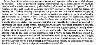

The blowtortch method is too severe and can re-vaporize the getter, depositing on the other elements rendering the tube inoperable. Placing a glass over the tube while under operation makes for a 'mini oven' to help the getter become warm and more active.
Here is an article on getter materials from Electronics magazine, Oct. 1950 (thank you CHRS Library). Useful info on all matters regarding getters.

I see, thank you. I am not a chemist, but from the paper above, would the outgassing during firing of the getter material be dependent on what type of baruim getter alloy is used (Alba, FeBa, NiBa or CuBa)?
