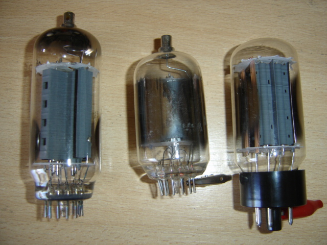

To heat the rather large getters in a 13E1 will require around 500W of power input to the inverter. It is not very efficient but it's simplicity is a good thing as it doesn't need a phase locked loop or other means of feedback to keep it on song.
I'm leaving it for this evening as I have burned my fingers, destroyed 12 FET's and not managed to upload any photos.
I now know why I gave up on this simple induction heater. It is too simple and has way to many compromises. My tank circuit seems pretty good though.
So, I can easily heat the getters in a smaller valve even up to the size of an 25W type. I don't have any that are worn out enough to measure a difference one way or the other.
I really don't think it will be possible to measure a difference in a small signal type. It may even measure worse due to depositing getter on the mica.

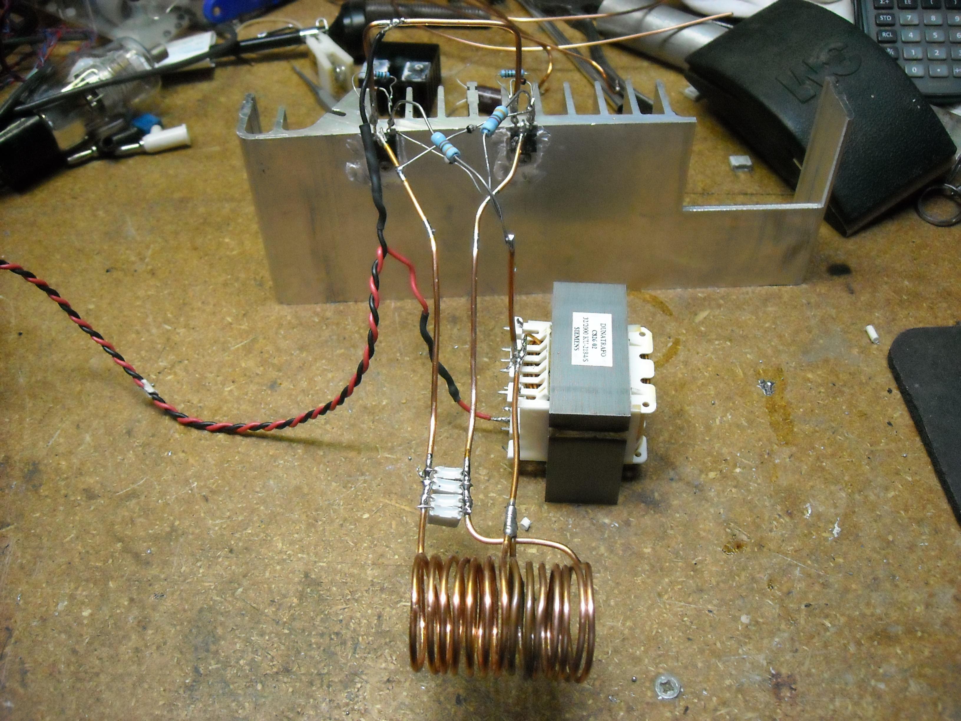

Well, so far I've managed to blow up four FETs and my 12A 13.8V power supply.
I would strongly recommend modifying the basic oscillator schematic shown in post #6. Each FET needs a 15V small zener directly from gate to source, and preferably a stopper resistor (eg. 1-10k) between gate to the driving resistor (R1,R2) and cross-coupled zener (D1,D2). That should stop your FETs from failing.
Your power supply should be decoupled from the oscillator - you appear to be using a regulated power supply (rather than a basic bridge rectifier and large filter cap), which may be going in and out of regulation.
There may be some advantage in decoupling the two 15V supplies to that schematic - so that they each have a separate filter capacitor that feeds independently direct to the source star point.
Your RFC appears to be a mains frequency choke, who's shunt capacitance may likely bypass the oscillator frequency, rather than impede it. Perhaps try and add a high frequency choke in series with the low frequency choke - see zyt's photo.
As discussed, your resonant caps appear to be metalised poly type. As well as quality npo ceramic, you may be able to source silver mica of suitable capacitance, although most are likely to be higher voltage and hence physically large (and costly). NPO ceramic smts can be made up from multiple parallel lower values if that helps - perhaps a touch of glue between each part to sandwich many together and then solder ends.
Yes, I use two power supplies, one 18V (1A max) low power regulated DC for the bias only, and another 20-30V DC not regulated (5A max) for the heating power. start bias voltage first, then the heating voltage.
yes, the RCF (L2) is important, it stops the common mod oscillation. it should made on a iron powder core, I use a T50-2 toroidal --> (ring in human language).
and the two diodes should be ultra fast type.
and the coil, less turns make it work better for lower heating voltage.
I've got it running today, but it won't heat anything but the induction coil gets hot after 20 seconds.
I have protection diodes from source to gate. the inductor (L2) came from a switching power supply. I"ll wind a toroid to add in addition to it.
I'll hit the local electronics supply store this morning for better caps if they have any.
It is now oscillating at 200KHz with the voltage measured on one drive side of the induction coil peaking at 65V. Current draw is 5Amperes from a 21V supply.
I use basically this circuit:
https://markobakula.wordpress.com/power-electronics/500w-royer-induction-heater/
I use a separate regulated supply for the gates and a 24V 750VA control panel transformer with a 35A bridge and 40,000uf of filter capacitors.
You may notice that this circuit uses two chokes to decouple the oscillator from the supply. This allows a work coil without a centre tap.
I'm using 11X .47uf 250V AC rated MKP caps in my tank circuit. They are all soldered to two copper plates that also have the FETs bolted directly to them. Two heatsinks and some ally bars are the bolted to the copper plates. The main source of heat in my lash up is the work coil, I have some small diameter copper tubing that I intend to use to make a water cooled work coil.
