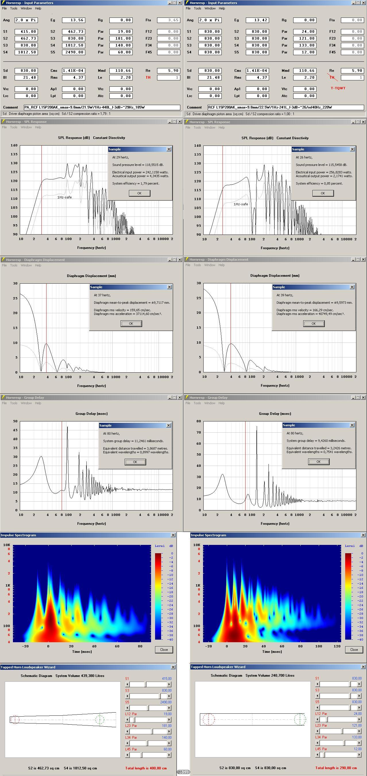

Hi, i have my old ( but new 🙂 ) RCF L15P200AK ( im italiannnn ).
Is a 4ohm 15" pro woofer, whit 800 wrms ( but in my car was powered whit 1000 w rms reflex enclosure without problem ).
Now i want to make an enclosure for use in pubs or indoor ( i've a metal band ) or for home cinema use ( lol 😀 ).
im thinking about a 4th or 6th order box, but qts is 0.35: low for 4th and high for 6th. i havent try 4th or 6th order box on my project, but i must optimize linearity and efficiency..
Some ideas and knowledge about?

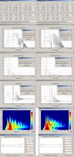

Hi Mordor,
This driver of yours is IMO very good for both home or PA use as using a very favorable compression ratio:
This property makes it possible to lightly damp ~half of the airways for a TH that would move possible SQ into the HiFI area realm without loosing low end efficiency and sounding like an T_TQWT.
b🙂

The RCF L15P200AK will work in Cubo 15 and take 800 - 1000 Wrms mechanically (with a ~40 Hz high pass). Cubo 15 will work well with PA drivers intended for reflex use but you will have to find something else for HT use 😉
Regards Johan
That driver would make a great home theater subwoofer in a tapped horn design.
Here is a design for a similar Electro-voice driver, it should be able to hit 130dB in the corner of your room, and is useable to 20hz.
I meant Cubo 15 isn't suited for HT (it's meant for 40 Hz and up), however the driver is. I'll second djk, that the driver itself in a tapped horn could be used as a neet 20 -25 Hz and up sub (even in 2,0 pi).
Best regards Johan
