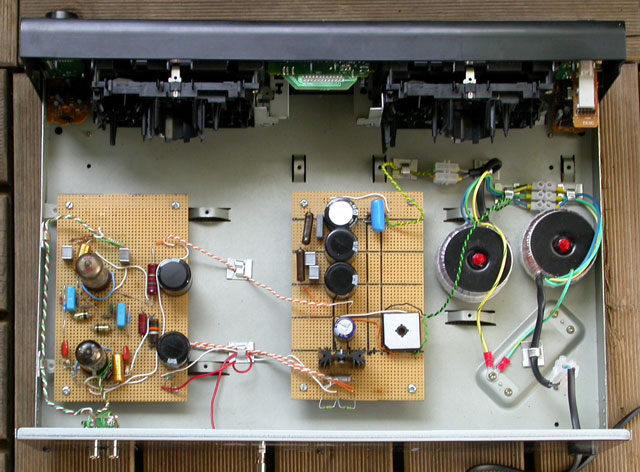

I have build different prototypes of this phonostage. One of it with LED-biasing. (Morgan Jones had done studies on LED-Biasing and he was so friendly to send me his favourite LED from Great Britain for testing)
Here is a picture of one example I have built with very nice vintage KENRAD 6SL7 Tubes.
Best regards, Jo
Best regards, Jo
