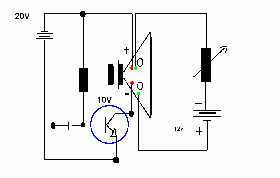

I have one stupid idea (non efficient) but interesting, to build a more perfect
amplifier... do you want to listen my delirium?
Someone that may try such strange thing my be Nelson Pass..unfortunatelly he is busy to read my foolishes.
regards,
Carlos

hehehe... the idea is to use a double coil woofer
and let pass 10 watts inside.... the transistor colector to emitter current into one of those coils..so, audio will be there too... in stand by, 10 volts and 1 ampere, the other 10 volts will be into the transistor....so, the coil will be the transistor load... a class A amplifier, having 1 ampere of current, 20 volts into the supply..the transistor colector with 10 volts (or fet)...them.... 10 watts into the speaker (loading coil) and 10 watts into the transistor.
This will be good to audio transference, as not condenser will be used, and no transformer will be used.
BUT..doing that, the speaker cone will move forward or backwards.
To compensate, you gonna spend more 10 watts, sending 1 ampere and 10 volts (other supply) to the second coil, forcing the speaker to return to the resting place.
I have never made that... as i have no a double coil speaker!
regards,
Carlos

flipping heck Carlos, that's a huge power to dump into the coil, the full Class A bias current. I don't know that we could make a coil light and small enough for good sound which can also handle that power. The coil has few options to dissipate it's heat because it can't touch a heat sink, it has to be free to move according the magnetic field. I'm not a speaker coil expert - perhaps I don't understand ??

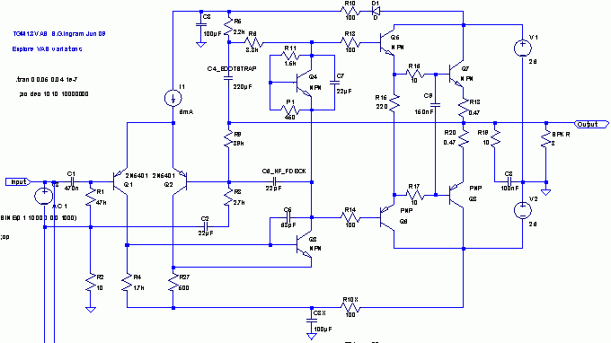

Returning to Topic...
I explored a quasi-differential VAS, seemed like a simple and innocent change based on something I saw in D.Self.
I did the sims on TGM1 but same general topology. I saw that harmonics are worse, especially H3. Why no benefit ? - perhaps my implementation is too simple, typical newbie error ?
Attached is the schematic, simply the emitter of the VAS is connected to collector from the inverting input device and held off the -ve rail with a resistor. Plenty of current through the LTP. I cut off from the circuit to keep it small but in the space below is a duplicate with the regular TGM1 so that I can do a simple AB comparison.

You seem to be going the route of the folded cascode. Try locking the base of the VAS device to a set voltage point (zener/green LED -resistor + decoupling cap) , like 2-4v above negative rail.
Use Just one device of the LPT to drive it.
A folded cascode bootstrapped amp , I'll have to try it.

Ah, but will adding another active device take it away from being the Back To The Future amp ? However, from a purely selfish view I have been struggling to incorporate the Lender VAS into TGM1 so I am grateful for some direction so that I can use it over there too 🙂
Why is it called a 'folded cascode' ?
Does the simple LTP have enough current drive for this VAS ?
Would we consider a change in the diff input pair to JFET - they have the benefit of higher input impedance, I thought also that they are able to handle a wider input voltage swing ??

ostripper said:Try locking the base of the VAS device to a set voltage point (zener/green LED -resistor + decoupling cap) , like 2-4v above negative rail.
OS
Is there some benefit in terms of PSRR if the base is simply connected to a resistive divider between the power rails, so that noise on the supply is fed back ? (I saw something like this in a common grid tube amp on the internet tonight)
EDIT: no, you already thought of this, we want to stop noise from the -ve rail. Referencing off -ve rail is the right way. Especially with bootstrap.

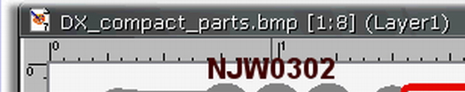

Almost the same board.. alike mine one
Because the topologie, as you see, the only logical solution.
I would like to ask you to remove the Dx from your amplifier... Dx brand name is not authorized to use.... use Dx style.... Compact Dx style..but not something that connects your creative design with my amplifier.
Or at least, if you want to have this connection, do not publish, because the Dx is alike a DIY trade mark.... it is sold, usually, in this forum by ZERO dollares... payment is a smile and the builder happyness...put your name, or you brand in the first position.... then, if you want, say is Dx Style, or Dx inspired or something you like....i would be more happy without that mention... this way, forum will have more options into the forum, even beeing boostrapped topologie that uses to sound alike.
In other words, if you need some connections with Dx, then put it into a secondary position, to be very clear i am not responsable from this one..that has another owner, another designer, another responsable.
Not Dx by Ostripper, but Ostripper Dx Style.. is more rational i think.
