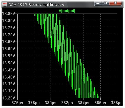

By bigun - Let's see if this works... attaching the spice file
It not only works , but it works while it oscillates (attached). That was with the "slower" MJL21193/4. A perfect sub for the RCA is the lowly 2n3055/2955 , this worked perfectly. In fact, with bc556 for LTP, BD's for VAS/drivers , and the slow OPS ... it worked perfectly - nearly the same as mine with the fast devices.
This confirms that the topology is tailored to the devices, not the other way around. As it is , this EXACT circuit will not run fast OP
devices. Conversely , the new one will run slow or fast drivers.
with a 4 ohm load , I could see the OP clip before the rails (VI limiter)
at about 3 A. 😎

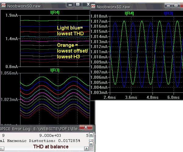

"Uncle charlie" did not lie (DX = .03%), I did the RCA , the DX , and the "back to the future". By "did" I mean simulate with the .step directive in EVERY way to find the best operating points. By accident , I noticed what effect the small cap (100nf)in parallel with the bootstrap on the DX has at HF. IT could be another "secret". 😱
Starting with the RCA (.08-.1) then the DX (.03-.04) and finally the new one, THD dropped with each generation. This has to be the parts , as all the other aspects of operation (open loop gain , phase margin) were nearly the same. As this is my first real in-depth investigation of the "good ol' amp" topology , I was surprised at sub .02% readings.
The current source , while some say it may detract from the sound, improves things. 1. PSRR , a no brainer. 2. keeps the differential balanced independent of supply voltage (25 -45v),and 3. everything remained the same regardless of output level/frequency.
Balance seems to be the key to good sound, H3 ,offset and total THD dropped , but H2 increased slightly at the "sweetspot" (attached - orange plot is the "sweetspot") With a 4R load ,a larger bootstrap capacitor (100u)makes for better performance as well.
What was amazing is that the RCA could simulate , clip and oscillate simultaniously without a timestep error in LT (the bootstrap will not allow RF oscillation? ) .
The only feature that will be "handy" is a trimmable CCS to balance the LTP , otherwise this should sound as good as the "supersym". Both these and the sym's will be in the same amp , so I can swap front and rears with the PC for a good A/B listening test. Time to finish the boards.. 🙂

ostripper said:"Uncle charlie" did not lie (DX = .03%), I did the RCA , the DX , and the "back to the future". By "did" I mean simulate with the .step directive in EVERY way to find the best operating points. OS
That's a nice piece of sim work. I haven't tried the .step before, usually doing it manually. The TGM uses a larger bootstrap than DX, more like 220uF but 100uF is more common in this position.
I think the comments about current sources not sounding nice applies to current mirrors - they behave differently than the simple current source.
