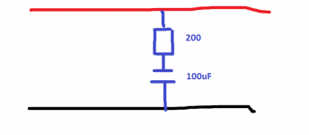

Adding a a 200r resistor and 100uf cap to the op amp rails is improving the sound quality of the amp, no problem with that, anyway to improve sound quality is good.
Im wondering if it might be exposing a problem with the supply.
The supply is 2X15V trafo (measures 16V with amp playing) to +/-15V DC using LM317/337 regulators, 8800uf per rail with lots of low value bypass PP caps. With a cheap multimeter its measuring over 20V DC before the regulators, if there is ripple not sure if thats the min, max or average voltage.
ripple doesnt seem that likely anyway.
On an old post DF96 mentioned bypass cap resonance and how a RC circuit can filter this resonance, could that be the explanation here?
The choice of bypass caps was tested thoroughly, it was always better than without them but if it is introducing resonance does using an RC filter have any consequences?

200R in series with an electrolytic doesn't sound like it would be all that effective tbh.
The regulator itself deals with short term transient changes in load and normally adding a large capacitance to the regulator output would totally negate that... although 200 ohms series R would not do anything imo, either good or bad.
Normally a small cap (say in the 1uF to 10uF range) might be used together with a series resistor of around a couple of ohms (a small 0.25watt carbon or metal film resistor).

I think I misinterpreted the original question as I was thinking he meant this (image) as I latched onto the bit about resonance and assumed given that 8800uF was already present that something to address possible resonance issues was being called for.
So a cap in series with a low value resistor would have been one possible solution, just not 200 ohm :)

There are so many ways in which the OP's post can be interpreted we really need a simple diagram to understand it.
Say, for a start, for low currents, that 8800uF: presumably 4 x 2200uF caps - just adding some 1ohm between the caps could add immense filtering- but where & how are these caps used .. before or after the regulator? And why in either case?
Over to you, Laserscrape; help us help you.

Ok to clarify some things:
the resistor is in series with supply and the cap goes to ground, so a low pass filter.
it is also feeding transistors in class A headphone amp, dont have an exact schematic but this can give a good idea if you ignore the power supply part: https://i.imgur.com/2g5Hoeg.png
its not expectation bias because I expected the amp to sound better without this filter once it was using a regulated supply, I assumed it was there for the basic original power supply that you can see in the schematic.
the caps are before the regulators, they are the filter caps after the rectifier.
Ill try adding the filter before the regulator instead
