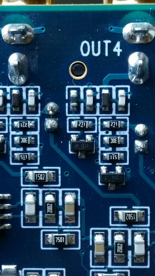

Well the components around the output of the minidsp are all tiny surface mount. Black is usually resistor right?
Seems to be one in series directly before output.
No actual markings or identification to get a brand i can see. I guess i will finish my build, add a 90 nf or thereabouts capacitor across amp input, and measure response. Ive got a minidsp and measurement microphone after all 🙂
The resistors are the ones below, with white markings. Looks like there is a LCLC filter before the output. Plain black is usually inductor or ferrite bead.
But before that, you have two 270R resistors in serie with the output, with a muting transistor in between. That's your 540R output impedance, plus some resistance in the inductors or ferrite afterwards.

can you tell of the 4 digit resistors are 2 sig fig plus a multiplier (number of zeros)?

can you tell if the 3 digit resistors are 2 sig fig plus a multiplier (number of zeros)?
or as written with 3 sig fig?
Are the 4 digit resistors 3 sig fig plus a multilpier?
Why does it matter ? From the output pin of the opamp, you've got only those two "271" resistors in serie with the output. Whatever the marking code, the value is the same.
There's a "30c" resistor to gnd after the coupling cap, that's 20k, but it doesn't affect the output impedance. The "511" is clearly tied to the muting transistors, not important either.
The "1502" and "2002" are in the feedback loop of the opamp and aren't relevant either.
