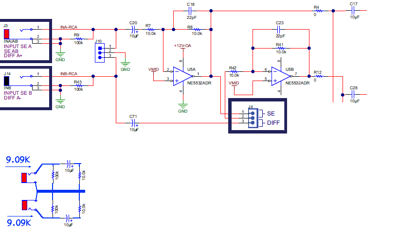

the amp is the tpa3255EVM here:
TPA3255EVM TPA3255 315W Stereo / 600W Mono Ultra-HD Analog-In Audio Class-D Module | TI.com
but i cannot find the input impedance listed anywhere, and methods to measure it seem complex.
then, assuming i have this information, what to do with it? how does it affect the resistor value i choose.
i cant help thinking a 4.7k resistor will cut down my signal rather a lot? this means one amp channel will see a noticeably quieter signal overall?

....i cannot find the input impedance listed anywhere
And the schematic is a mess.
It is actually VERY well defined, once you sort it out. There's two inputs, for plain unbalanced or for balanced, both on RCA jacks. Each one is 9.09K.
Yes, 4.7K series resistor will be a 3.6dB loss, very significant.
The other end is: what can your preamp/DAC drive? Some strain on anything under a few K, others will drive 600 Ohms or even 100 Ohms. If you can drive say 470 Ohms, then loss is a tolerable 1dB.

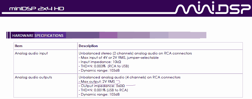

so, source is a minidsp 2x4 HD, which apparently outputs 0.9v rms at clipping.
amp is the 3255 evm, which apparently has a 9.09k input impedance, and needs a 2v p2p input.
amp is the 3255 evm, which apparently has a 9.09k input impedance, and needs a 2v rms input.

Well that is good news! Really good news. I was advised of the 0.9v thing in another thread, but possibly i forgot to specify the HD version. The old one was 0.9v.
So now i just need to specify an rc filter that works with the minidsp and the amp with the lowest attenuation possible. Hopefully i wont need to go active.
