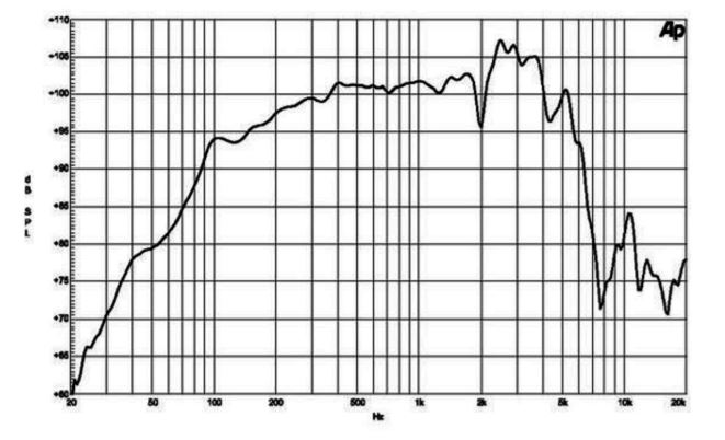

Integrating the 12PE32 with a subwoofer is going to be near impossible..
This is only true if the "sub" woofer qts isn't matching (or near) the mid woofers qts.
camplo, same frequency or not (not sure where you're going with this).
Sometimes you can EQ a low Q, but if this is a horn driver then the excursion may have been traded off as well.
I believe Joseph was referring to the sonic qualities of a low qts driver (12pe32) vs that of what he'd consider a "subwoofer" which in his eyes, have a high(er) q.

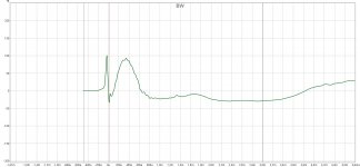

As for the rising sensitivity...its a non issue...filters

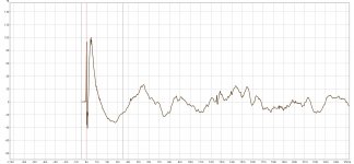

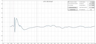

I think these specifications are linked. The filter changes the "sonic qualities" (group delay), and brings back the bass level which wants the excursion which was in this driver reduced with the low Q and high fs, and traded for efficiency.. setting a new level for said bass.

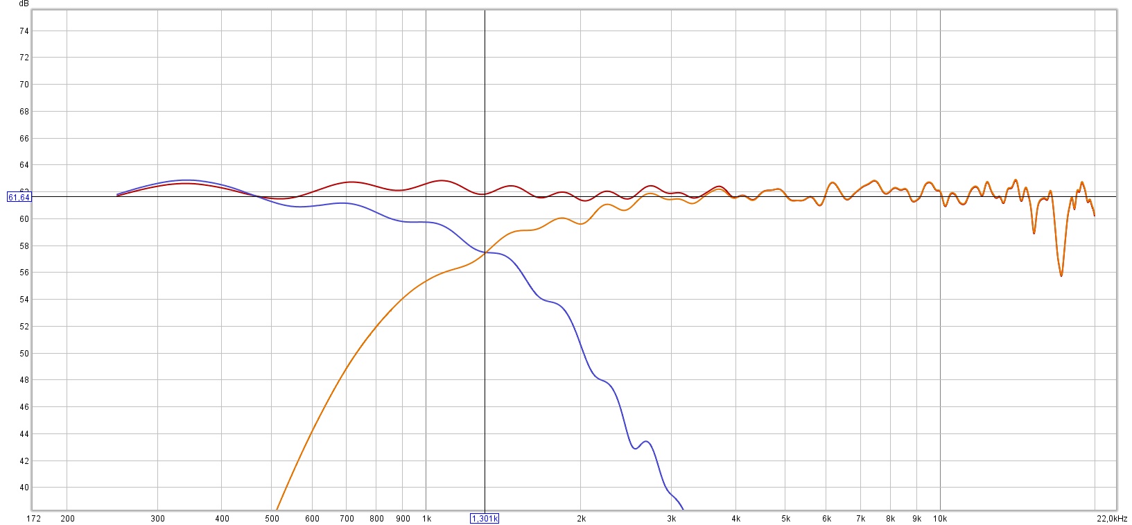

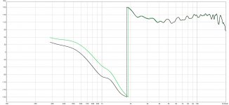

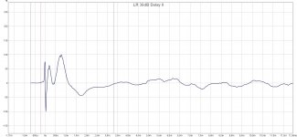

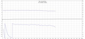

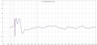

But this means that the table in that article is wrong labeled. They switched HP and LP factors.It's not an overlap but a spread. The CD would have the 1272hz setting and the woofer the 786hz setting. (these are approximate as well).

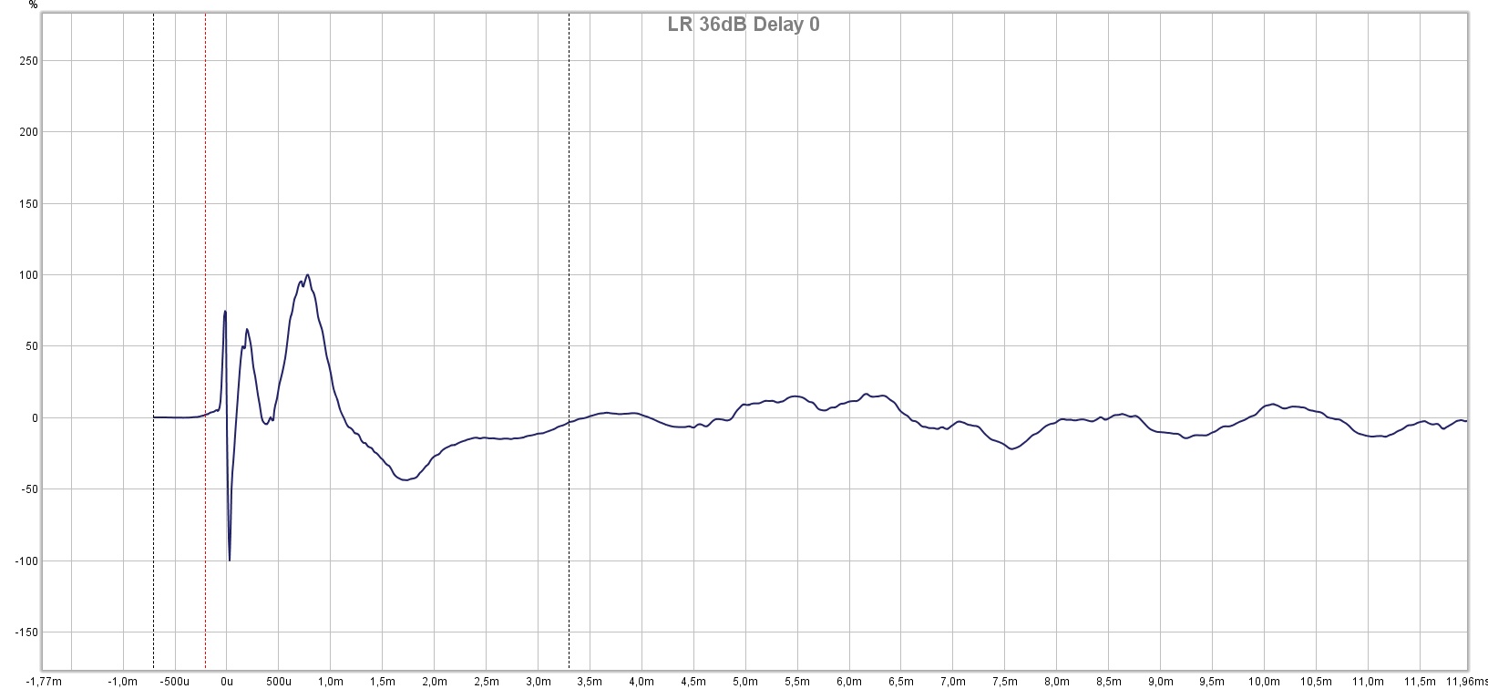

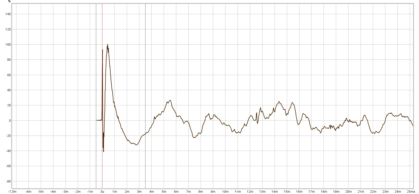

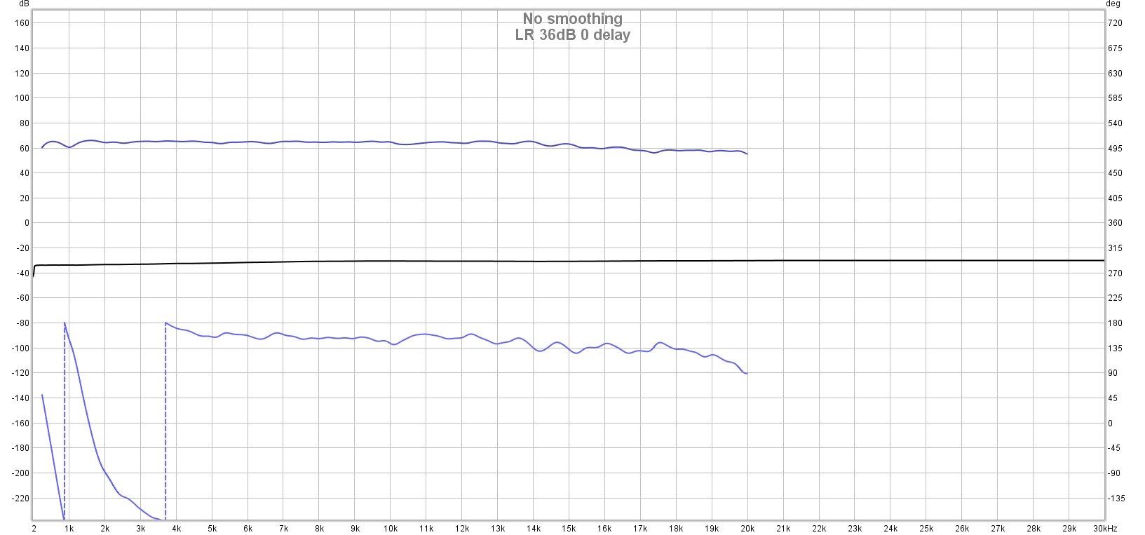

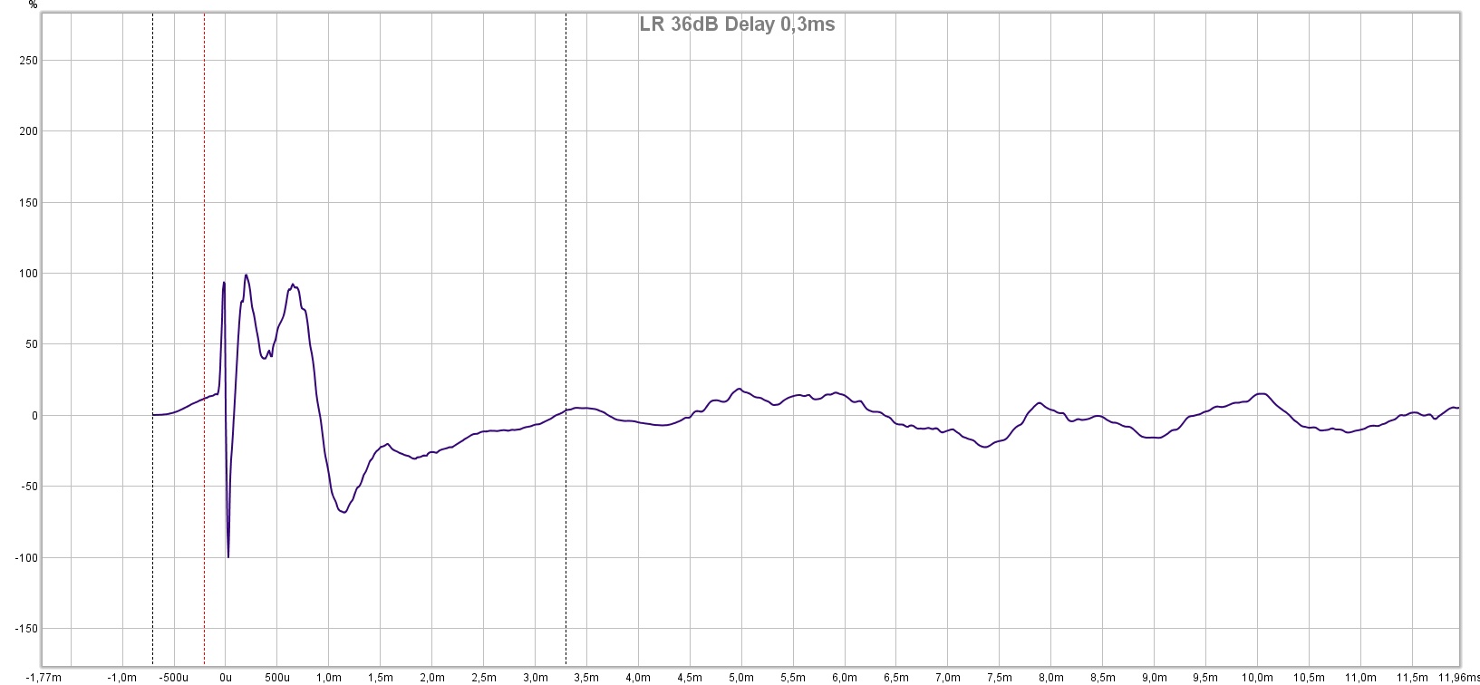

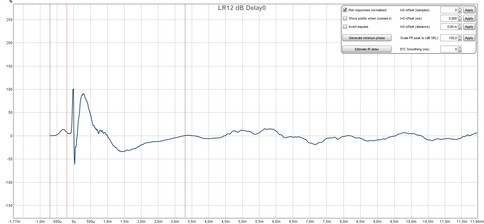

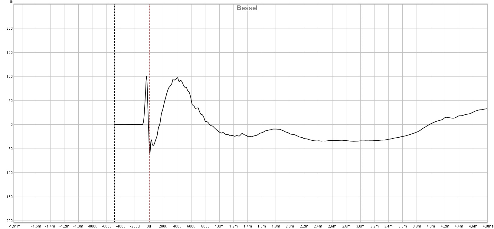

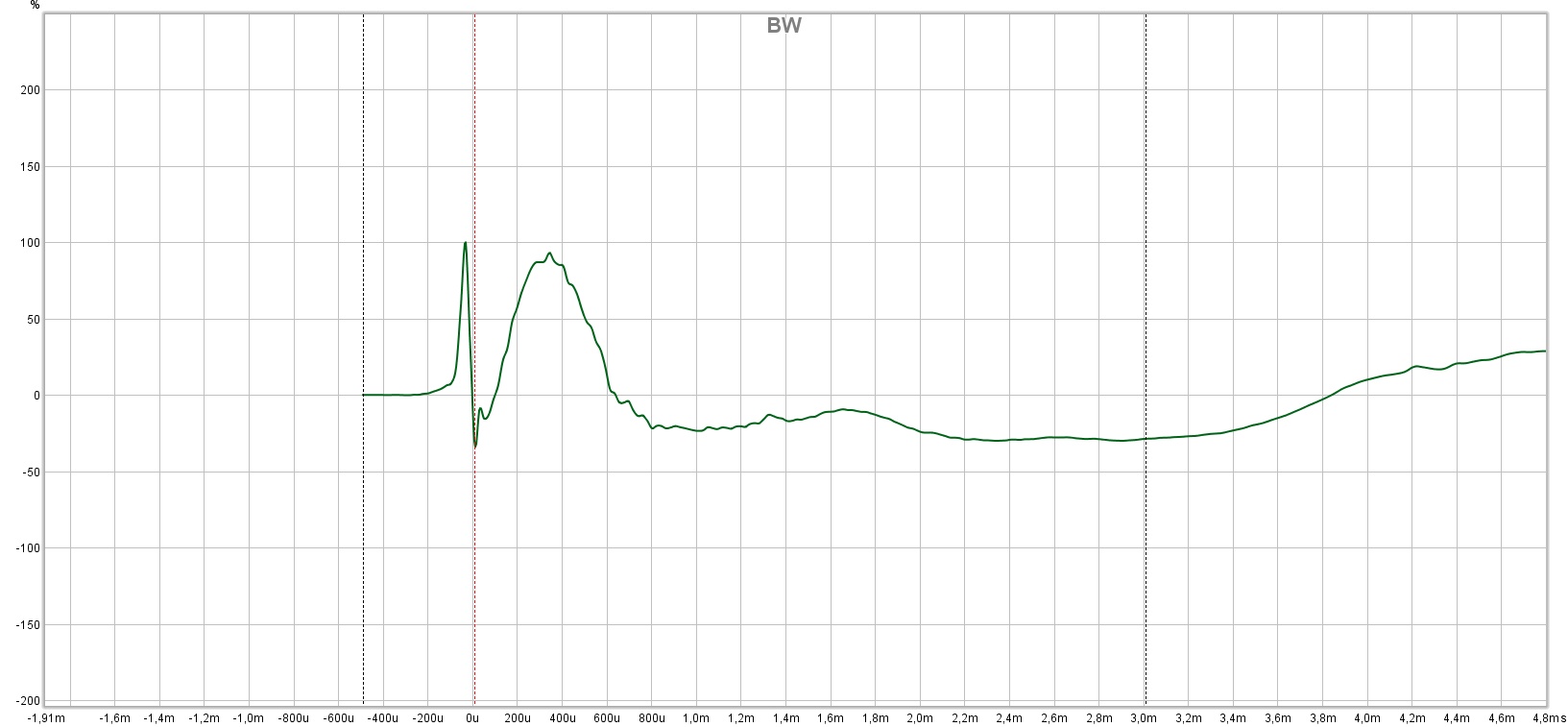

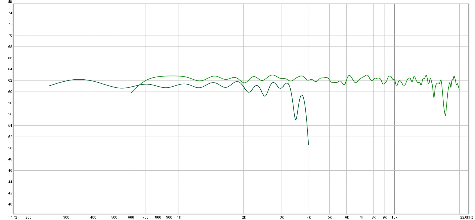

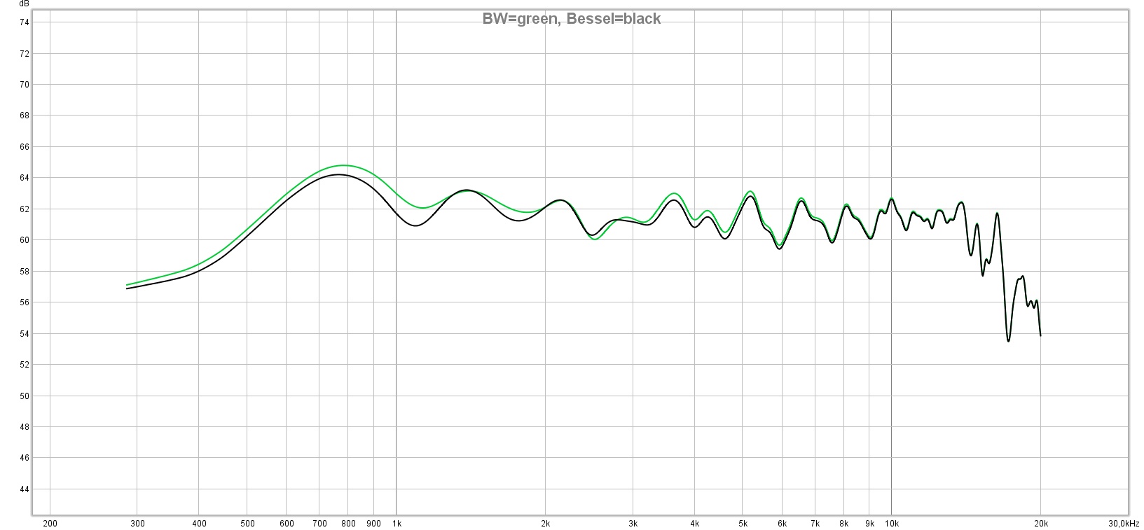

Viper_user, I tried LR (and Butterworth as well) but had best measurements with Bessel. Maybe some further testing is needed. But in my room it doesn't make sense. I need a hall to make better measurements or a place for ground plane measurements. But at the moment I'm to lazy for this.
The integration of the 12PE32 is okay imo. I EQed the subs from scratch. I have a HP at 120Hz in the 12PE32 just to lower the excursion for better midrange. The front subs are crossed at 120Hz with Bessel filters. The back subs are crossed at 60Hz and delayed because of the physical distance. So most of the kick bass comes from the front subs but it sounds okay in my ears. The response is flat down to 20-30Hz.
