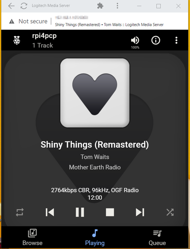

What I'd really like to hear in my hifi system would be radios broadcasting in HiRes 96kHz / 24 bit Lossless FLAC stream,like this one:
Mother Earth Radio - High resolution music tuned to the Faslak's Frequency ~429hz
but for now it's complicated and all systems I've tried fail, but that's another story!
You should be able to add internet radio stations to Volumio -
Adding/removing internet radio stations - Help - Volumio
