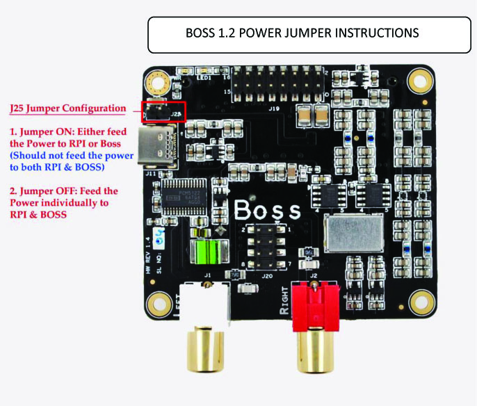

But you have right, the allo boss you linked seems very good. I only have to understand if matches with the remotepi.

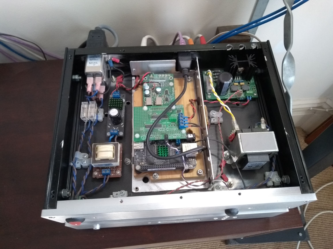

I prefer not, cause I want to keep all the stuff in a new aluminum case I'm going to built (I'll posting some photos too)
Done in the new case! Same answer for the IR sensor!

Okay, this is my turning point question: let's imagine that I purchase the allo boss and replace over the audiophonics board. And of course I will power it separately from RemotePi (or raspberry) with a linear power supply.
So I will have:
1 LPS for allo boss
1 SMPS for RemotePi
1 power supply for the display (let's say the Leicke power supply I own already)
So many power supply and plugs! My intention is to keep all the stuff inside the case and with less plug externally. How can I achieve that?

this is the chinese power supply using at first, maybe it's a cheap solution for the remotepi and allo boss?

Hi there,
As I promise I finally finish my streamer project, with the help of my girlfriend's dad!
Some photos:
We use for the most part of it, recycle things (as the aluminum chassis or the wood top cover)
I'm very happy with the result, superb audio quality!
